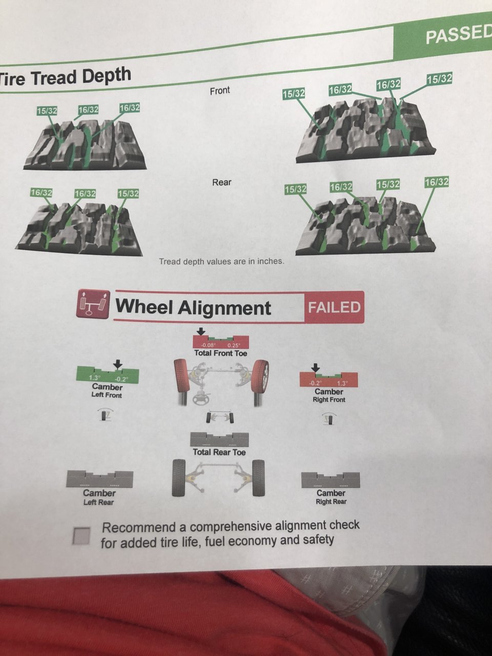

    It’s still pulling to the right not sure why maybe I should just leave it as is. The mechanic left after they aligned it so they said to come back in the morning to have him ride with me.

    This is before they aligned it.
    Possibly a bad tire since it’s still pulling?

    You need to post the alignment specs. That sheet looks like it is from a Hunter Quick Check machine which is less than accurate and doesn't measure caster which is what would cause the pull. It could very well be a tire pull, but knowing the caster would help.

    I’m here again now so I’ll see if I can get a detailed sheet on it.

    If you are there, you might as well ask them to cross rotate the front tires. If the tires are causing the pull, it will either go away (typical if your pull is to the right) or start to pull the opposite way.

    They just came and told me the back is out of alignment pretty bad as well. They said the front was out bad too so kind of strange but they said it’s going to take a while so I’m heading to work and will update once I come back later.

    must be a good dealer to be able to align the rear, if it pulls alittle right like mine did, i swapped the front tires and goes straight as can be.. sometimes its just a tire thing.

    Might be time to run. The rear is not adjustable. If it is pretty bad, then something must be bent. My guess is they probably do not know what they are doing. That is common with dealers and alignments. They don't have dedicated techs and probably not familiar with the equipment.
