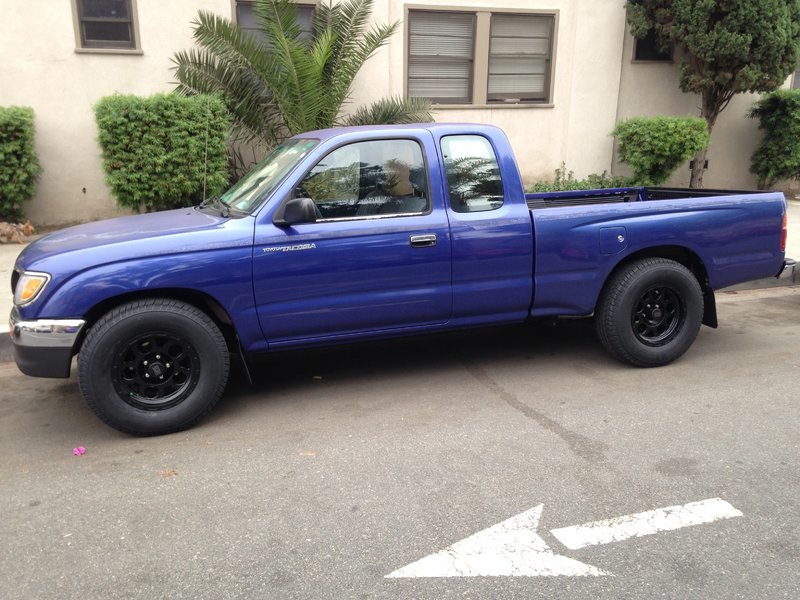

    Just added some KMC 122 Endure wheels, 15x7, and 235/75/15 tires. I am getting a little rubbing on hard turns on the front tires. Just wondering what advice people have for getting rid of that problem.
    Thinking about lifting it an inch or an inch and a half. Would that be enough to clear the tires ? Does anyone have any suggestions on which type of lift would be best. I am not looking to spend more than $500.
    I have also briefly read about people trimming part of the bumper that rubs. What do you use to trim it ? Or do you take it in to a shop ?
