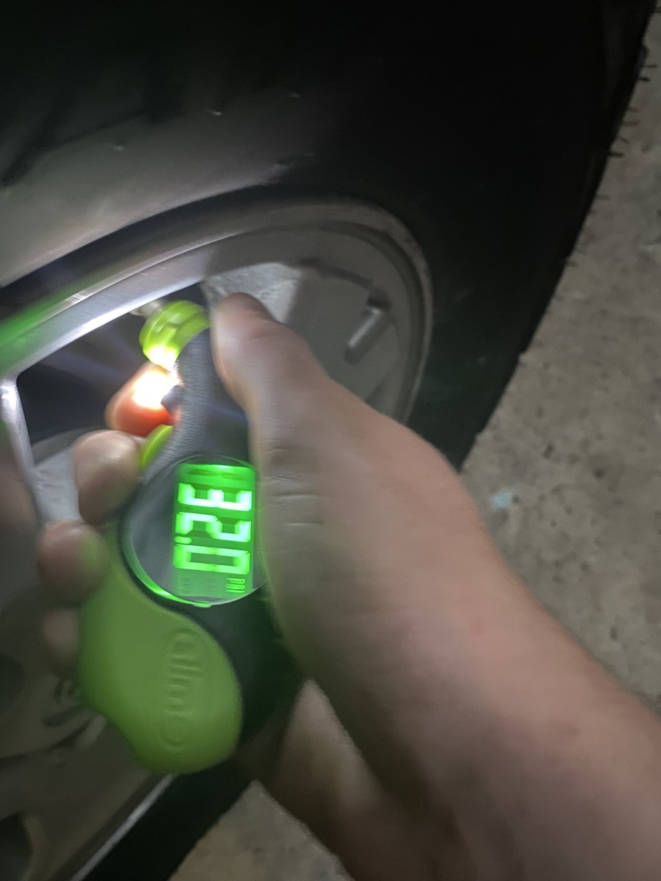

    The light was on from the moment I took it out of the garage, before I even left the lot I went back in and asked about the light. I only lowered it to 40 (and now 32) after...
    Unfortunately did not work... Lessened pressure to 32 or less on each tire and still getting the light.
