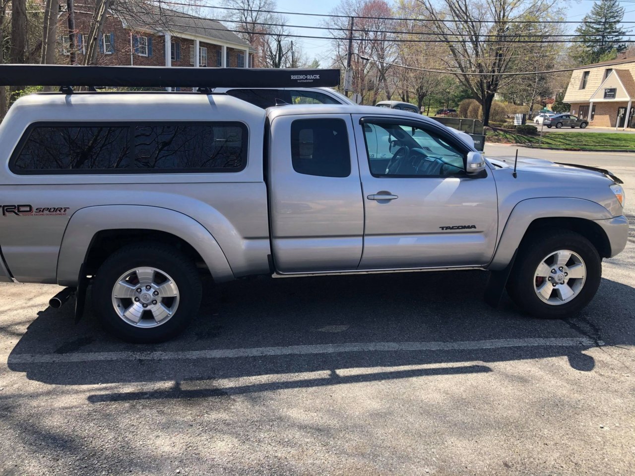

    Greetings, I've recently installed new tires/rims and a pro comp (3") leveling kit to my 2014 tacoma. I love the look of the new tires (265/75-r16) and I had originally purchased the leveling kit to avoid front rub. Turns out after all is said and aligned the rear of the truck sits lower than the front. You can see in my original picture it is clearly raking in the same direction.
    My question is...
    I was told it may take a bit to "settle" ?
    Could it be my cap weight?
    Could it be the decked system (230lbs)
    Should I take out the leveling kit all together?
    Should I put rear spacers to even out?
    Add a leaf springs?
    Does the weight of passengers (200-300lbs) level it
    Will this effect my truck meanwhile? 170592251_354418312640860_7265515487939527093_n.jpg170424497_467641114558880_7403236620296614202_n.jpg

    It won't settle that much, and passenger weight won't help. You will need more in the rear, or less in the front.
    Lots of guys drive around like that on purpose, so it won't hurt anything unless you installed something incorrectly. Post some pics.
    Which kit did you install? Spacer front and block rear? AAL? Post a link.

    It won't level out since ProComp are a spacer lifts. Coil/leaf lifts will settle as the spring compress a bit and the metal fatigues, spacers will not compress...
    With Decked Drawers and a topper, you're running 400-500 lbs of constant bed weight, you need a stiffer leaf pack in the back. Dakar HD, or the Dobbinson Stage 2 would both do well, gonna cost $500-600 for leafs, bushings and u-bolts. You could also run an add a leaf, the Headstrong 3 leaf is ... OK, will give you probably 1-1.5" and cost a lot less ($200).
    Alternatively, you can add a 1" block to the rear leaf pack. It will level the truck but do nothing to offset the fact that you're carrying more weight than OEM leafs are really intended to carry.

    I'm not disagreeing with you, but his before/after pics show he didn't have negative rake before he lifted. Unless he added weight after he lifted, it should be closer to level.
    He has more negative rake than a 3" front spacer/2" rear block would normally give him, even if he was level before he started. I want to see what he installed. Something else is wrong.

    It doesn't look to me like your current setup has a block in the rear. If that Pro-Comp kit comes with a 3" front and 2" spacer it definitely shouldn't look like what we're seeing here.
    My truck came with a 3" spacer lift in front and 1" block in the rear. Despite being labeled as a "leveling" kit the rear was still a tad lower than the front (and this was with NO added weight in the rear). With your added weight and what looks like no rear lift block it's no wonder it's so imbalanced.
