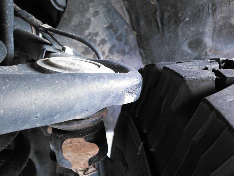

    I went from 265/70-16's Toyo Open Country's up to 265/75-16 BFG AT's, I experienced no rubbing with the Toyo's but the BFG's are rubbing the UCA and LCA, BUT ONLY ON THE DRIVER'S SIDE. I'm also experiencing a gentle rolling vibration from that side, but only intermittently. Also didn't happen before the tire swap. I bought them new from a reputable shop...
    What's going on here? :confused:
    My truck is an '05 DC TRD Offroad, if that matters.
    THANKS!!!!!

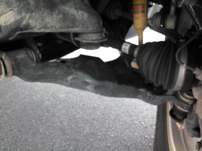

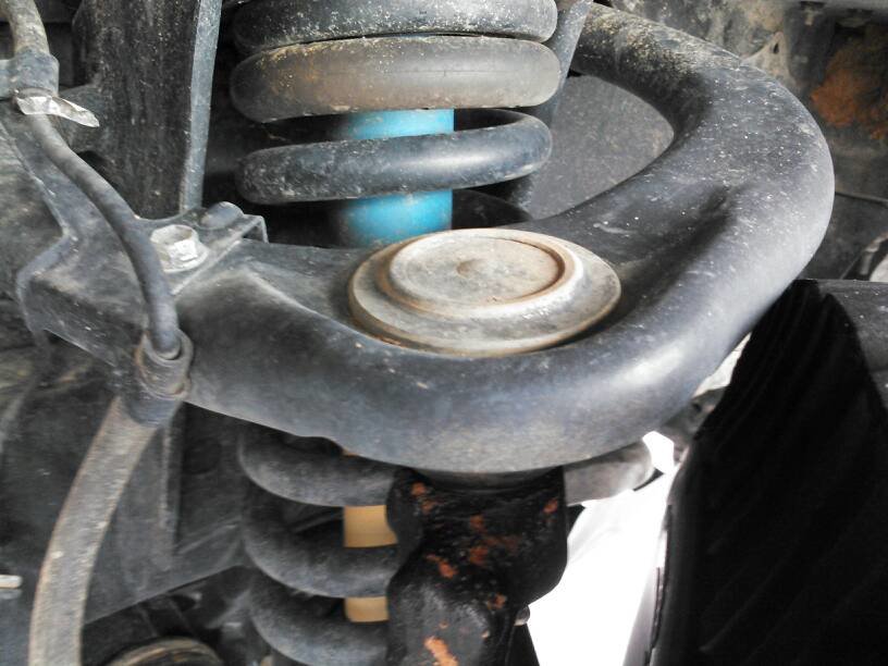

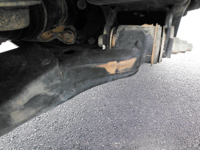

    I snapped these real quick....
    Driver's LCA
    Driver's UCA
    Passengers LCA
    Passengers UCA

    Width is the same. The BFG is an inch taller. Guessing that's causing the rubbing problem.

    Might want to try swapping wheel/tires, left - right, vice-versa. It may be a tire issue. Sometimes there are inherent defects from the factory. Also might be a good idea to double check width with a tape measure on the tread pattern and also from the frame to the WMS and compare left - right.
