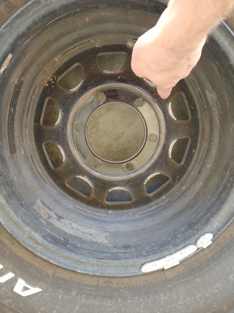

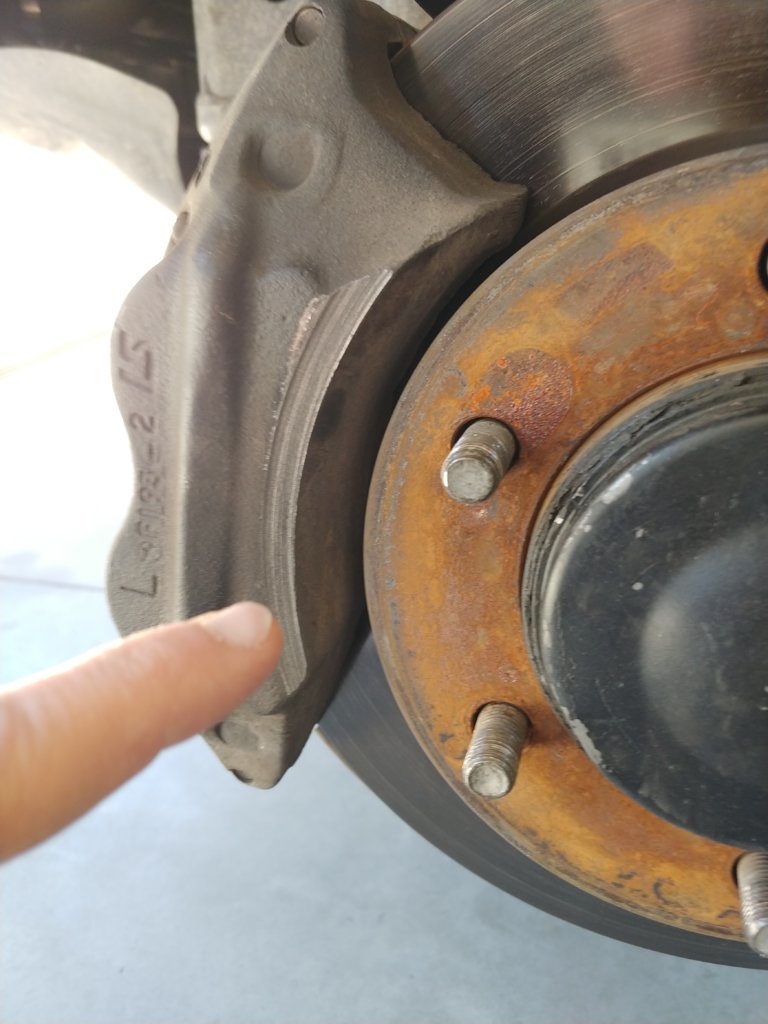

    OP, try to see if your caliper has any signs of rubbing the inner hub face of the wheels. I bought my truck 4 years ago with some no name aftermarket wheels on it. It had the really dangerous style adapter plate spacers fitted as well. I decided to remove the adapter plates and quickly learned why they were on there to begin with:
    I then promptly ordered and fitted Bora hub-centric spacers to rectify the situation safely. I've been wanting to get new rims (to eliminate the need for spacers) since and have passed on the exact rims you have several times because I've read from multiple threads that they have improper backspacing (and would rub the calipers).
