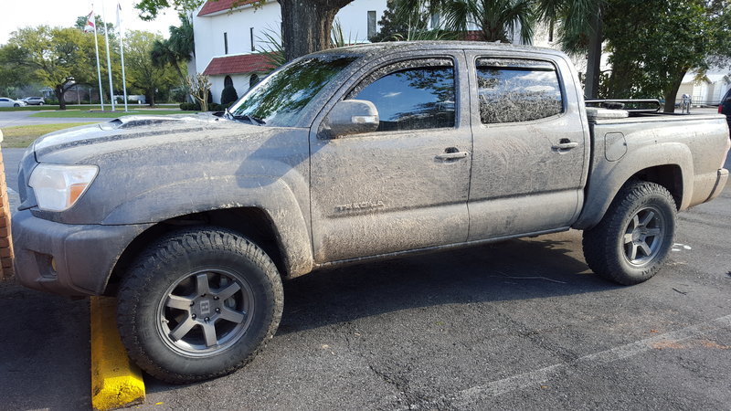

    2003 DCSB TRD OR

    Thanks guys; Those pics look good crashnburn. When you guys say you have no rubbing do you mean no rubbing at all or only no rubbing on level ground? For example, if the suspension is flexed to go over curbs, hills, etc do you get any rubbing?

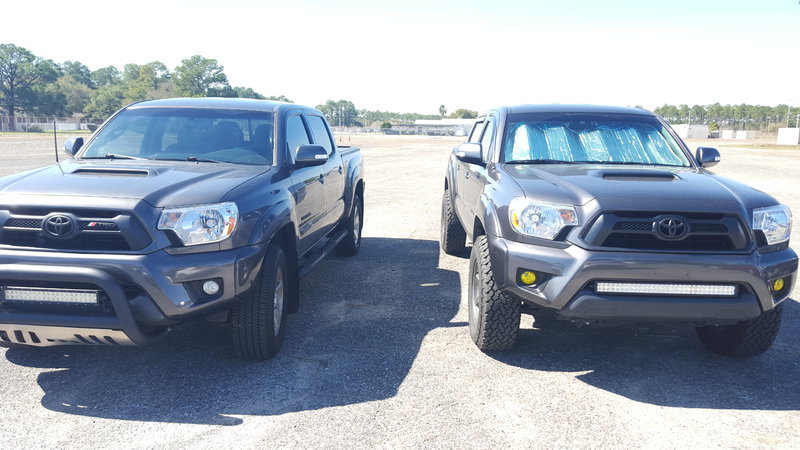

    Here's a couple shots of when I was stock suspension with +1 size. The other taco in the first pic is stock tires and suspension.

    Thanks for the pics man, the comparison shot is great. Based on this I definitely want the bigger size as far as looks go.
    You may have just won me over for the +1 size lol, when you had the stock suspension there was no rubbing at all? Whats the BS/OS of your wheels?
