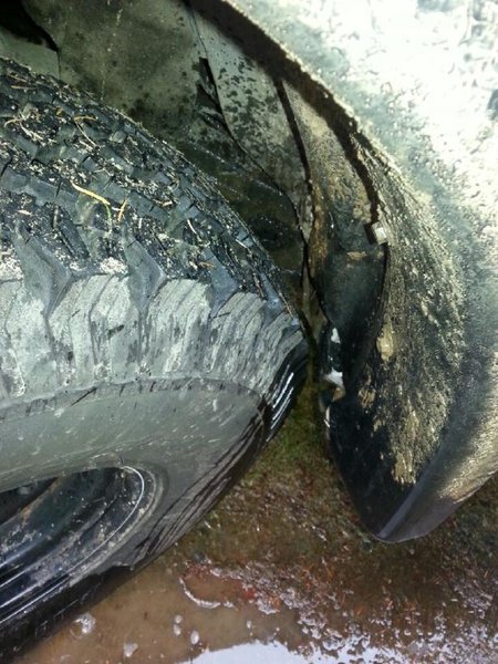

    Hey I got a 99 Toyota Tacoma. Auto, 4x4, 6 cyl.
    I bought 33 x 10.5 tires because I wanted bigger tires and everyone I asked said they would fit. The front tires now rub. I cut back the fender and even cut off as much of the body weld as was safe. When I turn most of the way (left or right) over rough terrain, the corner of the tire still rubs which makes offroading annoying/bad for everything. Theres about a half inch of clearance when turning the wheels when its parked. So should I try to sell these tires and go back to 32's or put in a leveling kit? I know next to nothing about leveling/ lift kits so I wouldn't want to do it myself. Any feedback is appreciated thanks.
    I've attached a pic of the suspension to help with the lift kit idea.

    Don't listen to these guys and their smart ass responses. A lift doesn't make your wheel wells bigger.
    OP, you're going to have to do the complete pinch weld mod. There's a good write up here:
    http://www.expeditionswest.com/equipment/tacoma/bfg_mt_km.html
    Probably followed by some time with your favorite BFH.
    Also, I'm more confused/concered about the top plate of your coilover. Something doesn't look right in that pic, but it could be the angle. Can you get another pic?

    Only at ride height. Under compression he'll still be hitting the same spot. And 33x10.50 aren't really all that big.

    go with beillstein 5100 adjustable and add aleaf in back will give you enough room just put it on my 98 even gave me better ride

    If i recall correctly, it's been posted multiple times in the 255/85/r16 owners experience thread, that a 33" tire would fit with no lift, but permanent modifications are required.
