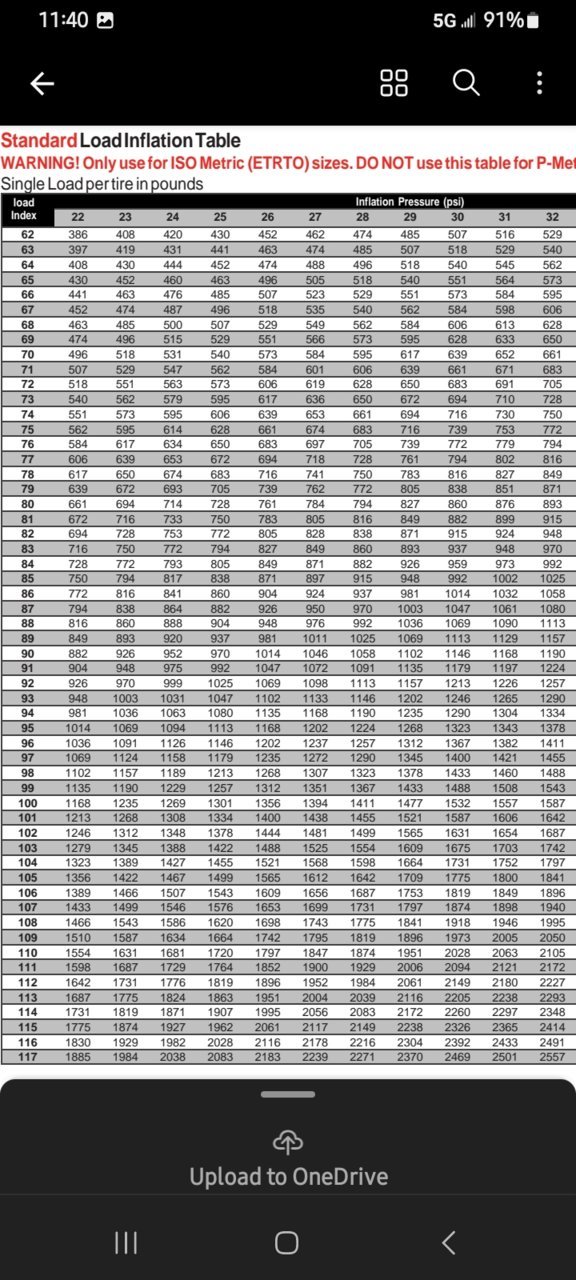

    Because PSI is just a means to an end...'inflated load capacity'.
    3d gen Tacomas have a inflated load weight of 2,149 lbs-2,172 lbs from P and euro metric tires.
    Examples:
    265/70/16/112(euro-metric)@ 30 psi = 2,149 lbs(Offroad)
    P265/65/17/110(P-metric) @ 29 psi = 2,149 lbs(Sport)
    P245/75/16/109(P-metric) @ 32 psi = 2,172 lbs(SR)
    The vehicle manufacturer de-rates euro-metric and P-metric tires for use on trucks and SUVs.
    If you switch to LT tires, the new inflated load weight is 2,149/1.1=1,954 lbs.
    Use the proper euro-metric, P-metric or LT load chart to find the PSI that attains this weight for your particular size and/or load rating.
    This Toyo pdf explains it more in depth and has all the charts.
    https://www.google.com/url?sa=t&sou...FjAAegQIBBAC&usg=AOvVaw1v0RyQdiINxLjc4FG6ti4v
    What tires you running?
    TRDRed likes this.

    #402333
    265
    20Tacoma
    I run 38 front, 34 rear. Thats what the chalk test showed as good.

  13. Sep 18, 2023 at 9:41 AM
    #73
    splitbolt
    splitbolt Voodoo Witch Doctor
    Mar 7, 2010
    #32761
    7,858
    NW Arkansas
    2016 TRD OFFROAD DCSB MGM
    That is a euro-metric 245/75/16/111 SL.
    111 is the load rating.
    It has a load capacity of 2,172 lbs @ 32 psi.
    TRDRed likes this.
