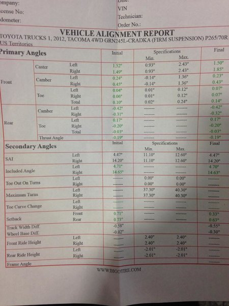

    Okay, here's a picture of my current numbers. You said to tell them to put the caster to +2 on both side or which one? i'm having trouble with the right side

    Those number are OK, certainly not ideal.
    What's up with that thurst angle? It's like your rear axel is slightly crooked. You may want to have that looked at. It could be a screw up on the alignemnt rack I guess.
    Your front toes are good. No problem there but that's the easiet to get right.
    Looks like the increased the caster on the right wheel. Maybe they are trying to compensate for the pull. It looks a little odd they did it without affecting the cambers hardly at all. You'd think they'd try to coorect the small cross camber while they had everything loosened up.

    Caster should be as even as possible. How did it drive before you got an alignment?
