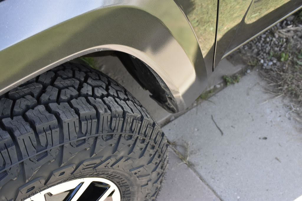

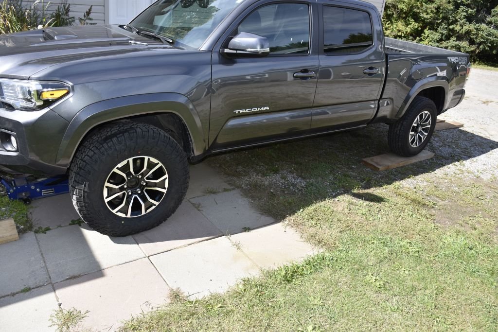

    Yes they do fit but it's close, this first set of pics shows them on my stock '23 with 1" wheel spacers, this gives a bit more of a wide fat look. The 1" spacers gives me about an ET4-5 so they wouldn't fit a zero offset rim without some trimming/reshaping of the inner fender, I think I will try removing the spacers (stock ET30) as I don't think any trimming will be necessary at all.
    My future plan is a 2" lift and better shocks and springs.

    1st pic the front is the wildpeak, rear is the stock Firestone 265/65r17. The wood block is to simulate the new tire height. Changing the rest of the tires now, 5 in total. I didn't take a pic of the front inner fender clearance as I thought I had lots, turns out it's maybe a hair more but that's it. spacers are coming off. Checked clearance with upper A-arms and it has lots.

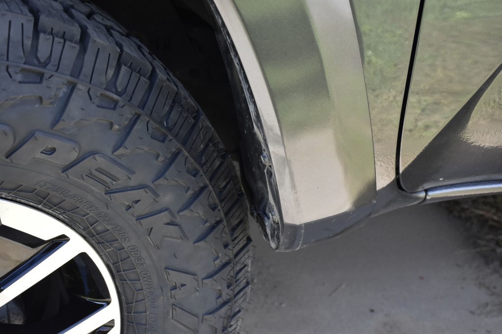

    So they do fit but I did have to do a bit of minor trimming and slight heat and bend. Pretty sure i could have removed the 1" spacers and wouldn't of had to do that. Overall real happy, looks great, but I will be doing a 2" lift. Slightly harsher ride, but no different from going from summer tires to winters.

    You may not have to do any trimming…
    Have you done the alignment and moved the lower control arms forward? This moves the wheel forward away from the rear wheel well. Also increases Caster.

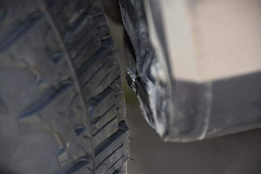

    I don't think I'll mess with the caster right now as it was also touching the front plastic during the turn. The slight bending of the plastic with a heat gun and a 2x4"between the inner fender and the tire has stopped the rubbing when turning. I also cut off the tip that you can see sticking out in my 4th pic, I think that was making the most noise in a sharp turn.
