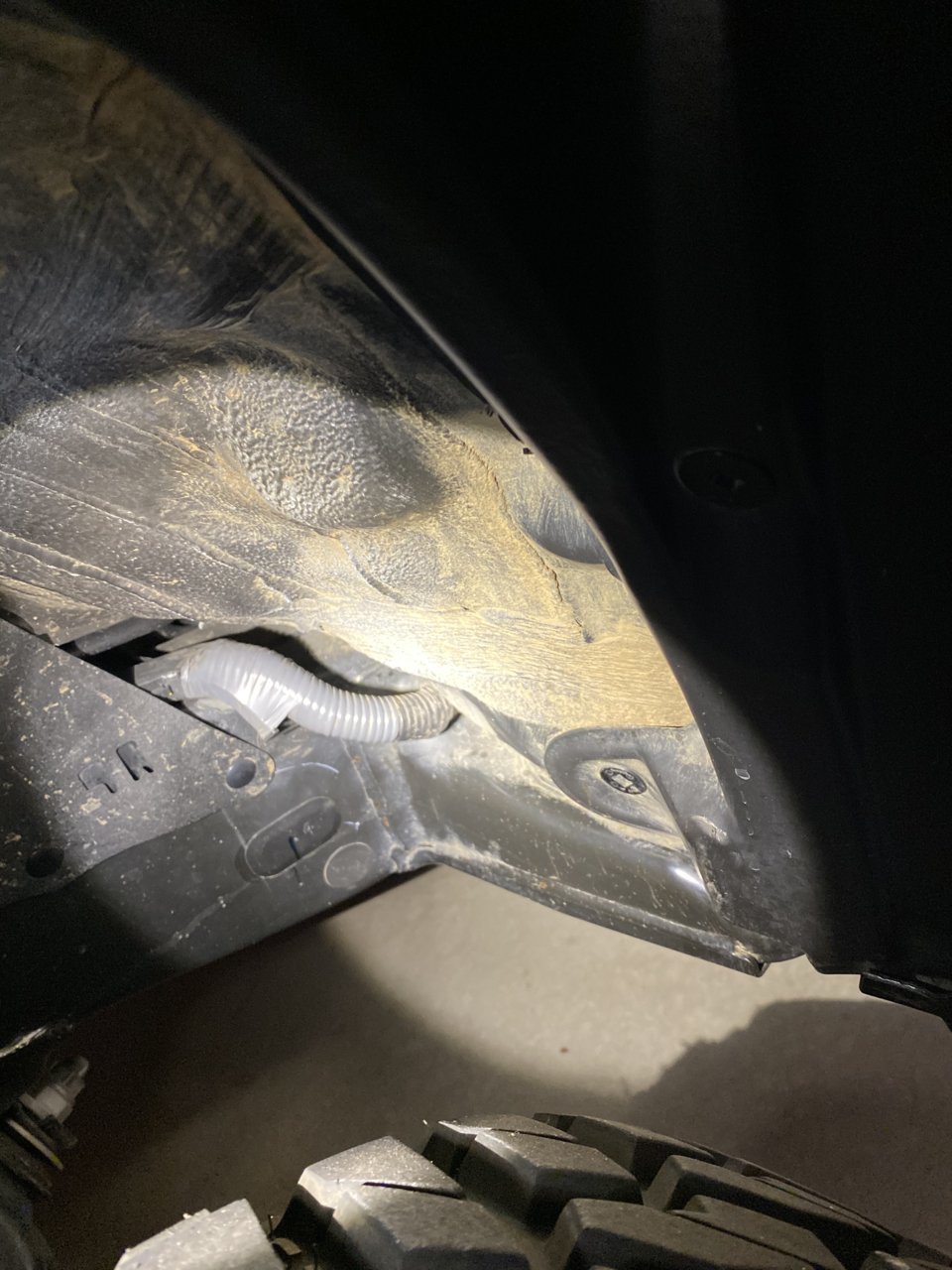

    This may not be a ton of help but maybe some encouragement. I bought mine with a 2 inch (sales guy said 3 but the Toytec sites says 2) lift with 285/70/17’s which I believe are REALLY close in size to the 285/75/16. They did replace the UCA’s with SPC’s which have a lot of adjustment. I don’t see that there was a lot of cutting and chopping and stuff and mine does not rub at all. I can take pics of the components and wheel well if you want.

    I think adding the SPC UCA’s is all they did with mine to fit the 285/70R17’s on a 2 inch lift. Not that familiar with the looks after cutting and chopping but here is mine and looks like nothing was changed?

    This is the driver side. The very front is hard to see because it’s behind a skid partially.
