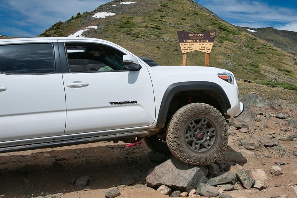

    Don’t know exactly how they did it but I do not rub off-road with my 285. Posted pics thus far to show setup. Just trying to help so if someone wants different pics let me know.

    Do the tires rub on the upper control arms at all? I want to buy the 4Runner TRD pro wheels like you have but the +4 offset I would think they'd rub on the control arms. I have the same Nitto tires as you do 285/70/17 and people have said the 7.5 width of the pro wheels are to skinny for that size of tires. Have you had any problems?

    I have had no issues whatsoever. I love the way this thing wheels. I have done some moderate and difficult rated trails with no rubbing. Youtube China Wall, Slaughterhouse Gulch, Tin Cup Pass, and Mt Baldy all in Colorado to see the types of trails. These are the ones I have done in the past 2 months or so.
