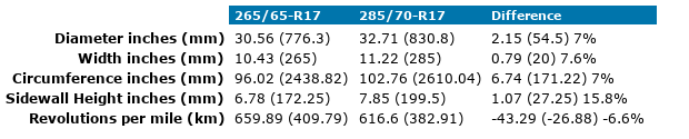

    So I'm on my first full tank with the 285/70R17s I bought from Mick...and I want to make sure I'm correcting the math right.
    [​IMG] gives the numbers for the adjustment math...but do I need to change my ODO mileage by the 7% or the 6.6%??
    Thanks for idiot checking me!!

    7%
    Mileage (x) 1.07 / gallons filled up = MPG

    how exactly r u getting the 7%? is it by the diameter difference?

    7% is the amount that circumference of the tire changed. So for 1 revolution of the tire the new larger tires go 7% further than the old tires.
    I thought it was the 7% but I wasn't positive...Thanks for the back up john!!
    I'll post up what the new MPGs are when I get home.
