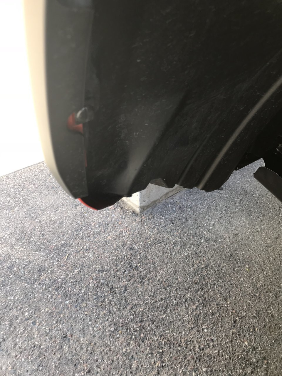

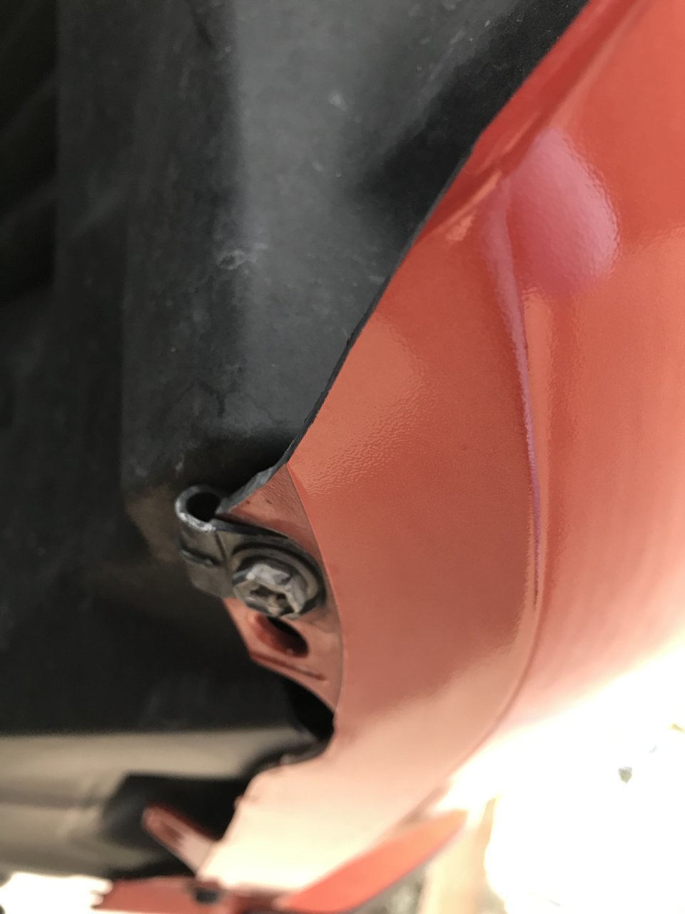

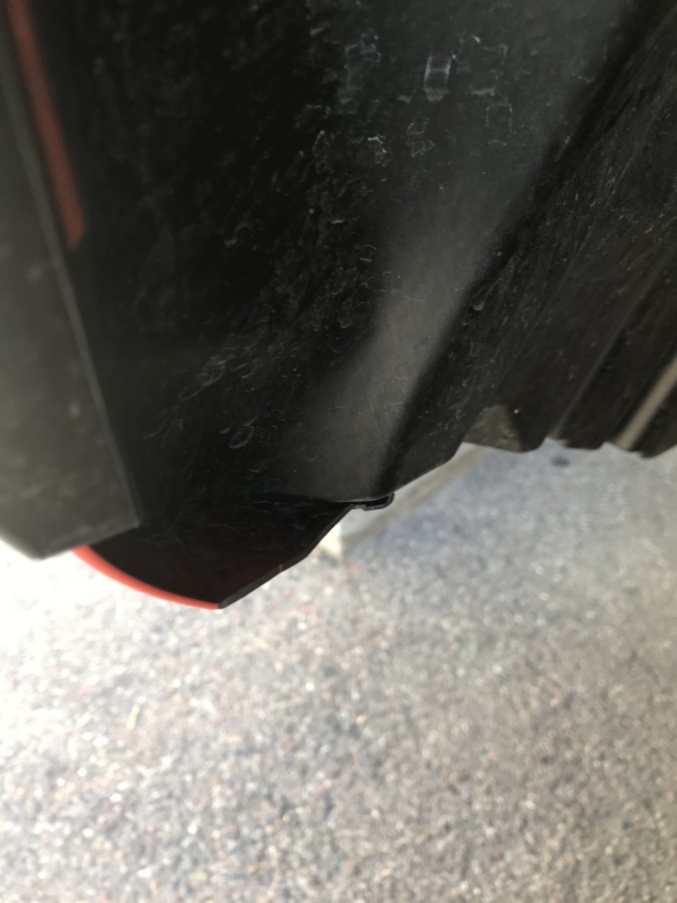

    285/65-18 with a leveling kit. -12 18x9 wheels. Slight trim of the inside if the front bumper to get rid of the rubbing.

    could you share a photo of the bumper trim you did for clearance? I may do this in a few days, got a very slight rub.

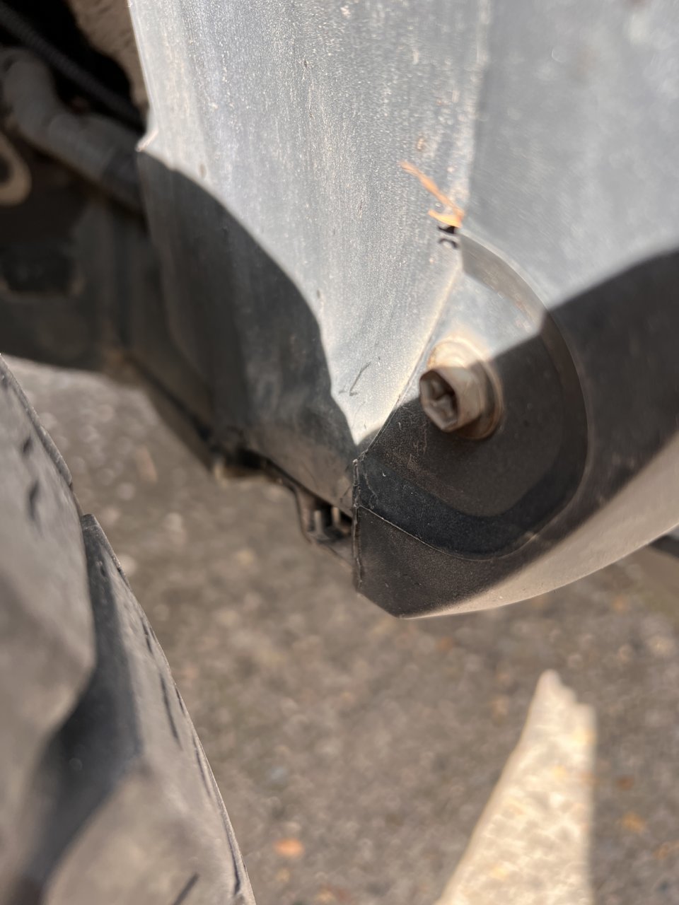

    Tonneau cover, Black exhaust tip, blacked out badges and tailgate lettering. Black rhino(glamis)18x9 wheels with +12 offset. LT265/70/18 Toyo Opencountry ATIII. Metaltech 4x4 rock sliders Cali Raised lower grill light bar/mounts TRD Pro Skid, DD Fogs(pro), Ironman 4x4 FC pro lift.
    2” lift with 265/70/18’s. Trimmed the back of the fender slightly to eliminate rub while turning into driveways. 7762DC4C-F286-4EBA-B77A-67B4944CCEB4.jpg73932A8F-97A3-4629-9F3E-1ECA50325300.jpg
