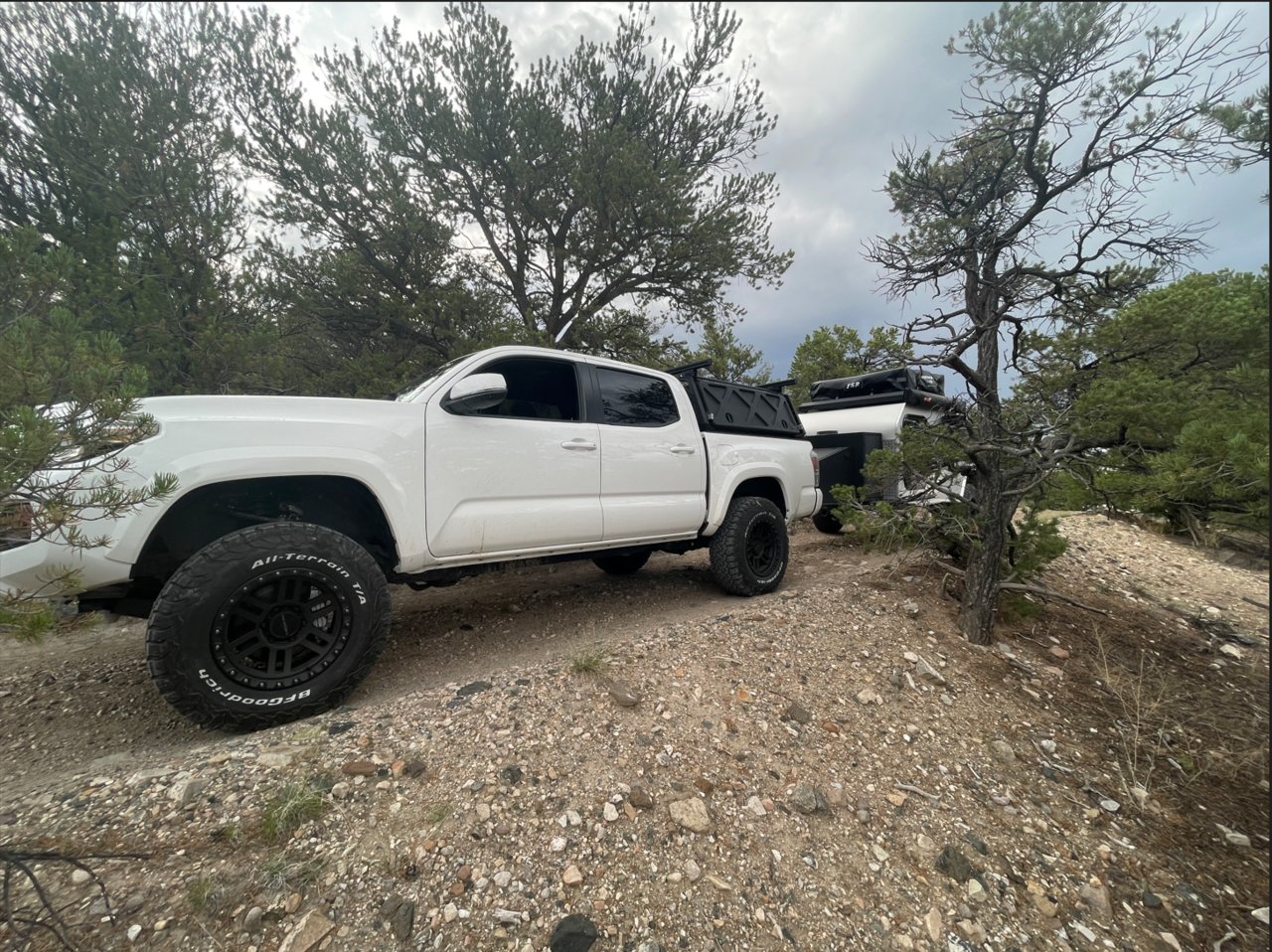

    I have KO2s on my trailer and my truck. Normal street use for me is 40-45 psi in the trailer (3500# 15' off road travel trailer), 32 - 35 psi in the front and 45-50 in the back. Keep in mind I am heavy and towing.
    Don't be afraid to screw around with the pressure. See what 50 psi feels like on the road (it is crazy firm - you will feel a lot of bumps). Find a gravel road and air down to 15 psi and see what that feels like (be sure you have a compressor to air back up). You should be fine at 35 psi. If I were not loaded to the gills and towing I'd be running my KO2s at 30 - 35 psi cold. On the sand at South Padre Island I went down to 15 psi.
    275/70/17s on the truck 285/70/17s on the trailer. Soon to be 275/70/17s all around when the trailer tires wear out.
