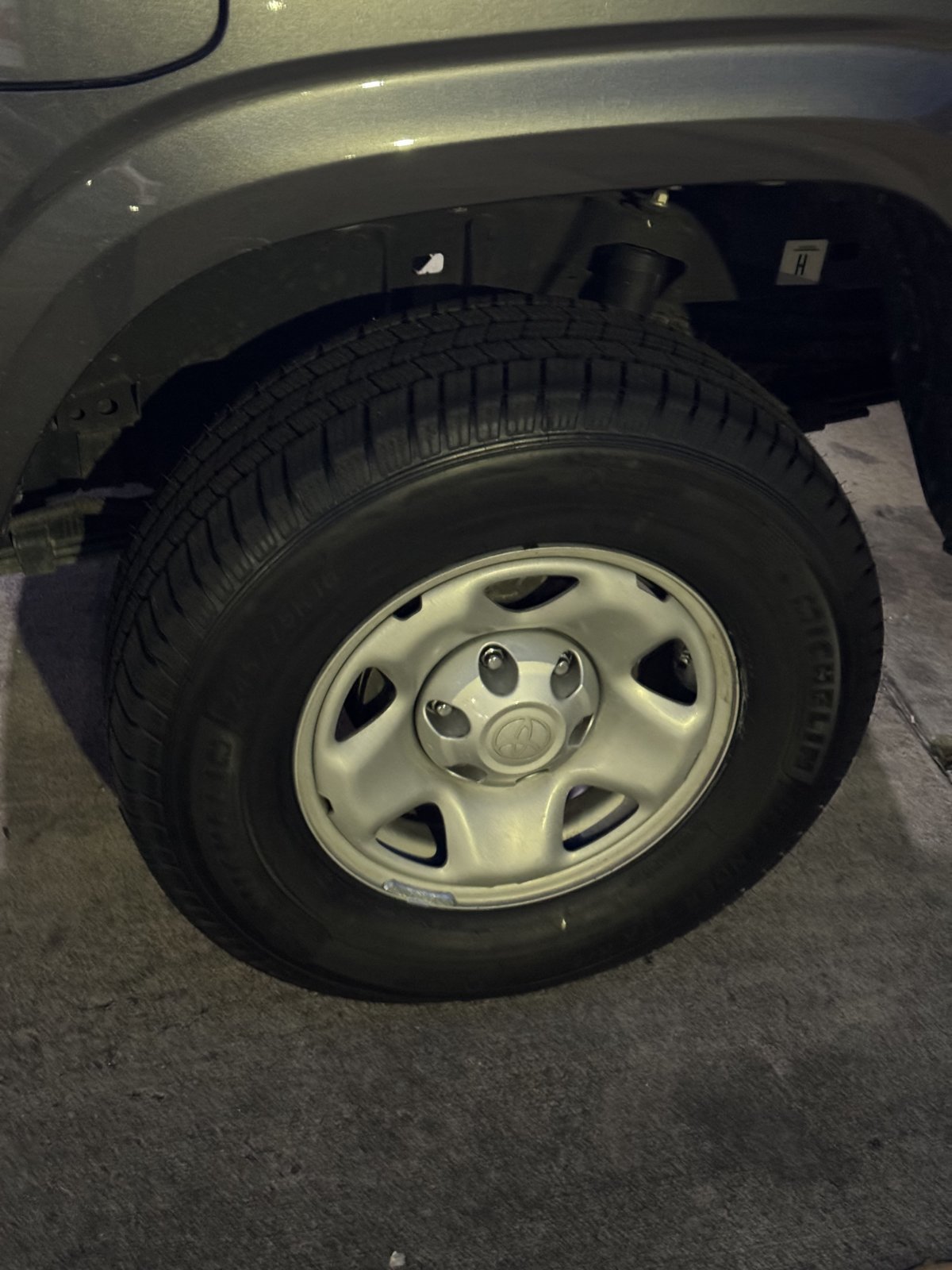

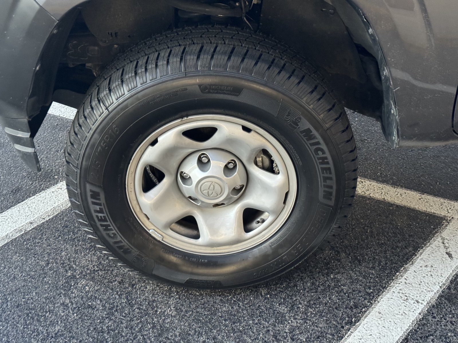

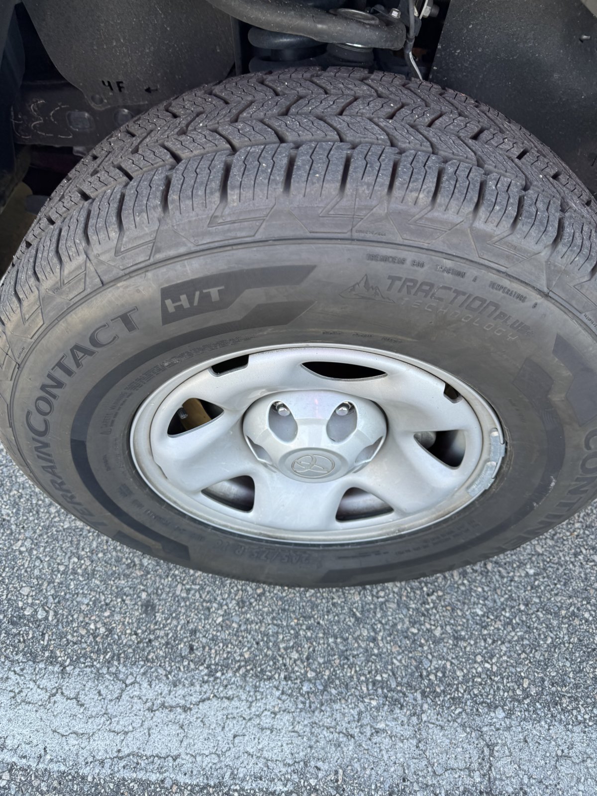

    So I had the factory set of Toyo’s a31 from the factory . All 4 tires were wearing on the outside and looked new on the inside. I got an alignment and it did not fix the issue. So I was in the market for a new set of tires, and it came down to Continental highway tire and the Michelin defender LTX. Between the two they continentals were a little bit cheaper so I decided to try those out and see how I like them and decided to save myself some money. I got the new tires put two weeks ago. And I had a balancing issue with the right front one I took them back last Monday they rebalanced all four tires but I drove it this past week and still had a balancing issue with vibrating and shaking at 4050 60 70 mph. So I decided to pay the difference and get the Michelin defenders LTX m/s . And Got the new tires put on took it out on the highway 50 60, 70, 80 mph there’s no vibration, no shaking and it’s smooth as butter on the highway and in the city. I do like the looks of the all-terrain tires on the tacos but for me 99% of what I do is on pavement all the time, so I’m glad I went with a high tire versus a heavier all-terrain tire. Both tires are high way tires but the Continentals at 35 lbs seemed way more heavier than the Michelin at 34lbs . My speedometer was off one to 3 miles when I had the continentals on the truck. I noticed driving on the interstate with the Michelin on the truck. The speedometer is back to normal like it has been since getting my truck new . So far it feels like I am riding on a cloud, and the tires feel more grippy on the road . I will follow up in a few thousand miles. IMG_4872.jpg IMG_4871.jpg IMG_4658.jpg

    canuck guy

    Looking at your photos, there seems to be a lot of weight for new tires on 2 year old clean steel wheels. Just my opinion.
    I wouldn't use that shop again.

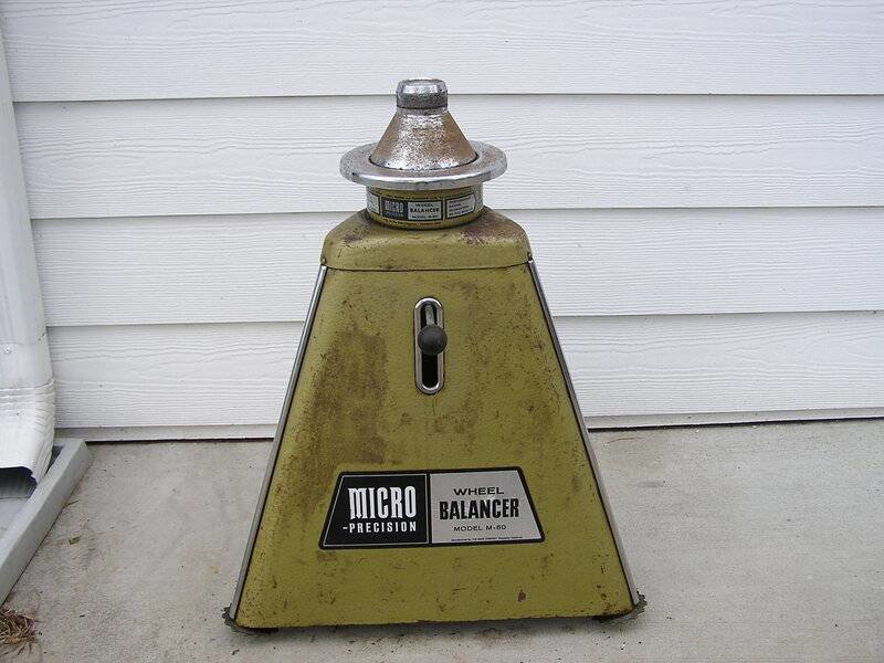

    I still use one of these:
    It takes a bit of time & patience but with a true wheel will give good results.
    Most people using these have never read the instructions and use them incorrectly. :annoyed:

    Awfully quick to blame the worker, although not unreasonable with workers in today's society. While a sensible test would have been to at least break the bead, rotate the tire, reinflate & rebalance. Then road test. Problem with this from where I sit is it's time better spent NOT in the shop. I doubt OP will regret his choice.
    Yup. Probably all on the front side too.
    As did I in my gearhead days.
    I always balanced with (4) equal weights, locating them in a equilateral triangle pattern pointing at the heavy spot. Then I'd mark the location of the weights and install (2) on the back side of the rim.
    Then remount the wheel on the balance and position the remaining (2) weights. They seldom fell exactly in the same locations as those on the back, but fairly close.
    Make sure the bubble is centered and tap them home.
    This method distributes the weight more uniformly around the circumference. You can still center the bubble with (2) heavy weights on one side, but dynamically the wheel is still lop-sided and will cause vibration or a wobbling steering wheel.
    JMHO

    I had the Continental all 4 tires balanced , twice and road force balance as well. Had the Michelin put on this evening and there’s no vibration no shaking no issues so far. So I don’t know if it was the tires or they had too much weight on the tires hard to say. The truck rides like normal when I had the factory tires on .

    ^^^ The correct way to use the bubble balance machine ^^^ :thumbsup::thumbsup:
    Well, there are at least 2 of us left... :fistbump:

    I'd wager most here have never even seen one of these or dismounted / mounted a tire.
    Just the way it is.
    RustyGreen[QUOTED] likes this.
