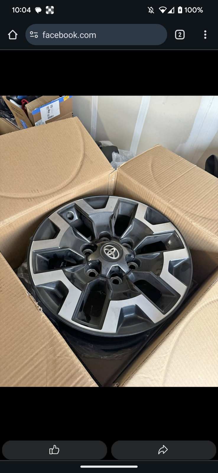

    Hey all,
    I've been wanting to add new rims to my 2020 SR access cab as the stock ones have a bit to be desired. I've attached a photo of the rims I want, which I believe are 16 in by 7 in (see attached photo of the exact rims I want).
    My current tire size is P245/75R16 109S. I'm thinking of either sticking with this size or upgrading to P265/70R16. So my questions are the following:
    1. Will my P245/75R16 tires fit on these rims?
    2. Will P265/70R16 tires fit on my SR without any issues like rubbing and whatnot? I have stock suspension.
    Thank you all in advance for your answers! I'm really enjoying learning about these vehicles and I'm excited to make mine look cool!

    Your picture shows the Tacoma Off Road standard rims, so they should fit just fine. As to the tire fitment, many are saying yes. I run the 255/85R16 tires (~33") on my truck with an alignment adjustment and have no problem. There is a HUGE 255/85R16 thread on here somewhere.
    I do have one concern with your desires: The lug nuts may have to be replaced. I 'think" your SR uses the older style cone lug nuts like most cars have used for years, and those rims use the flat pressure type of lug nuts. So, you may have to source new lug nuts too. Just a possible warning.
    Note: I have no experience with the SR rims, just a thought. I'm sure others will chime in.

    Thank you so much! The lug nuts are included according to the description, they're just not in the photo lol. I talked the seller down to $300, no idea if that's a good price for these used rims.
    I don't need tires quite yet so I will most likely store the rims until I need new tires, and then have the new rims out on at the same time.
