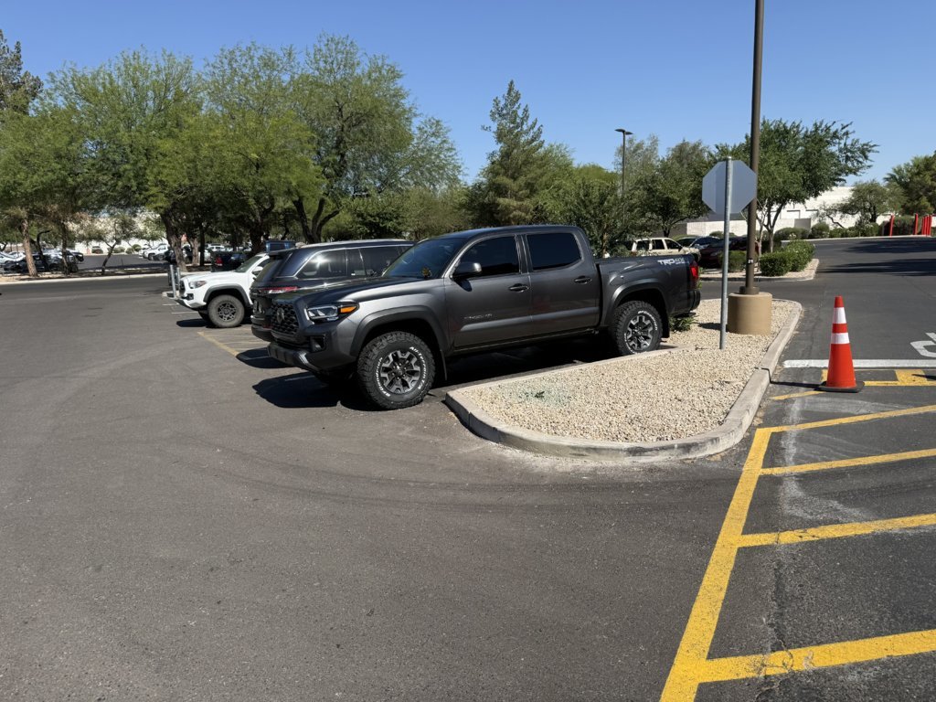

    E rated is not overkill if you plan on wheeling, ha. Sometimes I even see the E rated ones at a lower price than the C rated ones.
