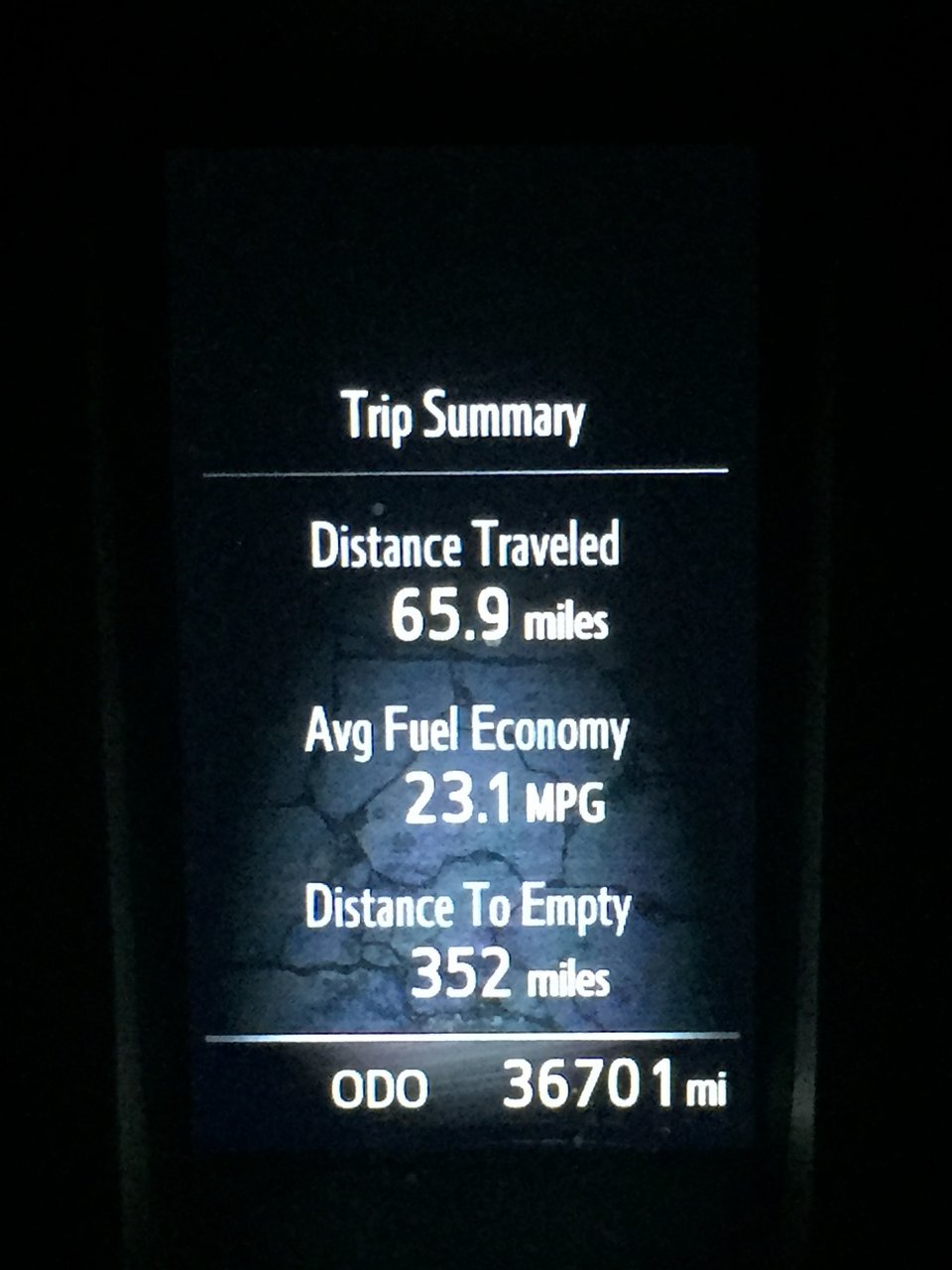

    My 4x4 SR5 SBDC daily driver with 45 mile interstate commute and offload on fun off work days has been getting 19.5-21 mpg on every fuel up since I've had it.
