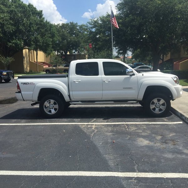

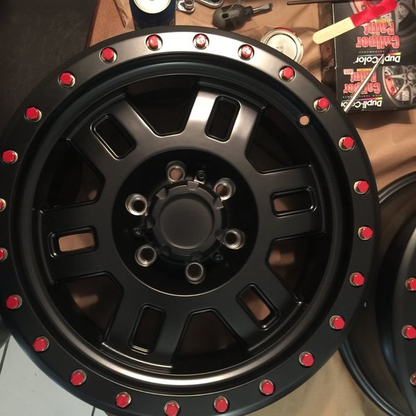

    image.jpg image.jpgInstalled 3" Rough Country lift. Have 8.5" wheels just haven't decided on tires yet. I like the Toyo Open Country. Any advise on size? I want 285/70R17 just don't want any rubbing.

    I have Toyo Open Country AT2 285 70 R17 with 2 Inch lift. It rubs a little when going hard offroad, but no real damage results, just scuffed plastic in wheel wells where the stock fender flares attach. Worth it for the improved off road ability IMO. I think they are a great set of tires compared to others I've had. Welcome to the site! Good luck with your search...

    I'm also 285/70/17 with a 2.5" lift, only had to do a very miner amount of plastic trimming on the front wheel well and remove mud flaps. Overall very happy with my setup.
