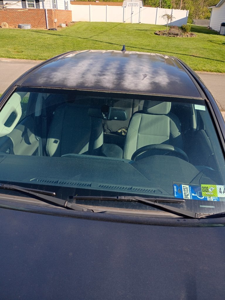

    New to group. Have a 2017 Tacoma Sr5 Gray with paint coming off the top of the cab. Anyone else had a issue with this. I'm told they only have a problem with white.

    If you are in Texas, Arizona, socal, or Florida and park outside, I would be surprised if you didn’t have a clear coat issue

    Unfortunately this is not too uncommon. There have been several threads on the roofs where the clearcoat has left the chat. At this point Toyota will likely do nothing.

    That's what they told me. I would like to know if anyone else has issues with paint besides white. They have to have so many complaints before they will address it. I have pic's but don't know how to share them to the forum

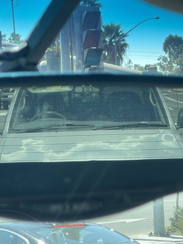

    PLEASE CLARIFY...
    Is it dark metallic grey or is it light metallic Silver???
    Light metalic Silver usually fails before dark metalic gunmetal grey....
    Only reason I ask, some people may refer to silver as grey.
    Heres the hood of metalic silver, roof looks the same...

    It is dark. I have pic's but can't share them. Not tech savvy enough. If I figure it out I'll post.

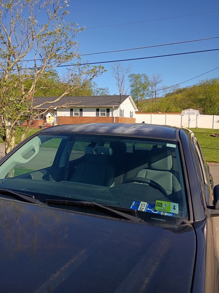

    IMG_20250427_084535666_HDR.jpg IMG_20250427_084535666_HDR.jpg I think I figured it out. Hope everyone can see this.
