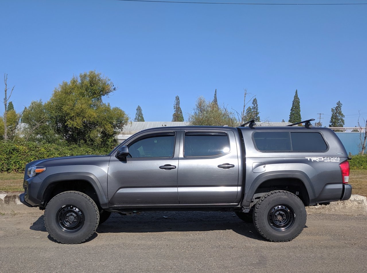

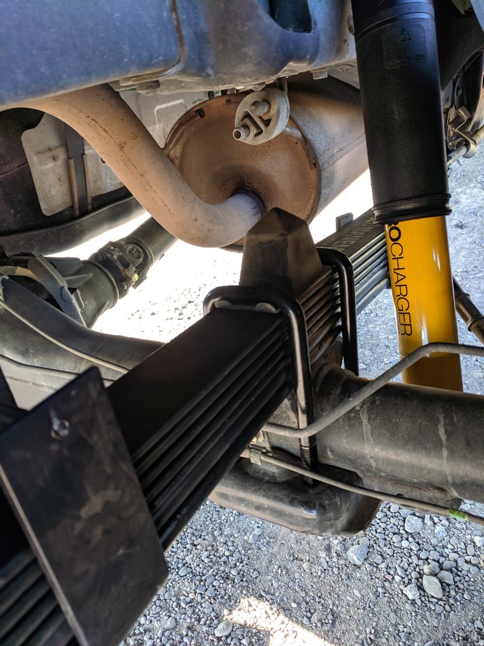

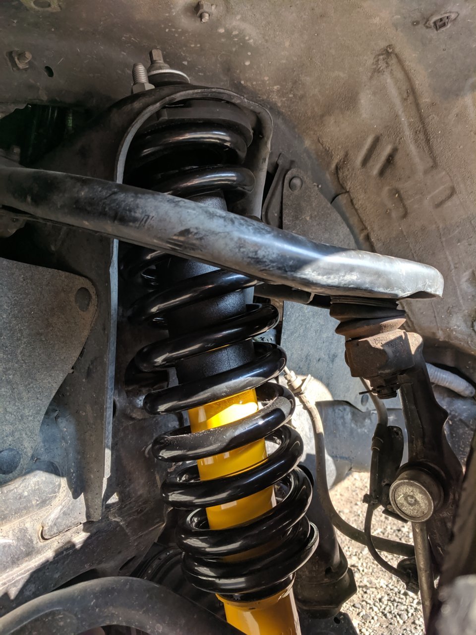

    I am nearly on this same set up. 255/85R16 Toyo MTs (33.5") and the OME heavy kit (Dakar leaf pack in the rear). Total lift was approx. 2" (mounted and measured went from 29ish inches to 33ish inches) from new tires, plus another 2.5" from the OME kit. Netted 4.5" taller than stock. Give or take a tenth or so.
    Stock UCA, stock bumps, stock brake lines, no cab mount chop, stock wheels.
