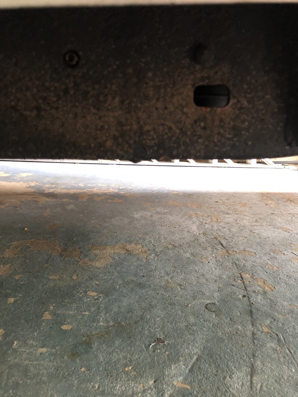

    OP, your frame is well out of warranty unfortunately. This brings up an interesting point. What does the frame look like? (Check the box sections near the cats.) If it's rusted through, you paid too much. If it's not, you did pretty good.

    Welcome to TW. The frame recall for a 2005 expired. The thing is if the frame is rusted and there is the possibility it will have to be replaced you should not have bought the truck. Your $7100 truck can end up being a very very expensive truck. Post some pics of rusted frame and let us take a look. I hope it’s not bad and the truck works out for you.

    gotcha thats what i fear - ill get under the truck and snap some pics later - trying to be a responsible adult and work from home unfortunately :(

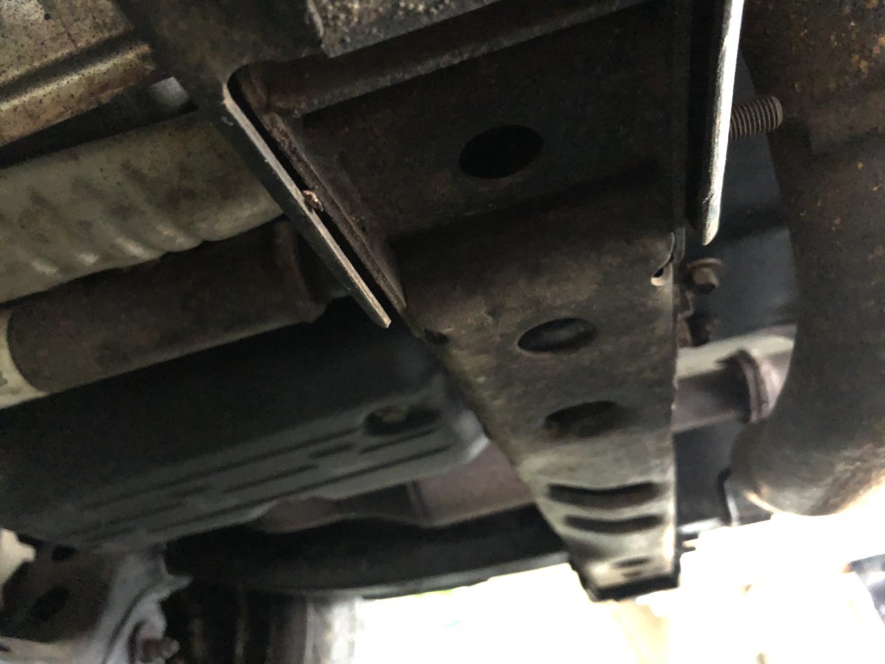

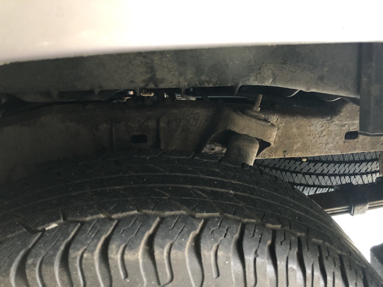

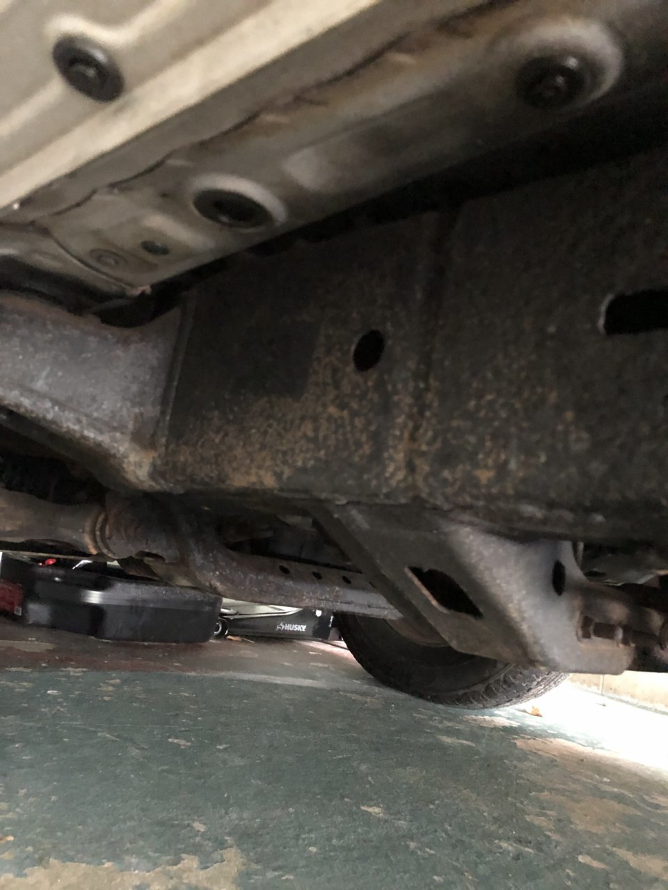

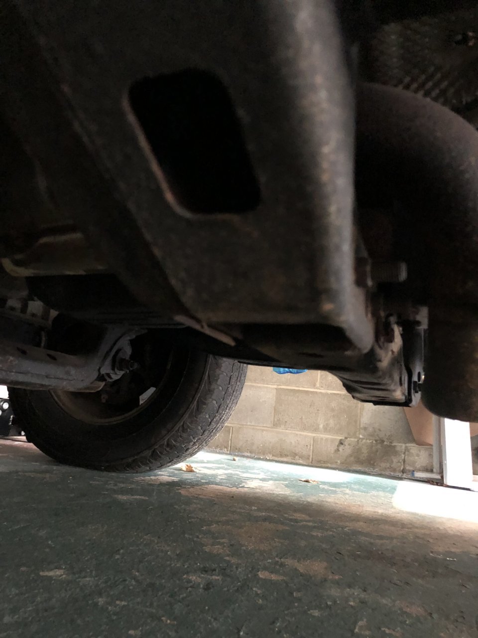

    see attached - sorry for the poor light (in garage)

    Frame looks good. That looks more like surface rust, which should come off with some wire brush scrubbing.

    Doesn't look too bad. Any idea whether the heads gasket issue has been addressed?

    thanks all - my friend said the same thing about the frame so thats a big relief to me

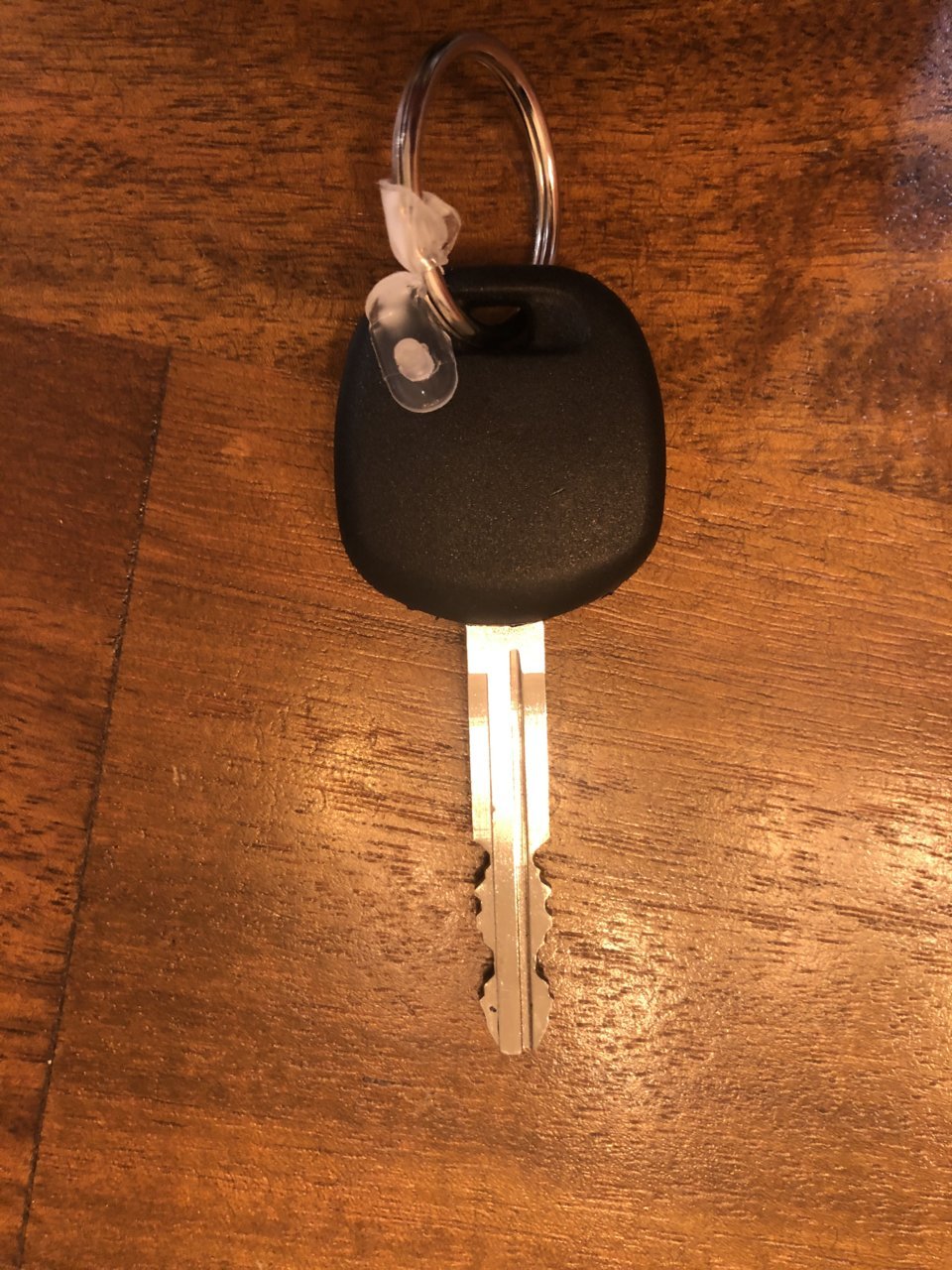

    Here’s a pic of the key. Looks generic and no dot. Not sure if it is immobilizer or not??

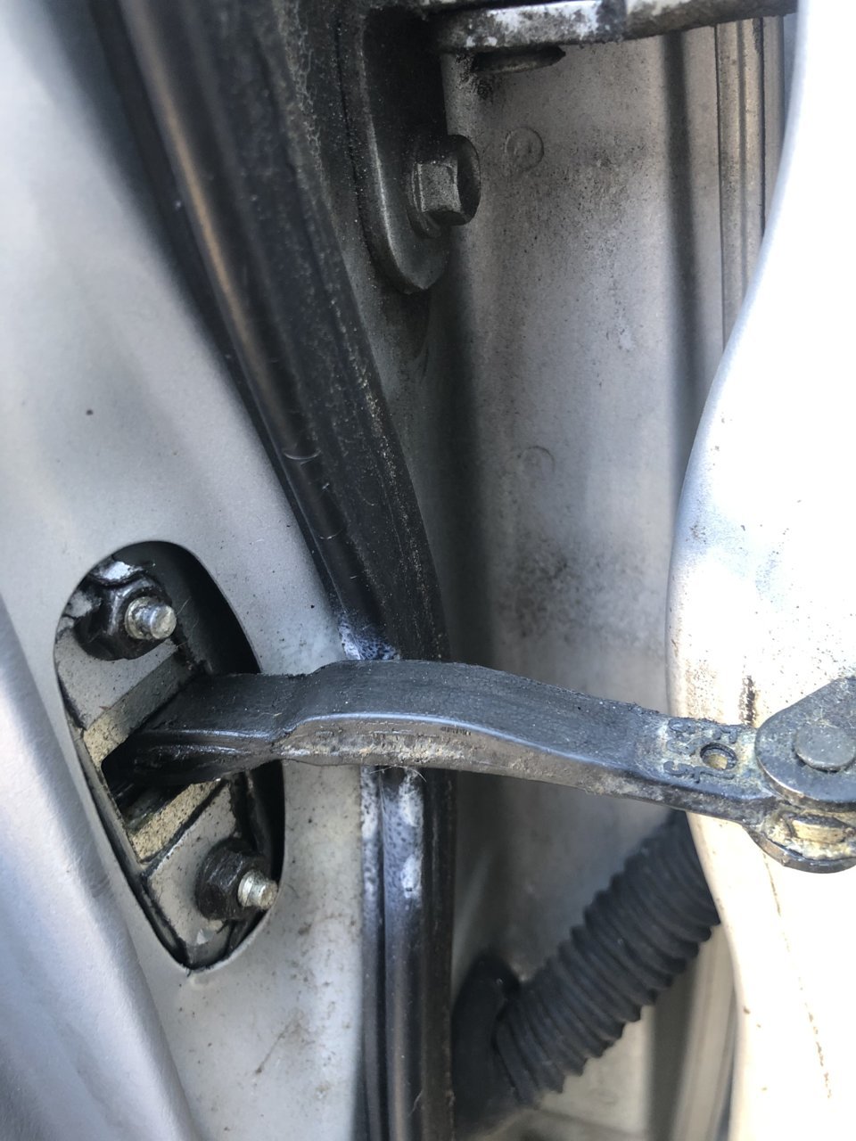

    When I got my 05 the drivers window wouldn't go all the way down either.
    Turned out the door check (keeps the door from opening too far) was bent, and that bent the window track.

    Thanks for the tip. I will look into it. I think it needs replacing as the door swings right back closing and will not stay open.

    No bueno.... even at that price I sure hope this isn’t your daily driver
    you don’t have an immobilizer because you wouldn’t have been able to start the truck with a generic key if you had one.

    The door check strap is definitely broke. A strong wind gust can easily blow the door open and break it. When you close the door, it bends the front window channel. So, you need a new check strap and a front window channel. Some people have been able to straighten the channel, but it’s best to just buy a new one. Here’s a video that shows how to remove the door panel. You might need to watch it a few times.

    Yea def issue with the door check, see attached. Looks like the mounting points on the door is broken. All wobbly in there. Guess I got some parts ordering to do this weekend.
