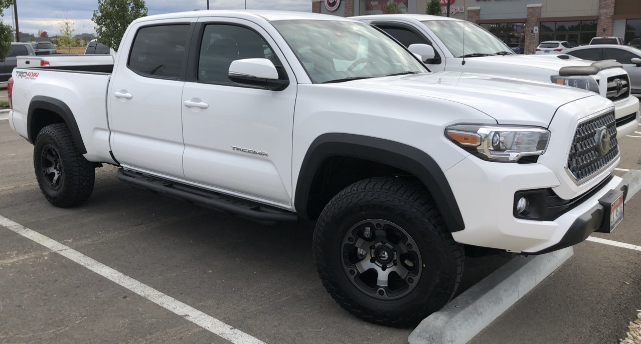

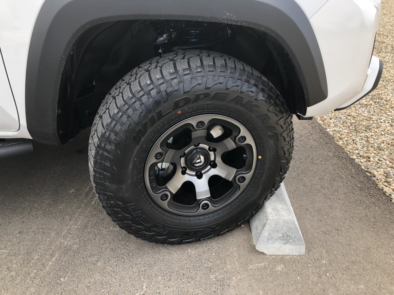

    Cheapest route is adding say a 265 75 16 on stock rims. They’re just a little bigger than stock and won’t rub on the factory rims.
    Lots more p rated option for 33s on 17s if you plan on lifting. 33s on 16s are almost all lt tires. I went with 16s and 265 75 16 falken wildpeaks and they were reasonable at $520 for the set of 4. They can supposedly be had cheaper if you wait for an eBay discount code.

    Yep. At3w

    265 75 16, right? i think thats what i can read on the side wall. those look great.
    EDIT: i see on that on your profile now..
