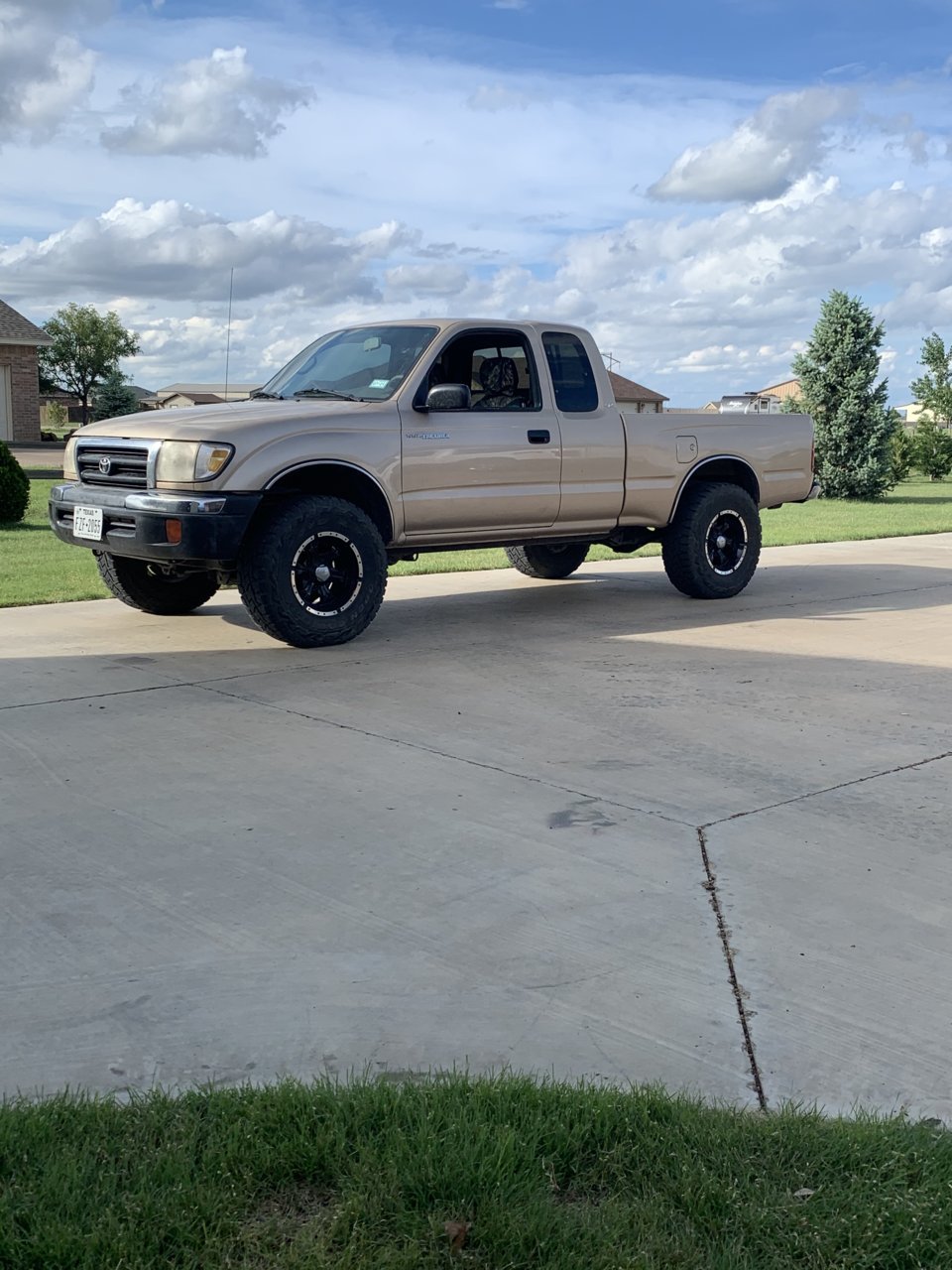

    Picked up a 1999 SR5 4wd AT. It’s got 194k miles and had a few issues so I got it cheap. Interior is nice outside of wear on the driver seat and door panel. Other than wheels and tires and cold air intake it seems completely stock. Paint is good but it does have a few hail dents mainly on the hood. Main thing is that it is rust free frame and body. It runs great and AC is cold. Here’s the issues I’ve dealt with so far.
    1. Top of radiator was cracked. I installed a new one and fresh coolant. Fixed.
    2. Steering rack was leaking and had excessive play. I installed a new one along with inner/outer tie rods and then got it aligned. Fixed.
    3. Dash/door rattles. Put some rubber between windshield and dash. Got a new push connector for both door panels. Mostly fixed.
    4. Passenger valve cover oil leak. Found most bolts were not even finger tight. Snugged them down a touch but still need to clean it up so I can see if this helped. Probably need to replace both valve cover gaskets. Not fixed.
    5. Washer fluid reservoir cracked up top. Wrapped it with fiberglass reinforcement for now to keep neck from breaking off completely. Able to fill it 3/4 full and washer system works for now. Not fixed.
    6. Tailgate missing one cable. Need to order a new one. Not fixed.
    7. Not a broken part but it’s got stupid heavy 31” Toyo RT tires that weigh 56 lbs each. They only have about 30-40 percent tread left so I’ll be swapping to a lighter tire of the same size in the near future.
    Here’s a pic.
    I’ve learned a lot cruising the forum so I just wanted to say thanks to those that post and answer questions.

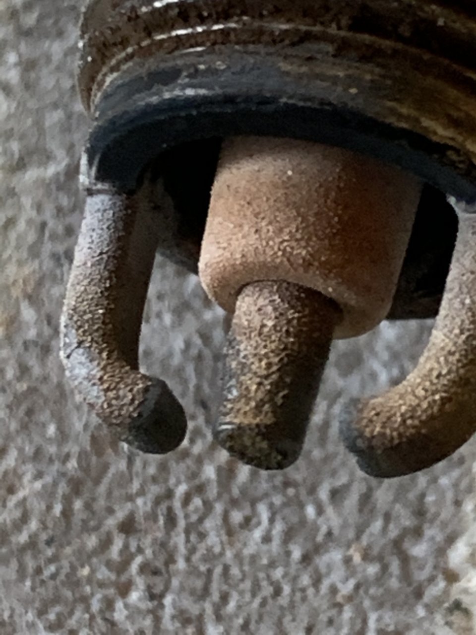

    Did a spark plug and wire change today. Since I didn’t have any history I figured it couldn’t hurt. Turns out the old ones were pretty worn. Gap was about .055 on all of them. Wires were brittle too. She was running ok before but much much smoother now. Idle is perfect and throttle feels better. Here’s a pic of one of the old ones. BTW I took out Denso K16TR11 and installed PK16TR11. Seems like the same plug but the new ones are double platinums. Should be good for a while. I used Denso wires too.
    I should also add that all the new plugs were only gapped at .030 or so. I adjusted them all to .044.

  12. Jun 6, 2021 at 5:30 PM
    98_3RZ_NIC
    98_3RZ_NIC Well-Known Member
    Jan 17, 2021
    #353073
    1,686
    1998 white extended cab
    Bilstein 5100’s with ome 881 coils on lowest setting, JBA upper control arms, LCE header, 31x10.5x15 falken wildpeaks.
    isn’t the gap suppose to be .032?
    roboturner likes this.
  13. Jun 6, 2021 at 5:43 PM
    DeerHunter44
    DeerHunter44 [OP] Well-Known Member
    Jun 1, 2021
    #367402
    49
    1999 3.4 4wd AT
    I hope not!!! I did some reading and found the most common answer was .044. Also when I bought the plugs they were supposed to be gapped at .044 out of the box. I hope someone smarter than me can confirm .044?
  14. Jun 6, 2021 at 5:48 PM
    98_3RZ_NIC
    Jan 17, 2021
    #353073
    1,686
    I just looked it up and I guess it depends on the spark plug. Some say .044 and some say .041 and some say .032
  15. Jun 6, 2021 at 6:07 PM
    DeerHunter44
    Jun 1, 2021
    #367402
    49
    1999 3.4 4wd AT
    Thanks for looking into that for me. I trusted a few forum posts that I found doing a quick search. I thought .044 seemed reasonable for a normal NA motor. FI motors usually require a smaller gap in the .025-.035 range.
    The .055 as found indicates a lot of wear if they started at .044. It would be a ton of wear if they started at .032.
  16. Jun 6, 2021 at 6:16 PM
    #16
    98_3RZ_NIC
    Jan 17, 2021
    #353073
    1,686
    yeah I have a EFI in my truck so mine is .032
