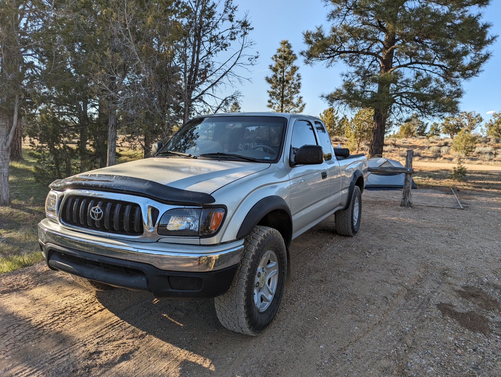

    Whats up members!
    Just picked up a super clean 2001 XtraCab Prerunner 3.4L 4x4
    155,500 Miles on it.
    Its my first truck, and also my first Toyota vehicle.

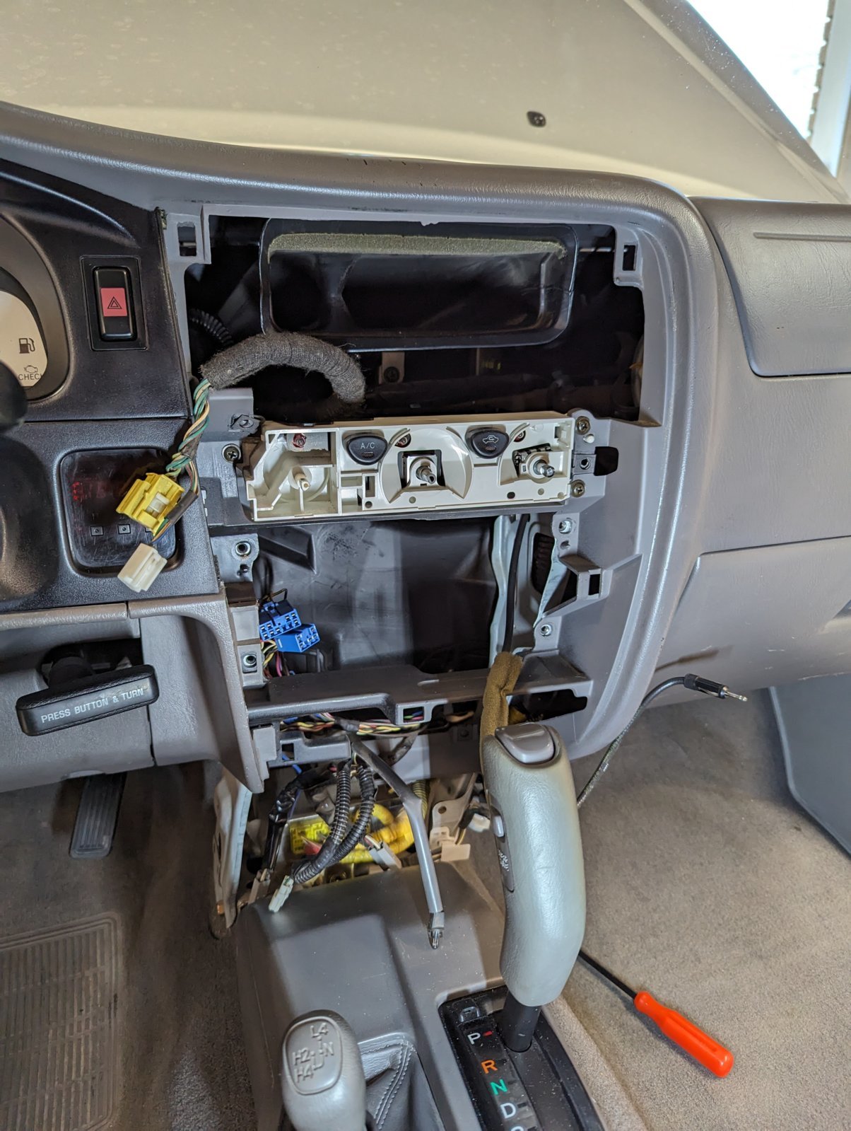

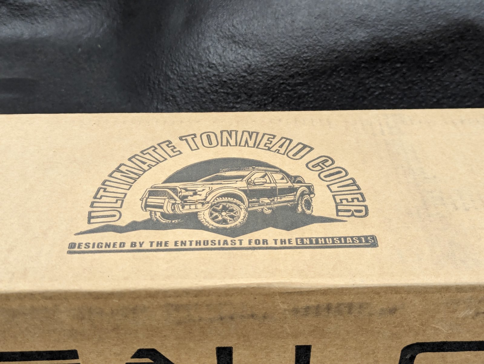

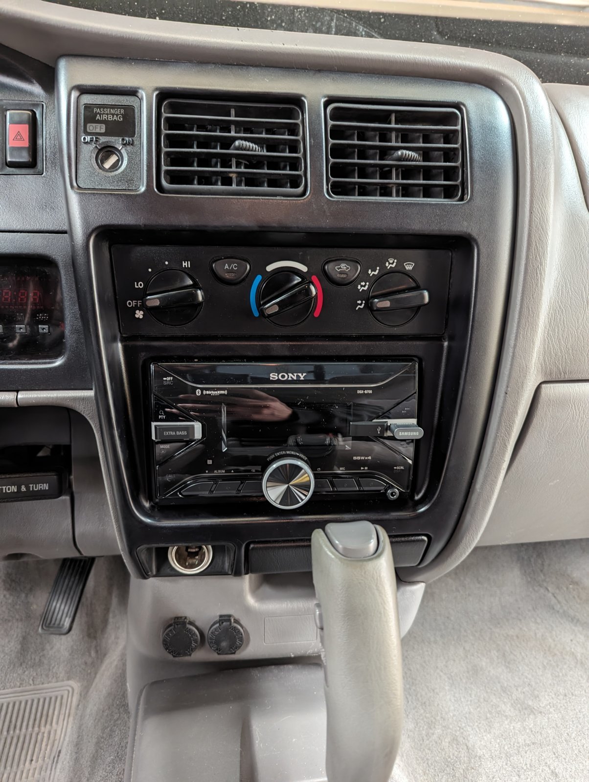

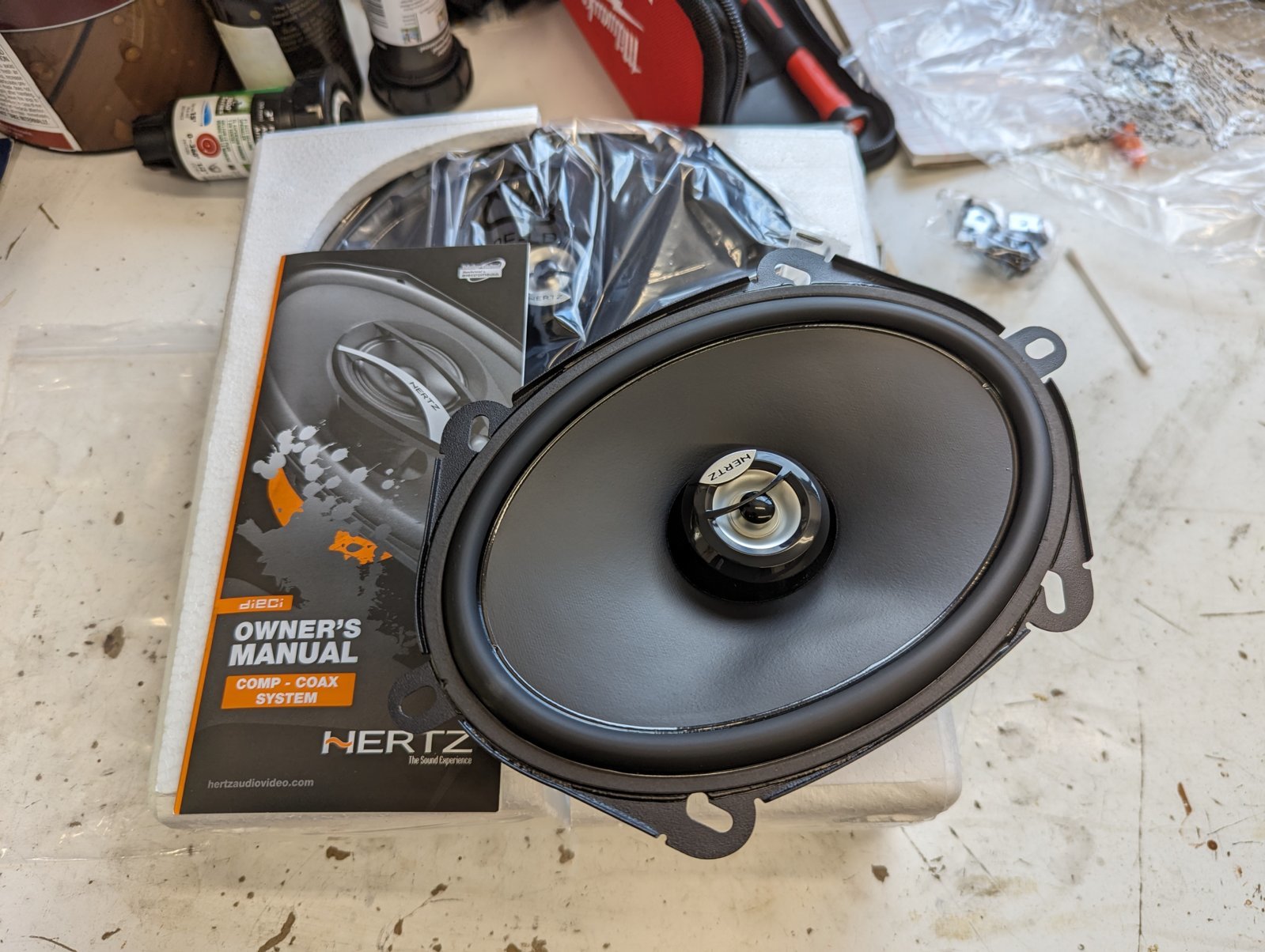

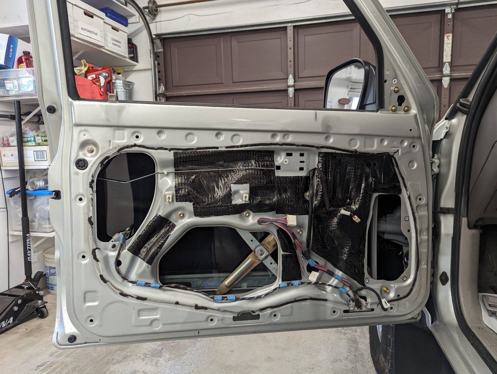

    The first few things I did with the truck was upgrade the stereo and speakers, and install a tonneau cover.

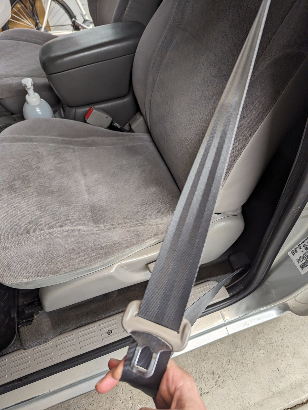

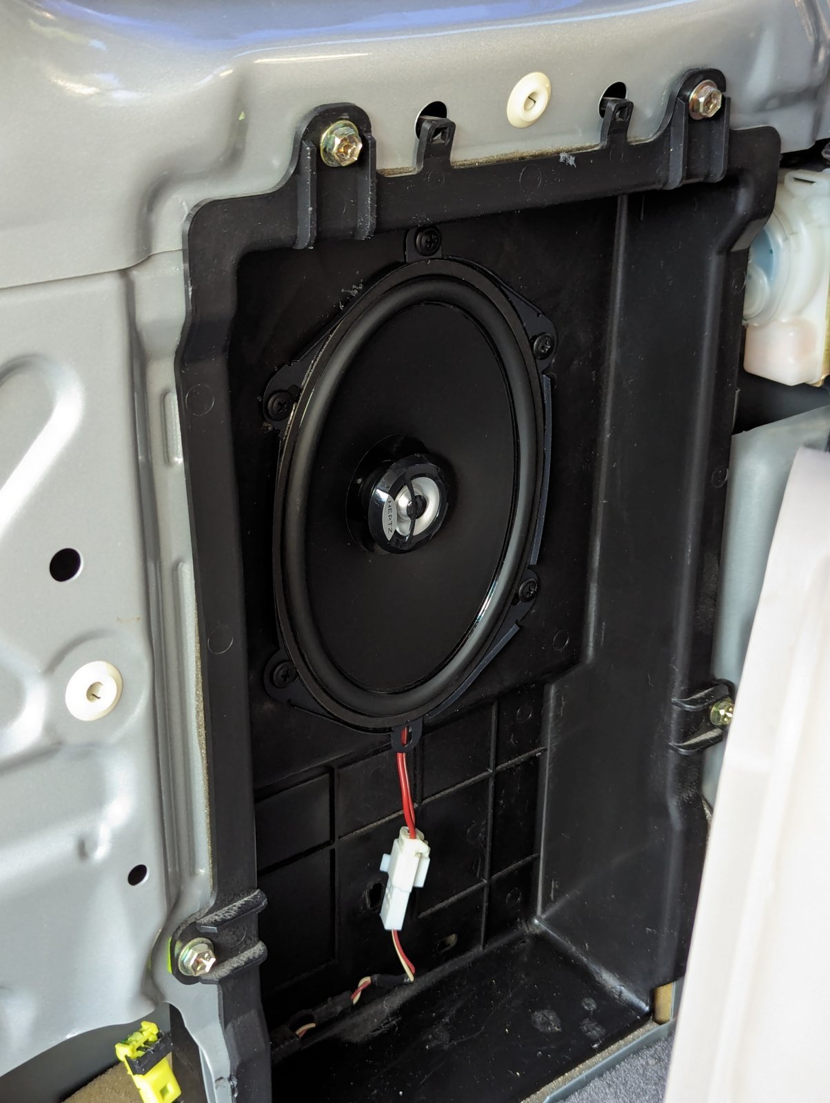

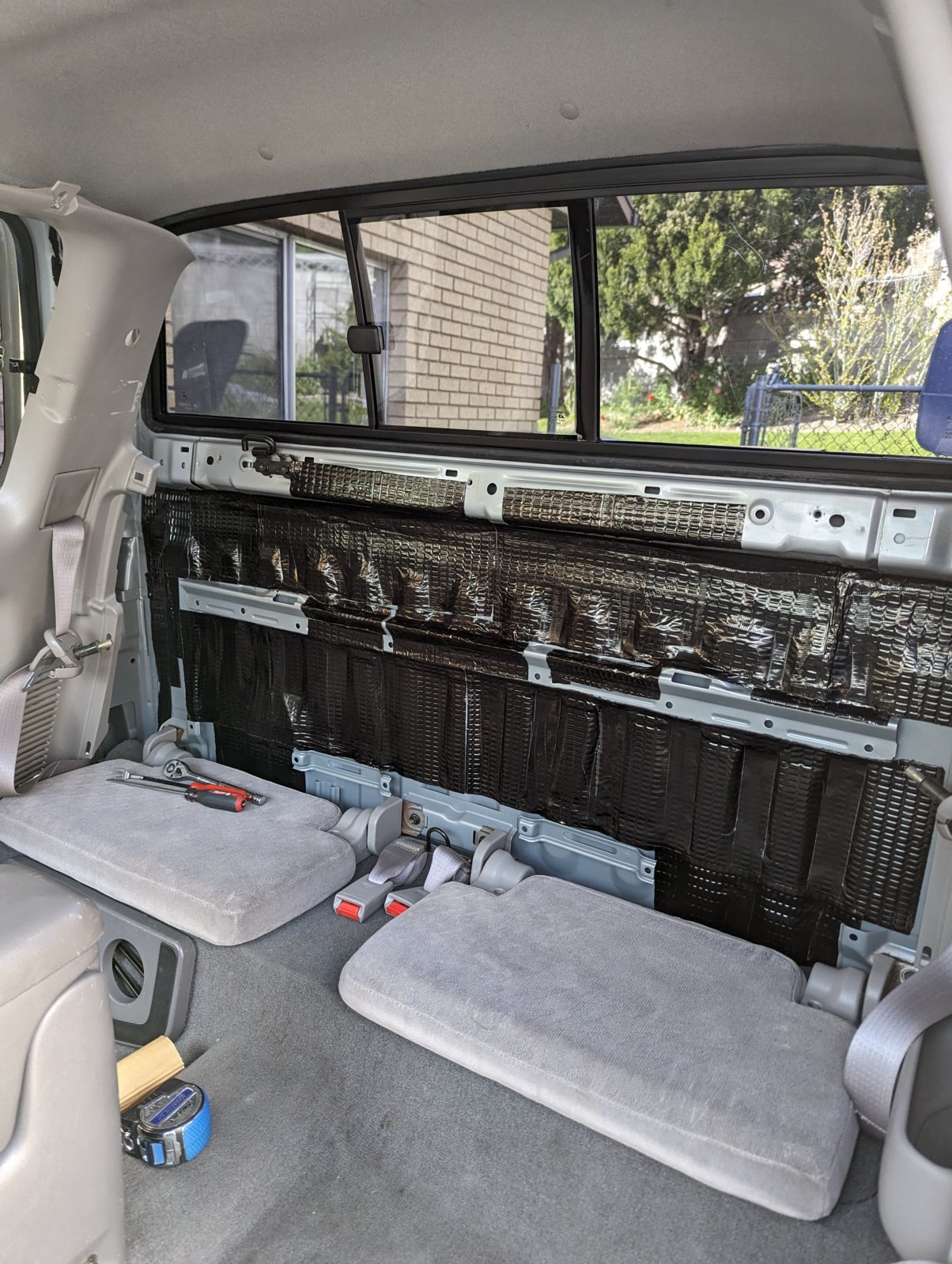

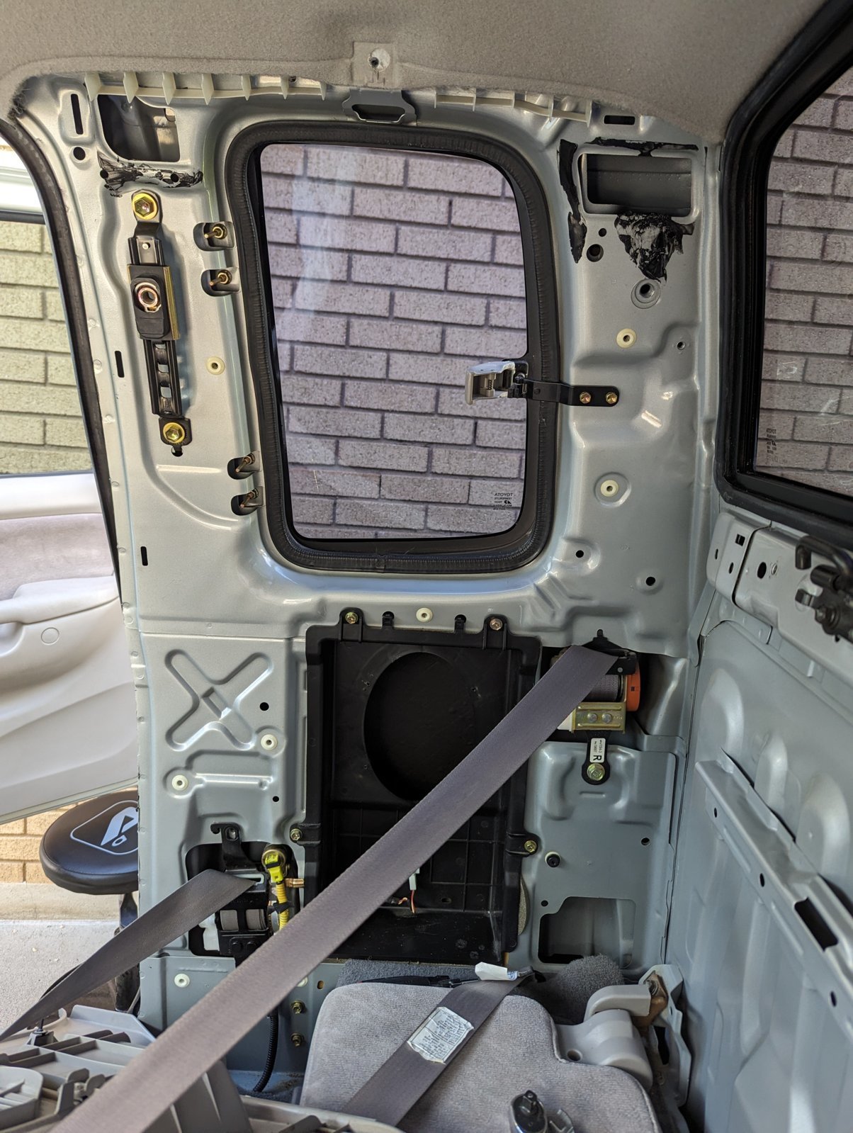

    Installed new rear speakers and also sent the seatbelts in for the webbing to be replaced.
    I removed the rear seats. They serve no purpose and I can gain another 3" of space inside the cab without them

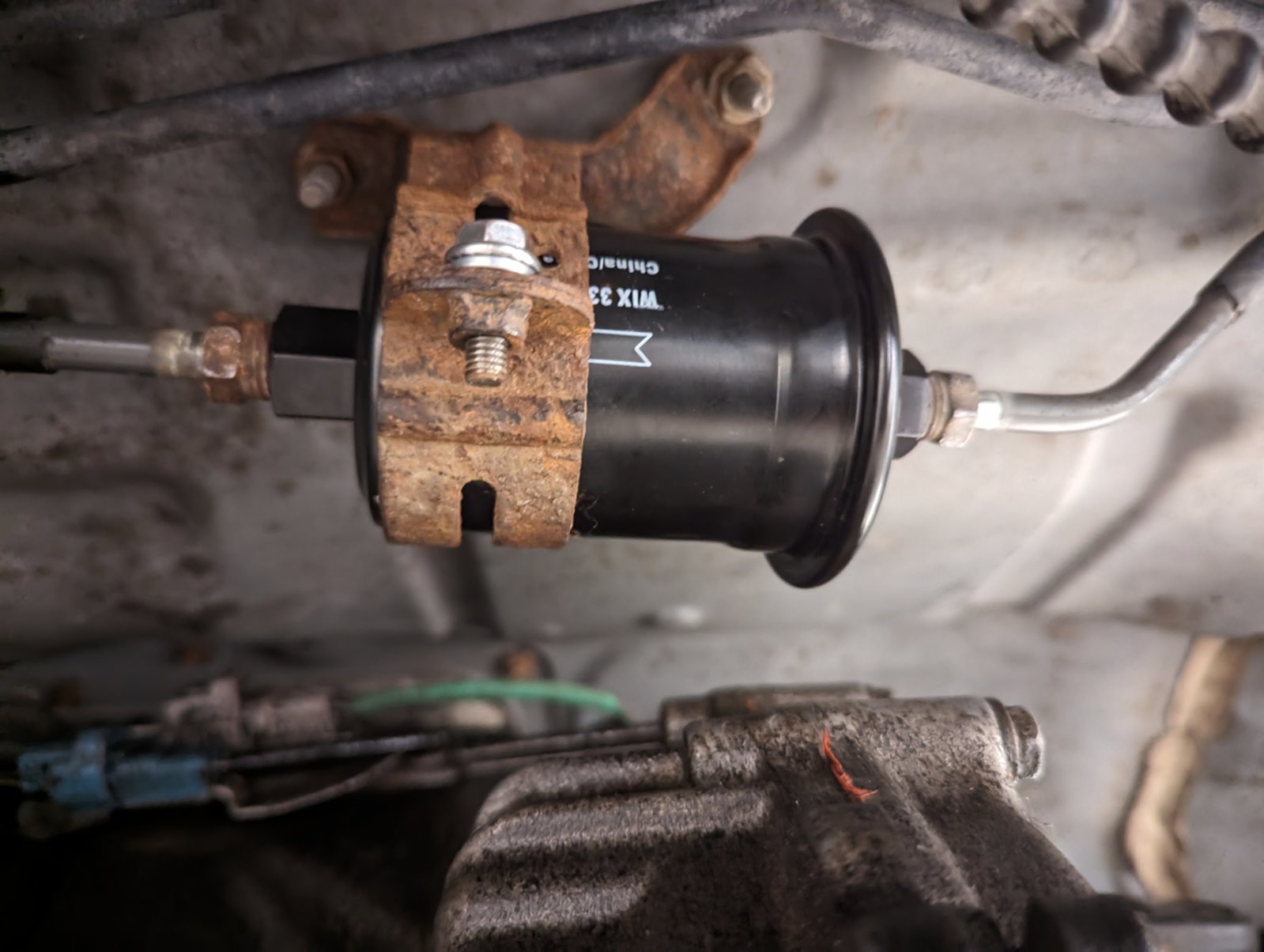

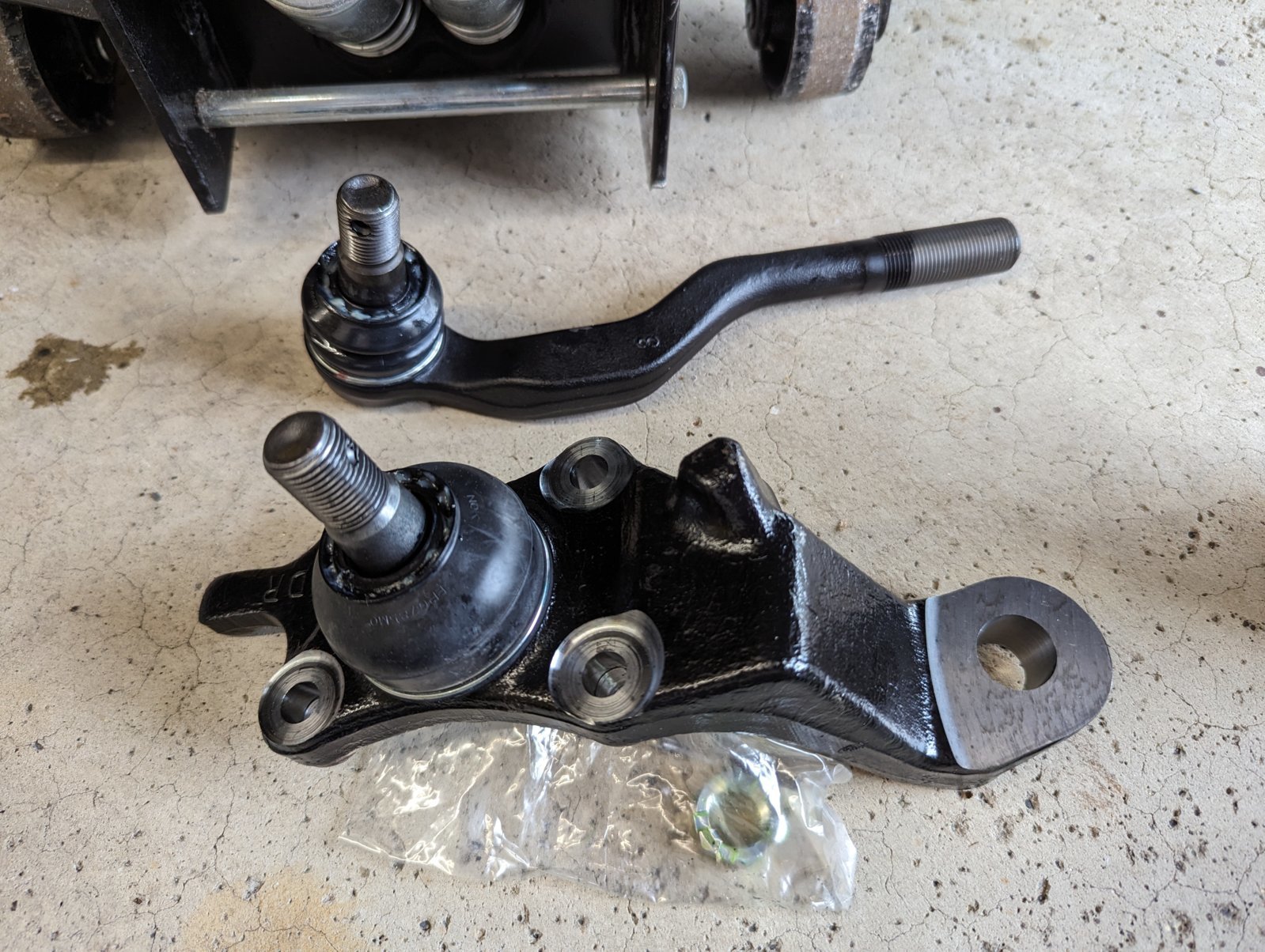

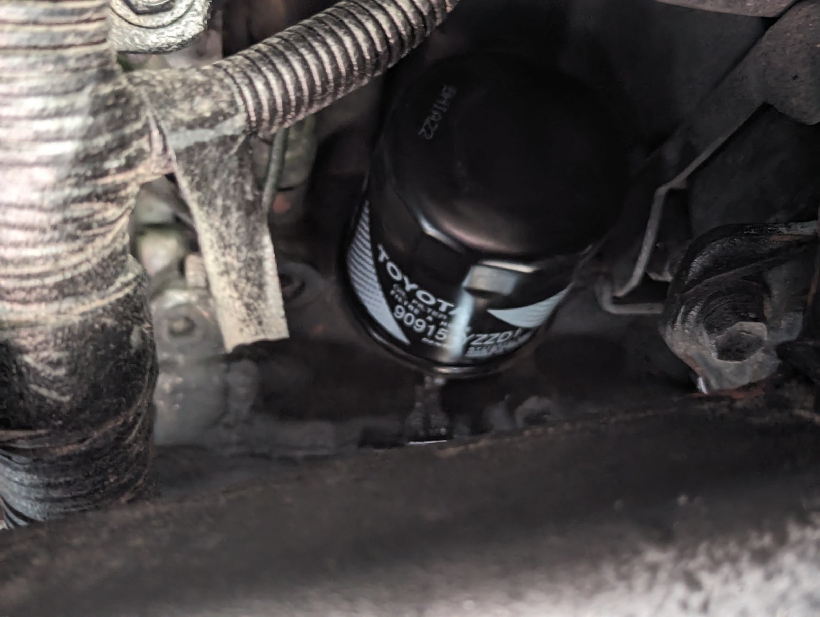

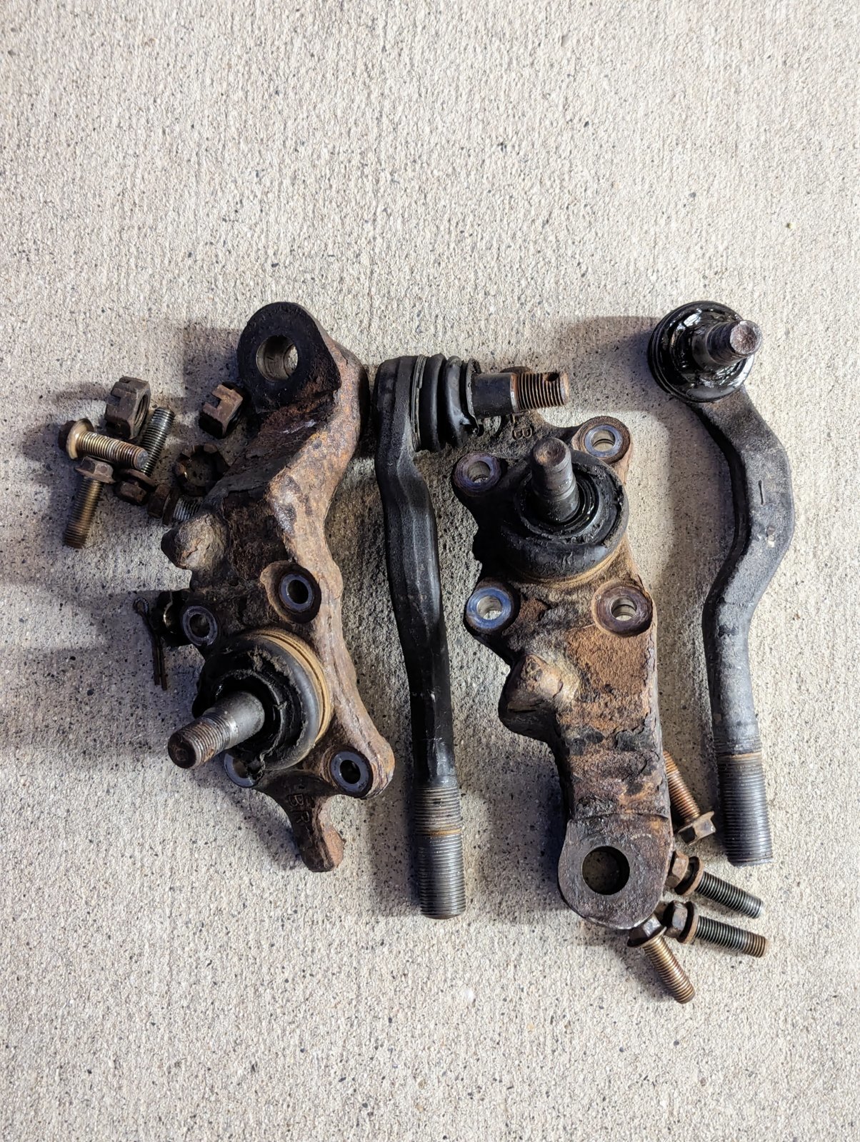

    Installed new lower ball joints, outer tie rods, fuel filter, PCV valve and did an oil change
  10. May 24, 2024 at 1:38 PM
    Lunar Mist
    Lunar Mist [OP] New Member
    Apr 13, 2024
    #447833
    Before I changed the fuel filter, the truck would crank for quite a while before starting.
    After installing the new fuel filter, the engine turns over and fires up immediately. 100% fixed the problem. :cool:
