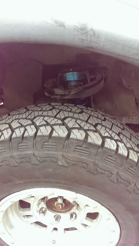

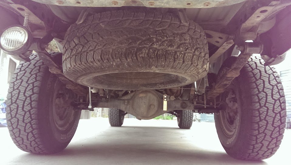

  13. Mar 16, 2015 at 10:00 AM
    #73
    quetzal
    quetzal [OP] Well-Known Member
    Apr 19, 2014
    #128011
    1,490
    Mario
    Long Beach, CA
    '02 XtraCab SR5 TRD 4x4 5spd
    All-Pro UCAs, King 2.5 C/Os, All-Pro Expo Leafs, Bilstein 10" Shocks
    Front: King 2.5 Coilovers stock travel (for now)
    Rear: Deaver F42 (7-leaf), Billies 5125, oem shackles and BPV relocation
    Still need to measure all four sides, might need to bring the nose up a bit and get it aligned. I couldn't get the upper (10mm) bolt loose on the brake extension so that will be next. I also have to measure my bumps before I install the 4.5" Energy Suspension bumps that I picked up a few days ago. Over all though, not a bad job for two poser mechanics with hand tools, a jack and stands. Thank GOD, we ran into zero rust/seize issues. And the rides feels like night and day! Also, no vibrations so far. :cool:
  14. Mar 16, 2015 at 10:46 AM
    #74
    Delta00
    Delta00 ᕕ( ᐛ )ᕗ
    Sep 16, 2013
    #112633
    4,137
    Troy
    Chandler AZ
    2002 Toyota Tacoma 4WD
    Check Build
    Nice! Truck looks good!

  16. Mar 16, 2015 at 11:42 AM
    #76
    neverstuck
    neverstuck Well-Known Member
    Sep 7, 2009
    #22406
    2,605
    Guido
    Lebanon
    13 DCLB sport
    slide-in camper, OME Nitros w 884's and Dakars, Michelin A/T2, Pro EFX heated towing mirrors, Timbren HD bumpstops, KB VooDoo bed rails and tailgate cap, ImMrYo rvm bracket, G-Tek Fab door sill protectors, Ultragauge, window visors, hood deflector, Wet Okole seatcovers, in-vehicle safe.
    Very nice truck.
  17. Mar 16, 2015 at 11:50 AM
    #77
    quetzal
    Apr 19, 2014
    #128011
    1,490
    Mario
    Long Beach, CA
    Thanks! I couldn't get the damn top nut (10mm) loose on the brake line. I was careful NOT to over stretch that brake line. I still have to get to that.
    Thank you bro! I couldn't be happier.
    Thank you!
  18. Mar 16, 2015 at 12:01 PM
    #78
    synergy10
    synergy10 @synergy10.sd
    Mar 28, 2013
    #100826
    1,368
    San Diego
    Yeah, that nut is a bitch to get to. I just did the Tundra brake upgrade weeks ago and went with Wheeler's front brake lines and rear extended line. The lines took the longest to do.
    Did you try spraying it with some liquid wrench/pb blaster/wd-40?
  19. Mar 16, 2015 at 12:08 PM
    #79
    Delta00
    Delta00 ᕕ( ᐛ )ᕗ
    Sep 16, 2013
    #112633
    4,137
    Troy
    Chandler AZ
    Check Build
    Did you try removing that bracket that is held on by two bolts? It lets you get your flare wrench on the nut easier and allows for more rotation.
  20. Mar 16, 2015 at 12:32 PM
    #80
    quetzal
    Apr 19, 2014
    #128011
    1,490
    Mario
    Long Beach, CA
    Tundra brakes you say? Wow, did you get a new front bumper w/a winch? What about your rear, are you planning on doing a disc conversion?
    NO - I didn't spray anything. I was about to spray it w/PB Blaster but chickened out at the last second cause I didn't want to ruin anything. It's safe then ha?
    No, I didn't do that either. BUT, I will. Do you think that I can do it w/o having to lift and/or remove the back tire?
    Thanks guys!
