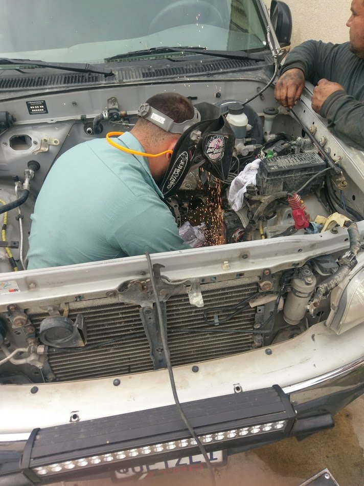

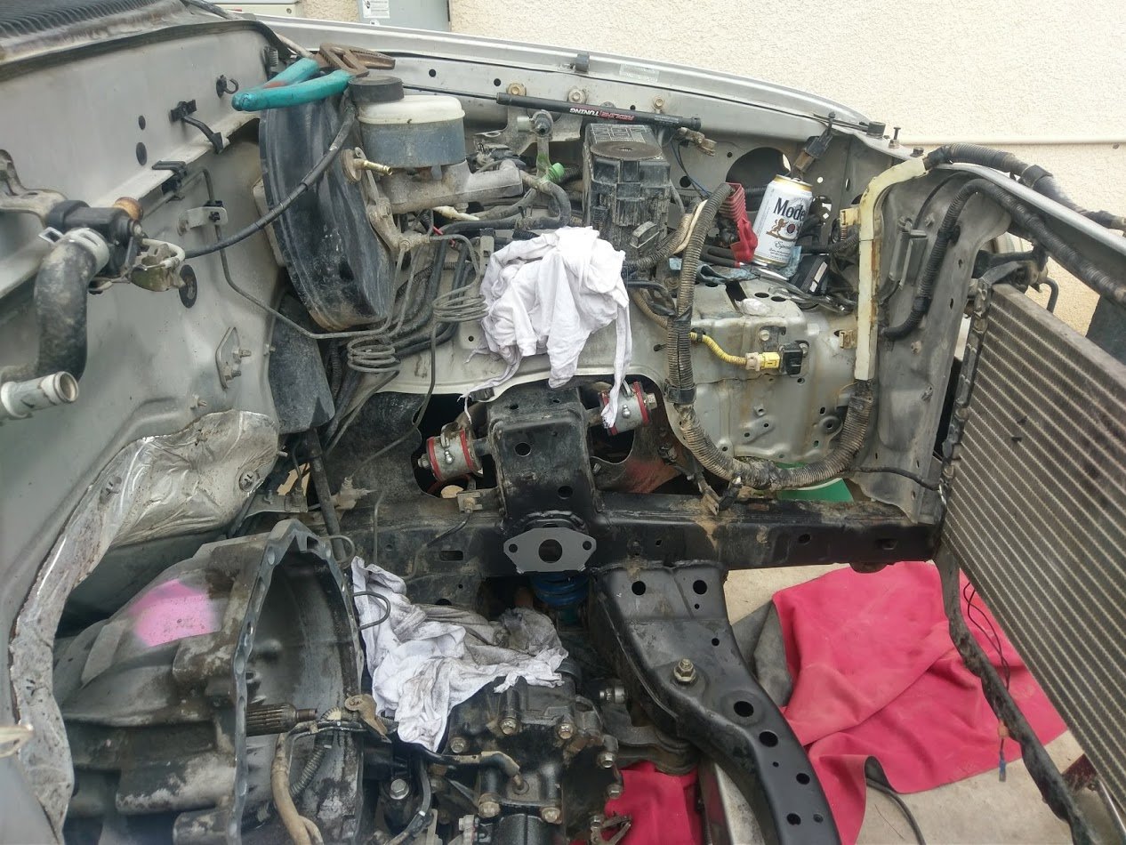

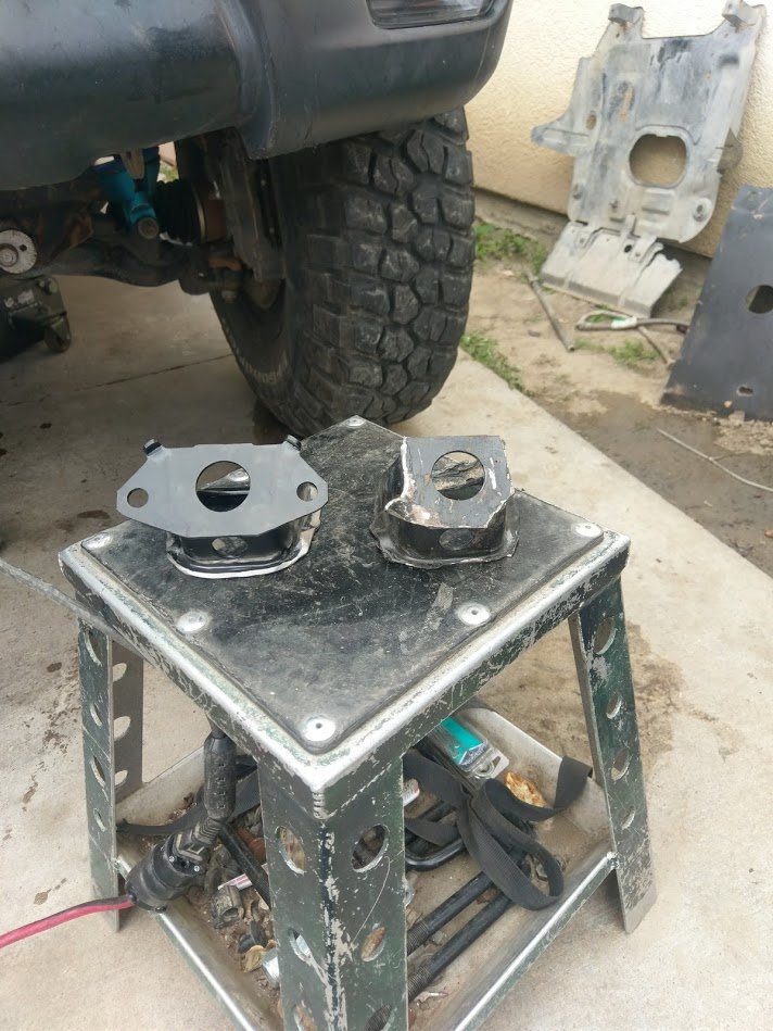

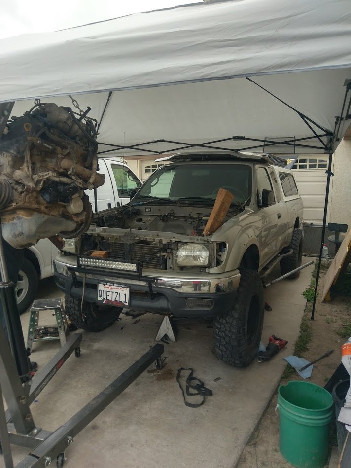

    I haven't posted here in a while. So a few weeks ago I broke my engine purch (Drivers side) which meant pulling the engine to repair. Boy oh boy, what a task right....thank God for my buddy @GRIZZLY714 . While the motor was out we went ahead and replaced the timing belt and all associated parts as well as replacing the valve covers gaskets. Check out some of the pics.OWyaMGol0su1aawsVBzsb1KzKezf7wQv3oEBo3gf_8e4260e14b8dab991455963ddcb0398c33fc0edb.jpg

    @quetzal How did that happen? Did you jump your truck or something? Is it all put back together now? Also, good idea on getting some of the maintenance done while the engine was out.

    220k on the odo is about all I can say. The mount was likely broken and I just never noticed it. So it gave until it couldn't give anymore, at which point it just broke off the frame. Yes, all good now!

    Uh oh, I'm at 224k+, I'm going to take a closer look at my mounts the next time I get a chance.

    Yea bro, I hope my experience helps you and others to check your mounts. Especially as our miles begin to creek into the 200k.
