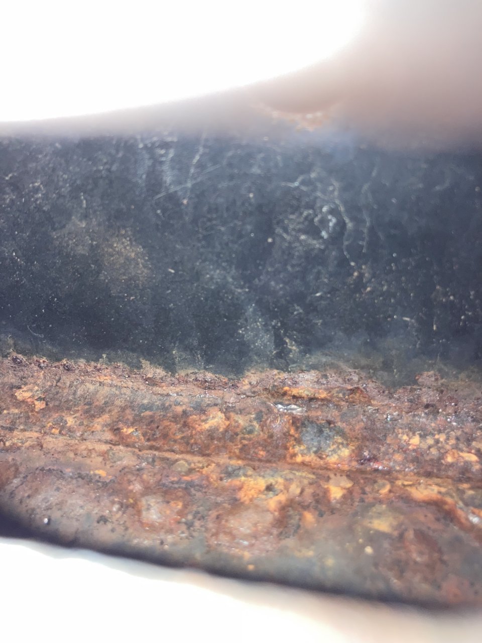

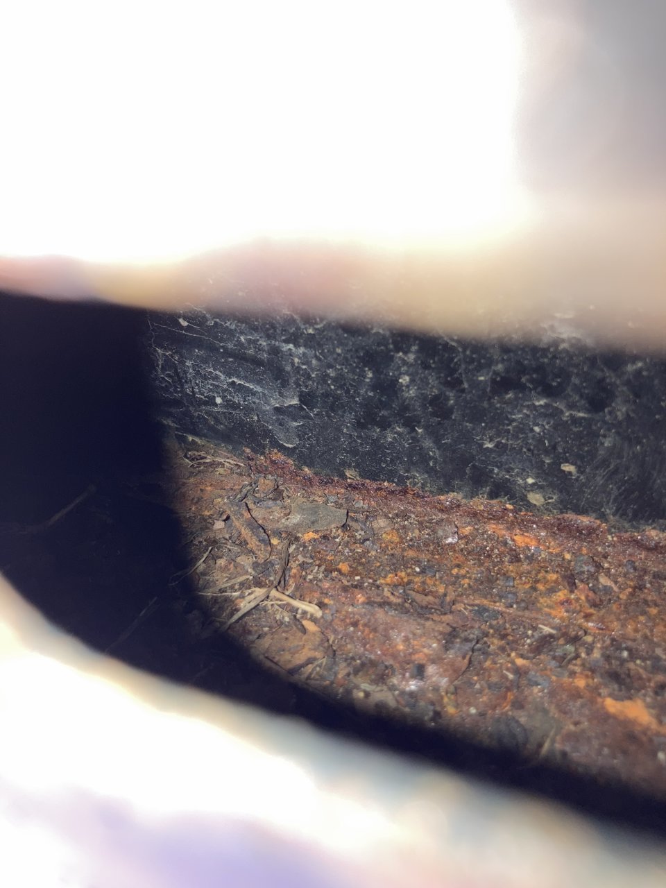

    Yeah I bought most of the products to do the underside along with the frame. Product called "Krud Kutter The Must for Rust" rust remover and inhibitor. I also bought Eastwood Internal Frame coating. Its a Phenolic Resin with zinc additive. Was planning to use the rust remover on frame and underside but wasnt sure if I should use it inside the frame first before the eastwood product. Eastwood internal frame coating states "Converts, encapsulates, and seals rust on internal frame surfaces"
    As far I can tell the frame rot isnt completely through on any spots just seems to be surface level. Here is 2 pictures of the inside of the frame. Obviously hard to tell from pictures but gives an idea. I did wash the entire inside of the frame out with a hose not too long ago. Just have not had a chance to start on the rust conversion/removal or internal frame coating.

    I'm not so sure adding any paint or rust converter to the inside is worth it. I am personally planning on just soaking the inside of the frame with fluid film. I think rusty metal soaked in oil will be stable for a pretty long time and probably hold up just as well as converted and painted, maybe longer? You definitely should hammer test and wire wheel the worst spots to see how bad it is and try to remove what you can.
    I had a really rusty rear differential that i wire wheeled/hammered scale, put on multiple coats of rust kutter (phosphoric acid) that converts rust and then a couple coats of black spray paint. If I didn't care about looks then I probably would've just done rust removal and fluid film. I used a rust converter because I wanted to paint it and was hoping to minimize the amount of rust progression underneath the paint. See my thread below.

    It's not great, but we've seen worse here. In addition to the hammer test, I'd probe the rusty spots with a pick or screwdriver to see if any of those rust spots are actually holes. If the frame is still relatively solid, my suggestion would be removing the bed and grinding down as much rust as you can and then paint with something like POR15 or the Eastwood Chassis paint. Check the rear diff breather to make sure it isn't rusted solid, might be better off just replacing it. You're missing the gas tank skid, and I'd probably replace the leaf springs as well.
