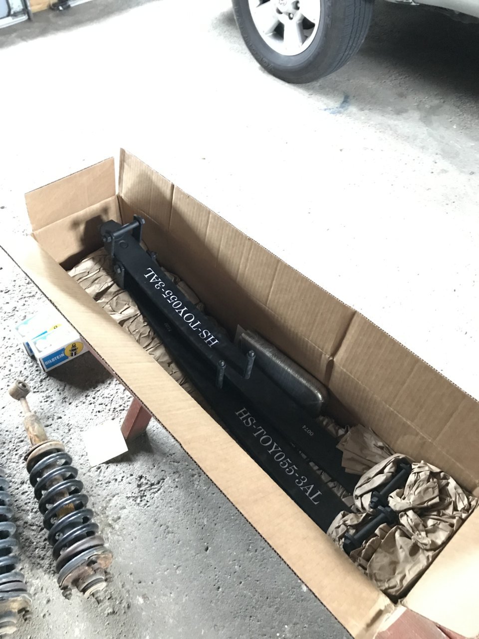

    Yeah the Headstrong 3 leaf AAL should be here tomorrow. Probably won't be able to tear into it until Sunday or Monday.

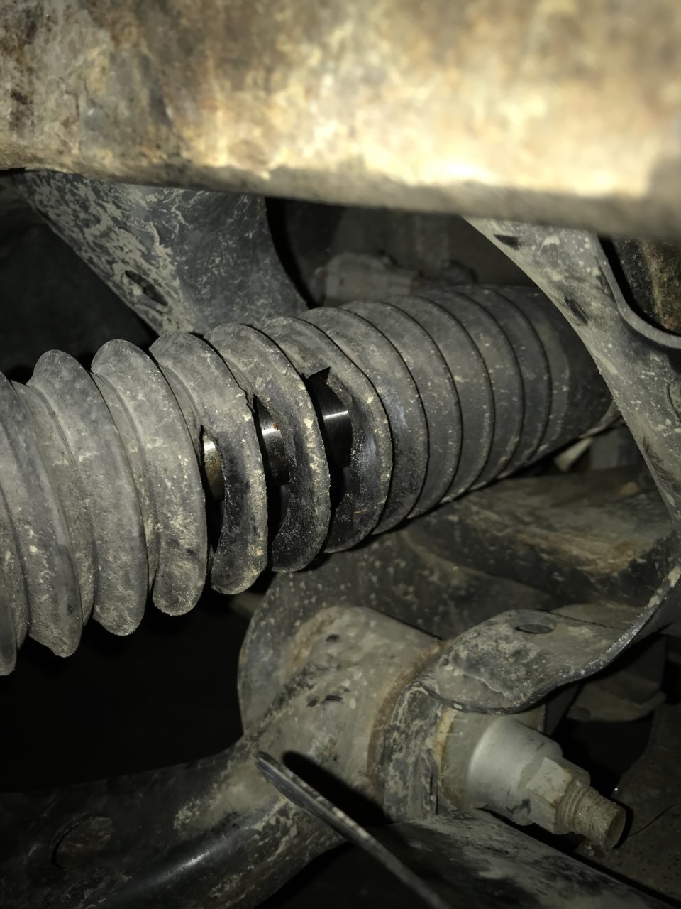

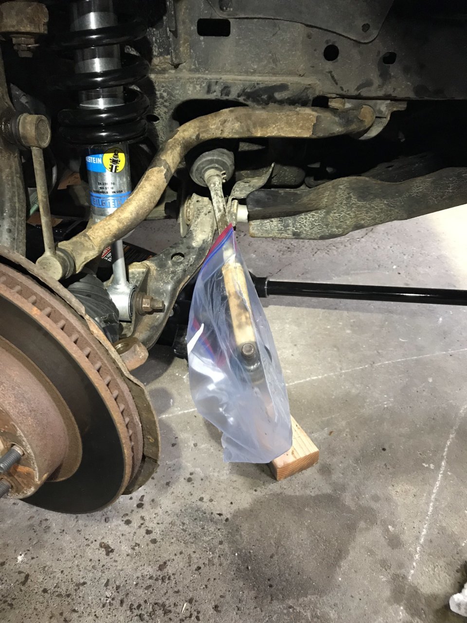

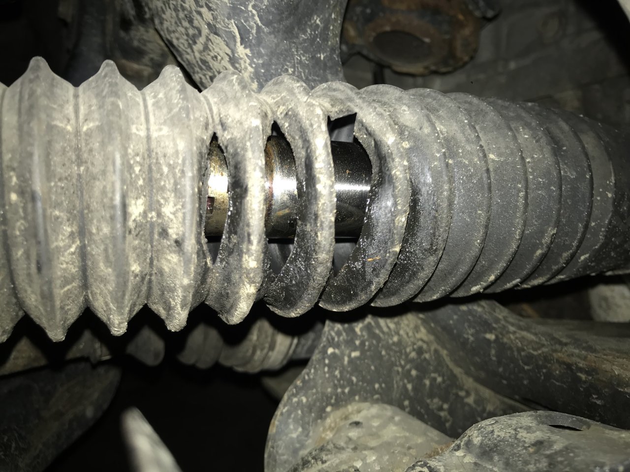

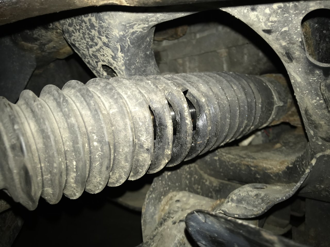

    Oh, I also noticed today that one of my tie rod boots is torn.. So there's that.. On first impression it looks like that is a PITA to change cause of the whole taking the tie rod apart to get the boot on part.. Might as well get that done before I get my alignment.

    Like torn on your steering rack? Or on the outer tie rod?

    Just ran out and checked.. Didn't realize the other end of that boot was connected to the rack.. :bananadead:
    Ouch....

    I’m sure there are replacement boots out there! Just gotta do a little digging.
    • Separate outer tie rod from spindle
    • Undo clamps on torn boot
    • Replace with new one
    • Reconnect outer tie rod to spindle.

    Just arrived!

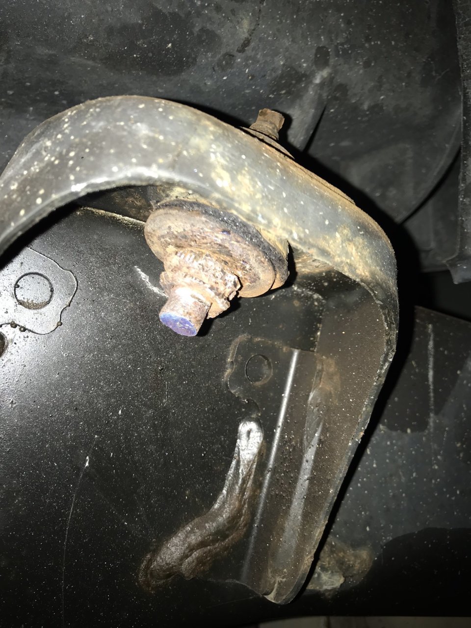

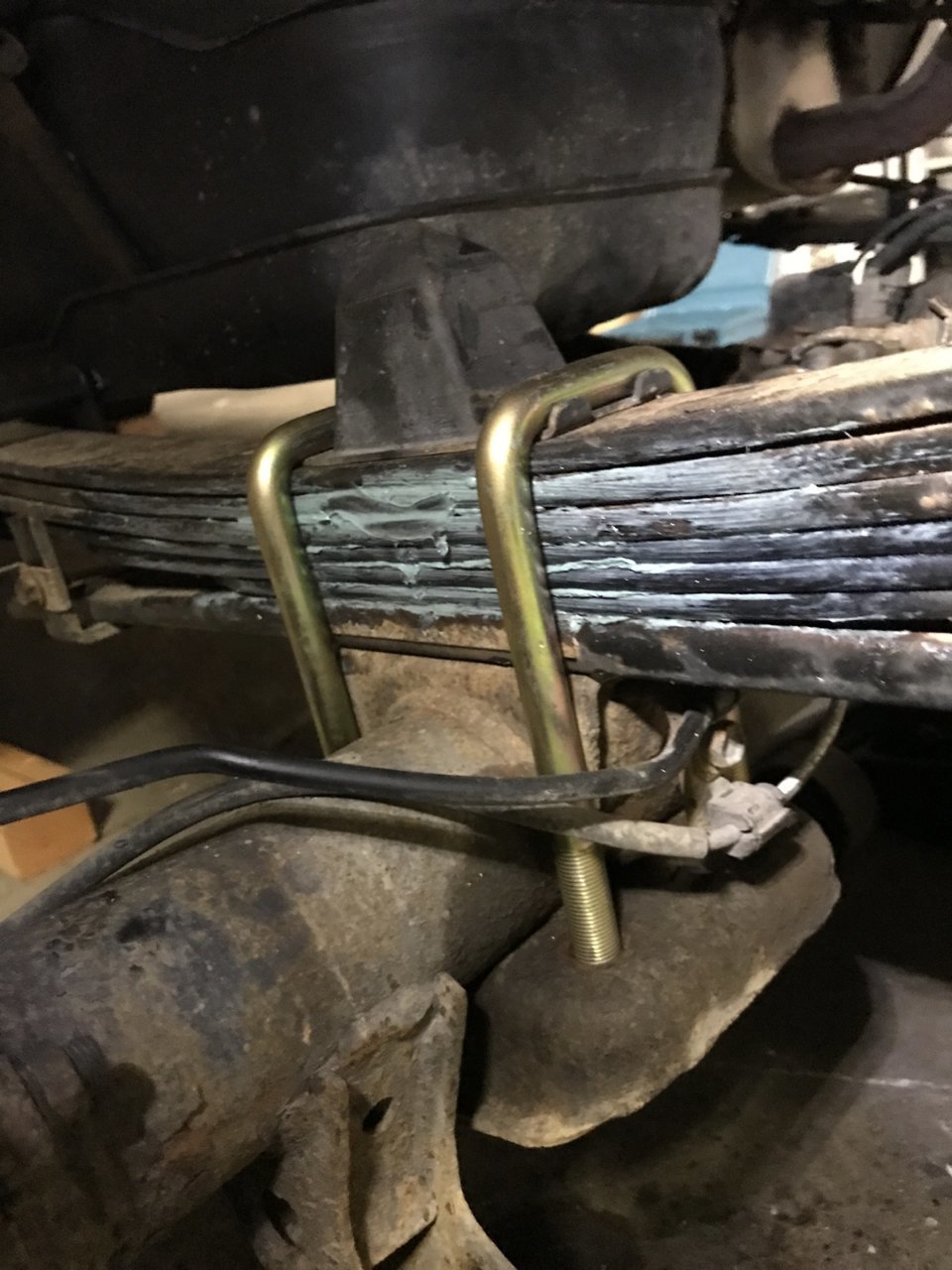

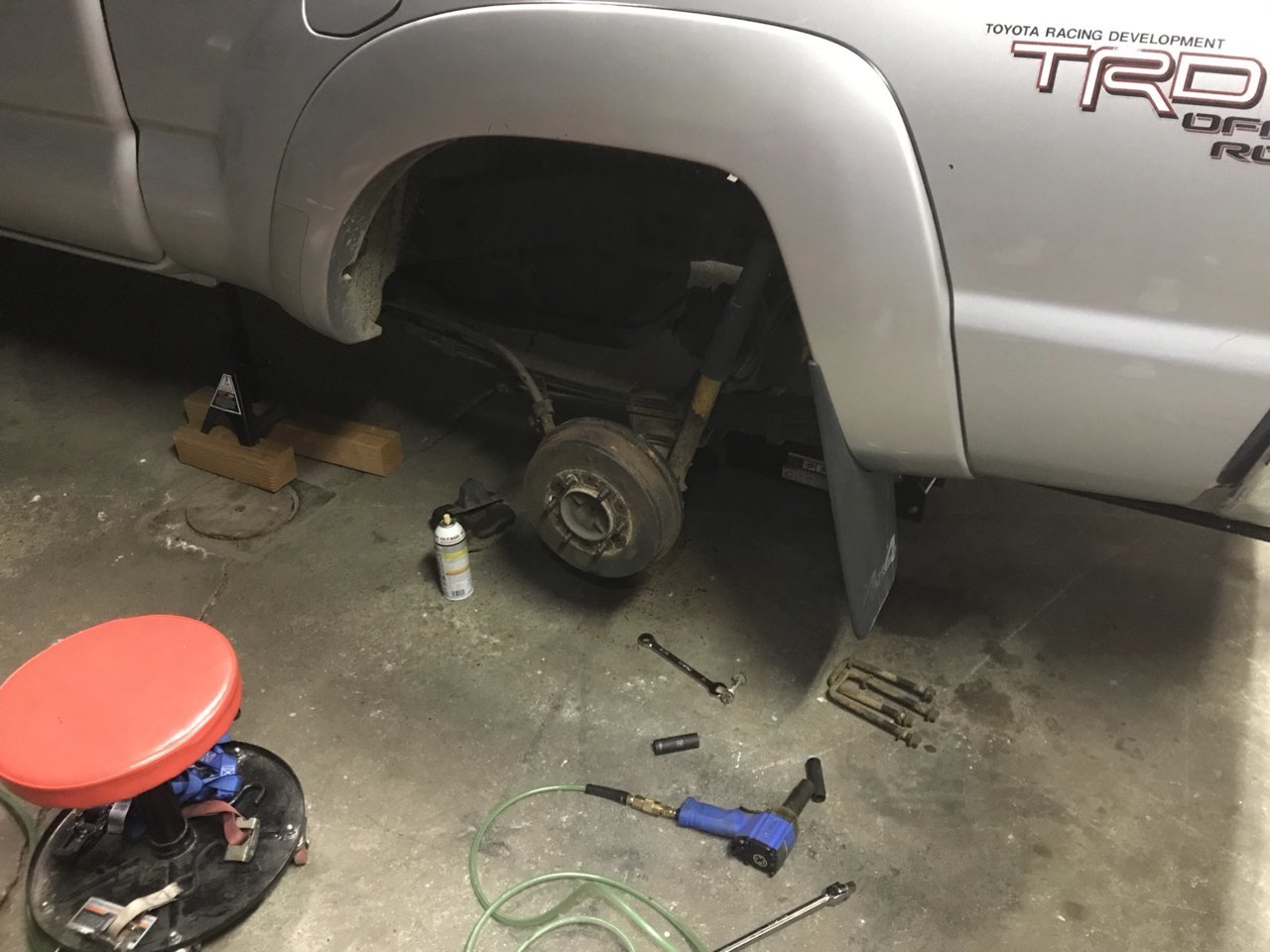

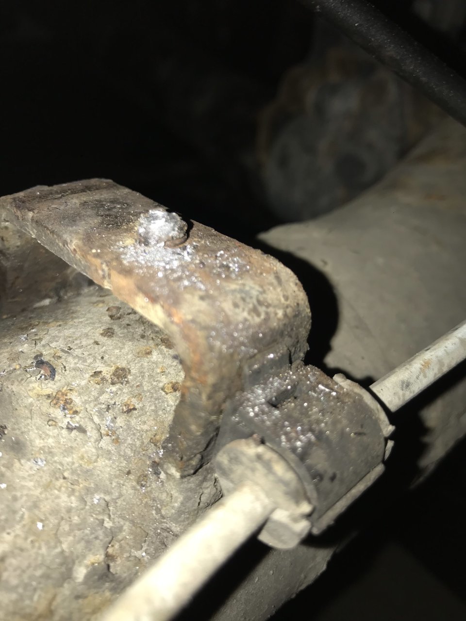

    Installed my Headstrong AAL tonight. Everything went smoothly with the exception of a few rusted nuts/bolts. Both of the upper shock mounts were permanently joined in rusted matrimony.. Eventually just grabbed and broke off the shock and the remaining top part just popped right off on the drivers side. Was pleasantly surprised. Tried for the other side and not so lucky. The collar below the frame mount was also corroded to the shaft so I’m going to have to cut with a hack saw tomorrow. Need it also to cut the new longer leaf pins.
    Will have to get creative extracting this broken bolt..
    EatSleepTacos likes this.

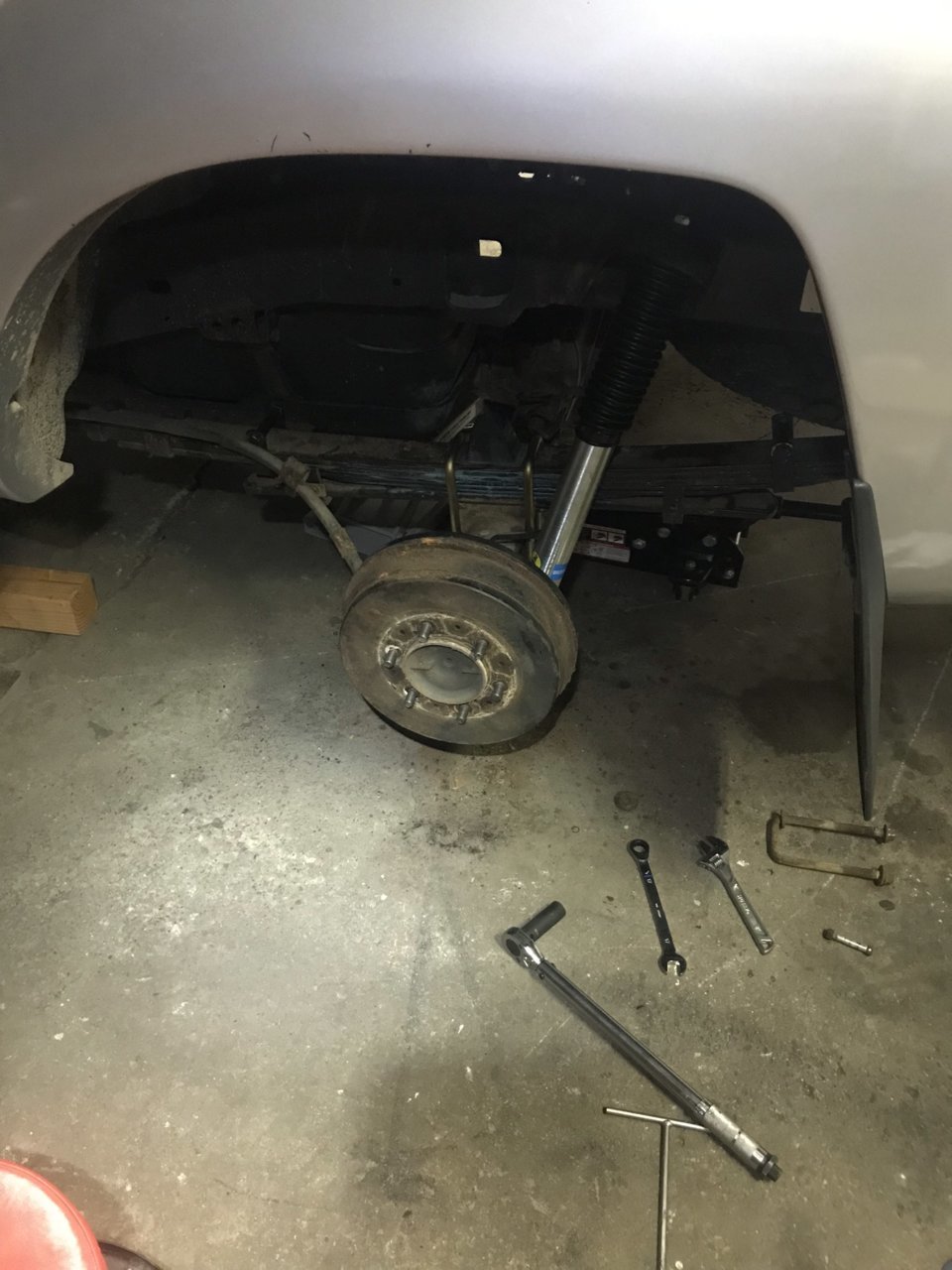

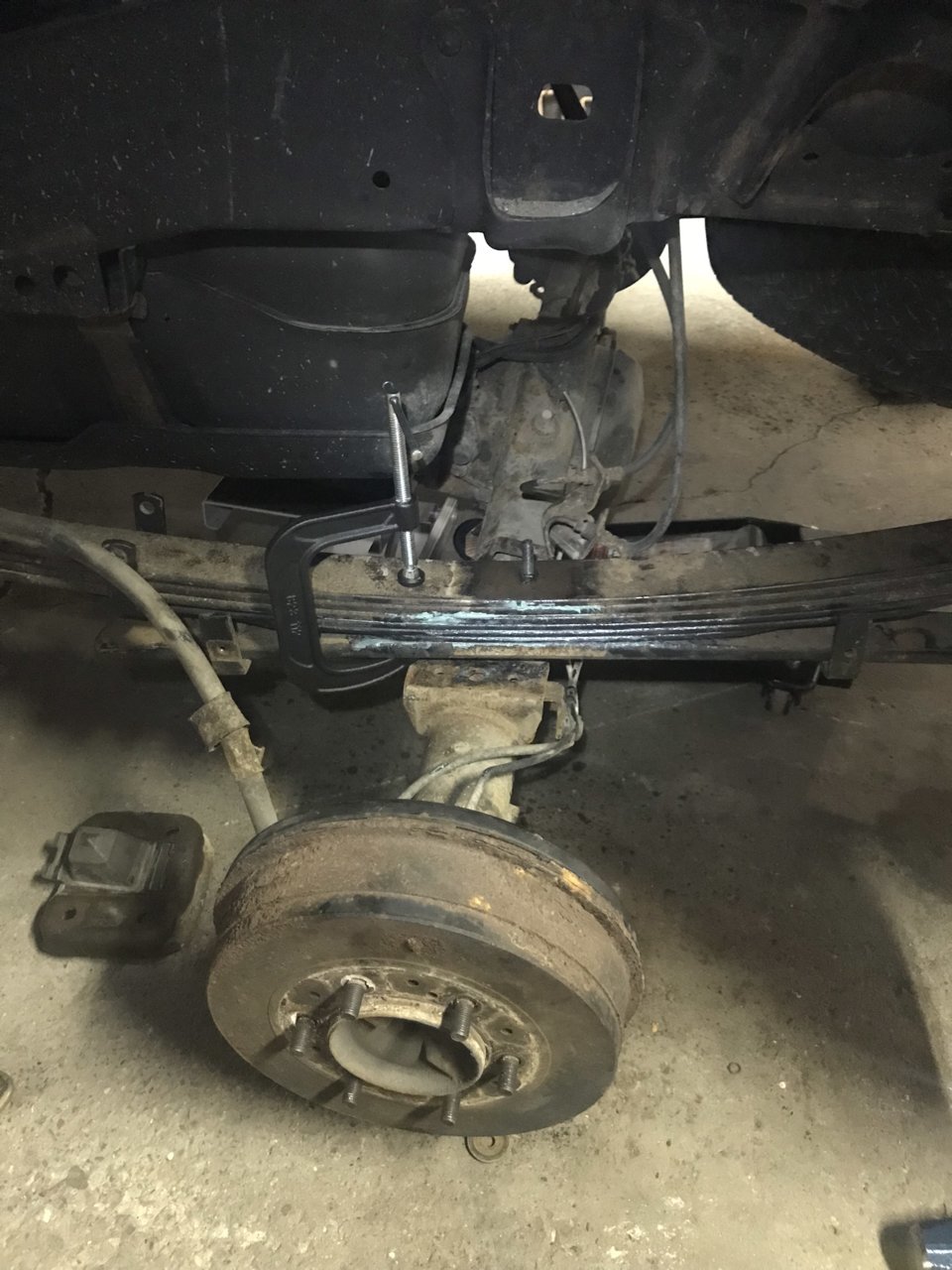

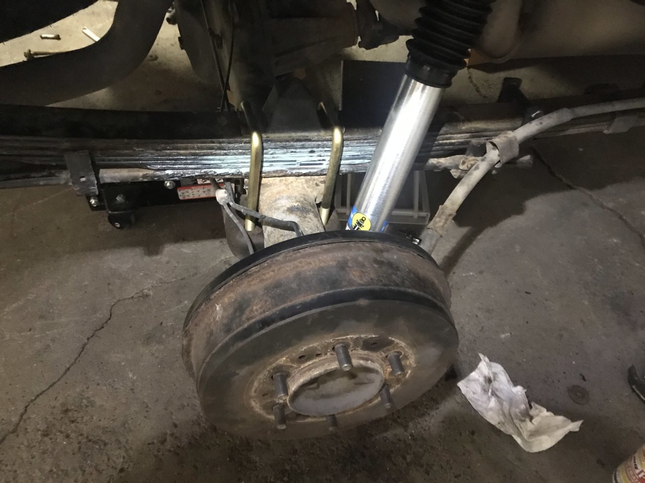

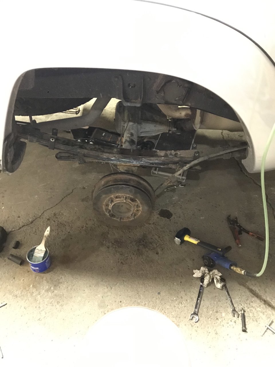

    Ok, time to update from last month. Here’s how I made out with the rear. I got my hack saw and finished clamping everything down.
    Ended up taking my vibrating multi tool to what was left of the upper shock. 9C5CE3A7-801B-4172-A7CE-13E7AF489B83.jpg
    All back together:
    As for my broken bolt, I just drilled a hole into what was left and through bolted it. Problem solved.82273B8D-4FBC-4BA4-A646-ABA52A7084F8.jpg
    Really please with how it came out!
    Before:
    After:

    Fixed my torn steering rack boot and the grease trick did not work.
    I ended up just counting the turns on the tie rod end and it worked out fine. Brought it in to get it aligned and had a shop install the ECGS bushing. I did have some decent vibration at around 25-30mph after lift and that seemed to fix it.

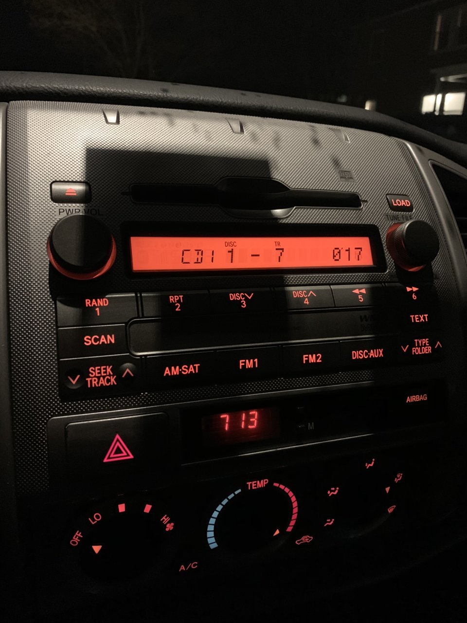

    Added one of those Bluetooth adapters to the CD changer port in the back of the stock head unit. Works great!
