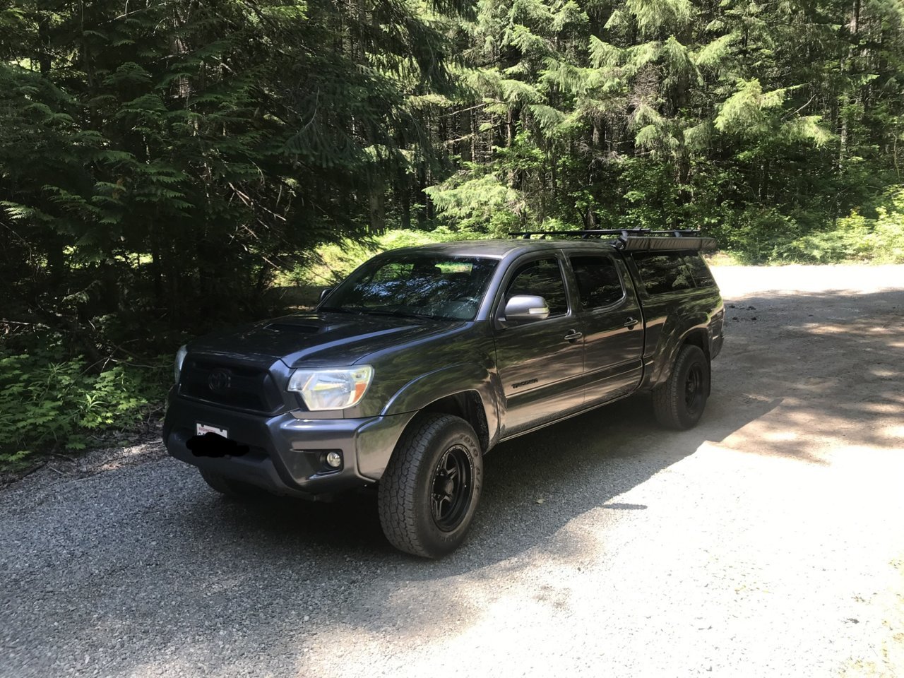

    Pretty hyped. Been hunting and lurking for a long time. Used to have a 99 4runner. Bought locally, 125k, single owner who did everything at the dealer, even light bulbs. 125k on the clock.
    Planned use is mostly for camping and exploring with the lady and the dog. Eventually will want t do some of the BDR's or some sections here and there.
    Super clean but needs a few things: light behind fog light switch and a few other on the left side of the dash are dead. Rear passenger window won't go up from the rear switch, but handily rolls up from the front. Need an AAL in back as the previous owner has stock suspension with a cap and drawers. I've added a heavy old hitch bike rack and an awning and shit in the back. Want the back to be popped up a bit. Also is in need of some new tires soon.
    I think I'll start on the small stuff, do an AAL and tires, then do a true lift sometime in the future when I'm in need or after adding a bumper/sliders.
    Did some searching, and I know a whole leaf pack would be better, but can I do an AAL without changing struts?
    Will post some more pictures later. Hyped to have such a great resource here.

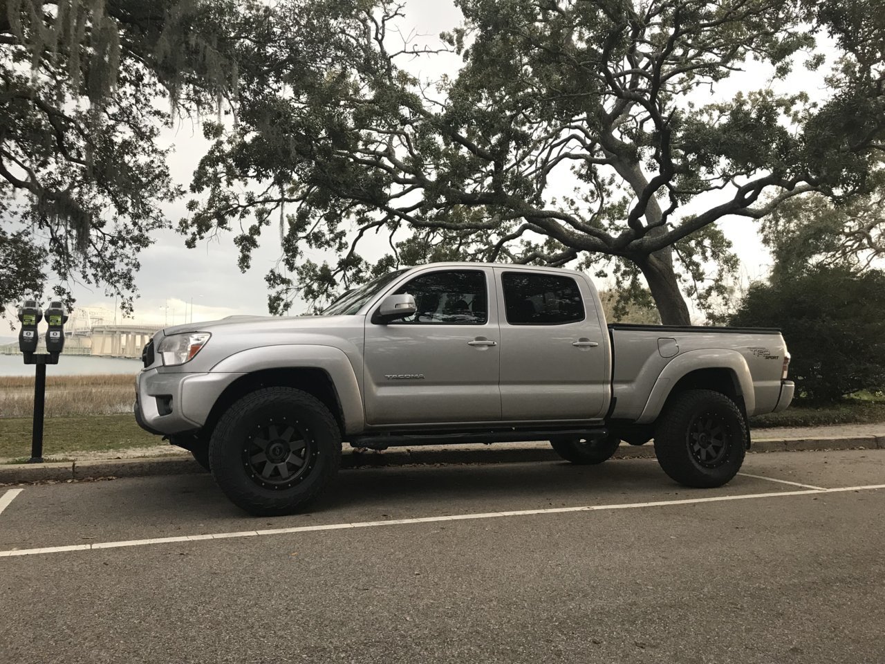

    Rough Country 3.5 Lift SCS BR6 wheels rolling in 285/70/17 Falken Wildpeaks
    I love my 2012 DCLB. Long Bed Rules!!
    Bought mine used in 2015 with 32,000 miles. Going strong at 169,066 miles later.:burnrubber:
