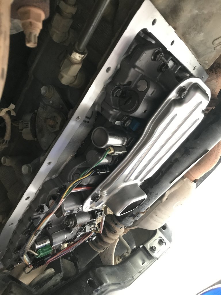

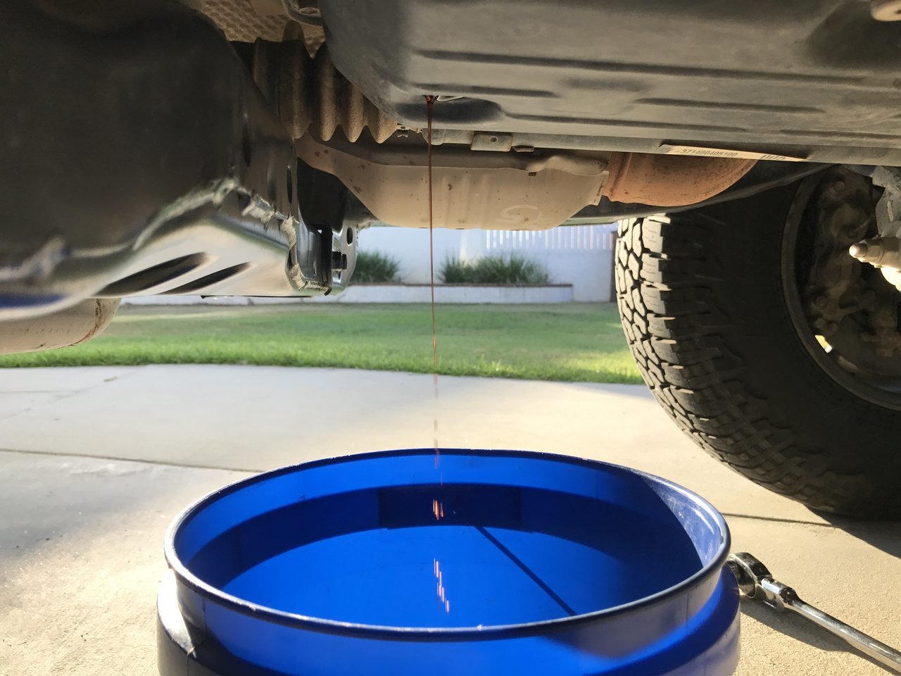

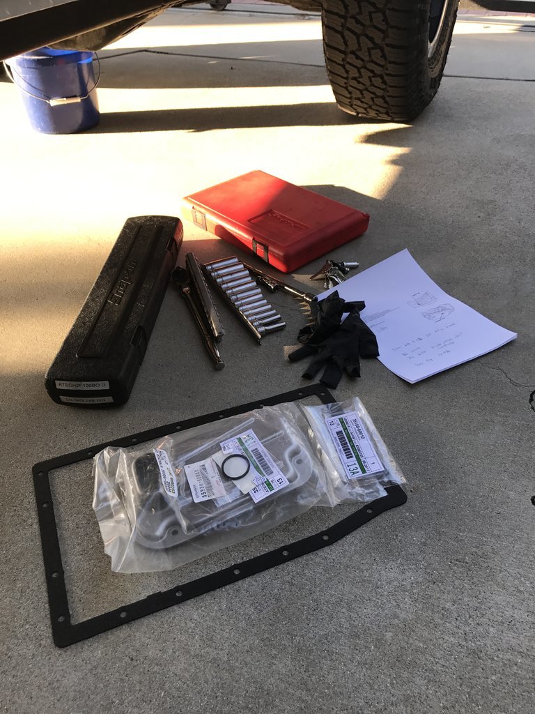

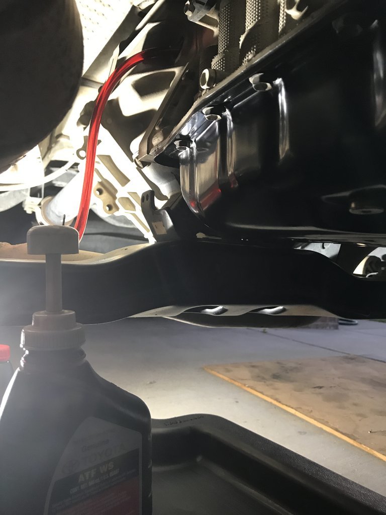

    Alight guys I'm coming in picture heavy. Used vehicle purchase 101. Change all fluids, regardless of condition of vehicle!

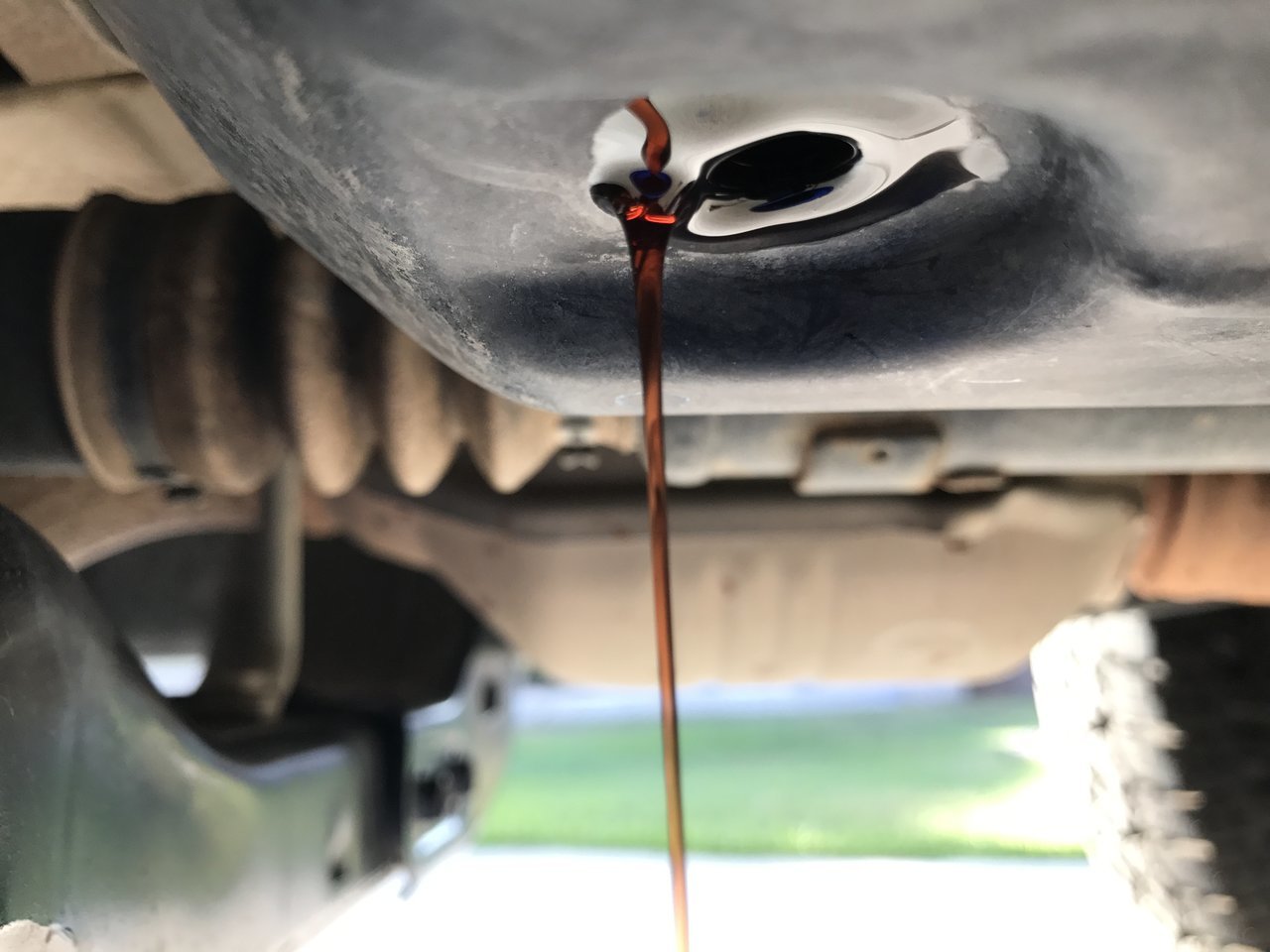

    Broke the fill bolt loose first and then took the drain bolt off, drained it into a bucket to measure how much came out.
    The fluid that came out wasn't the best and wasn't the worst.

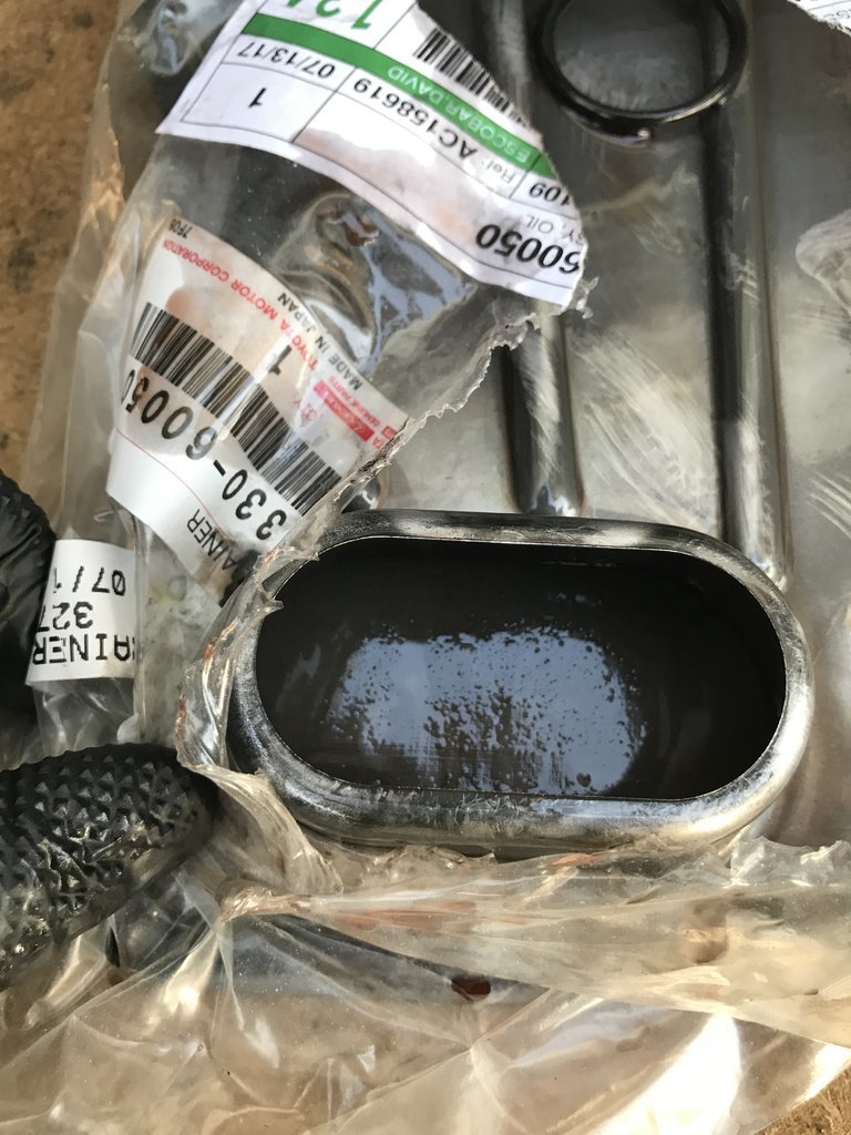

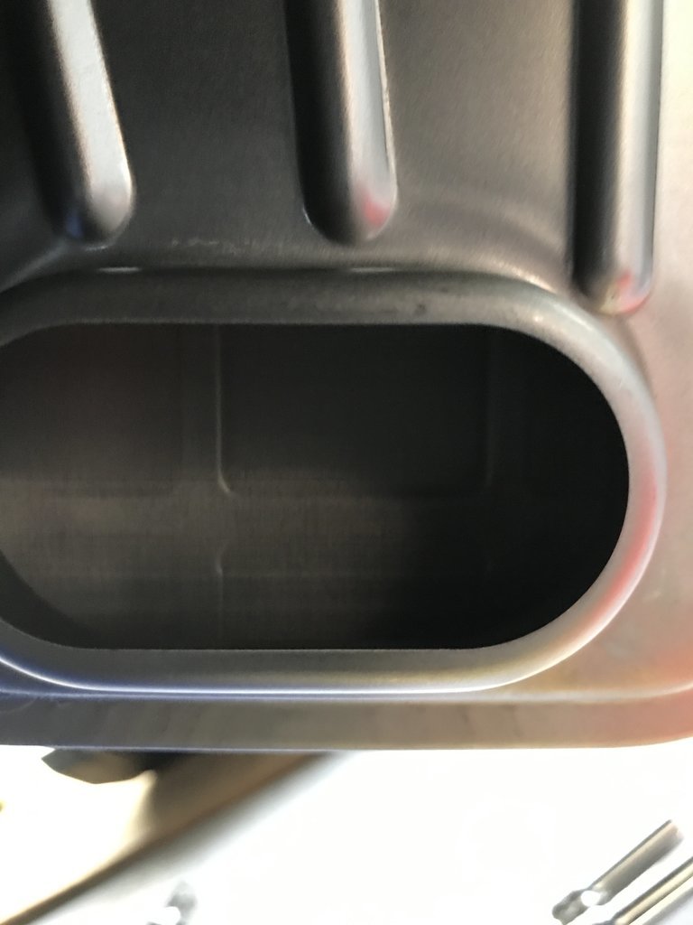

    Very dirty original filter that came out!

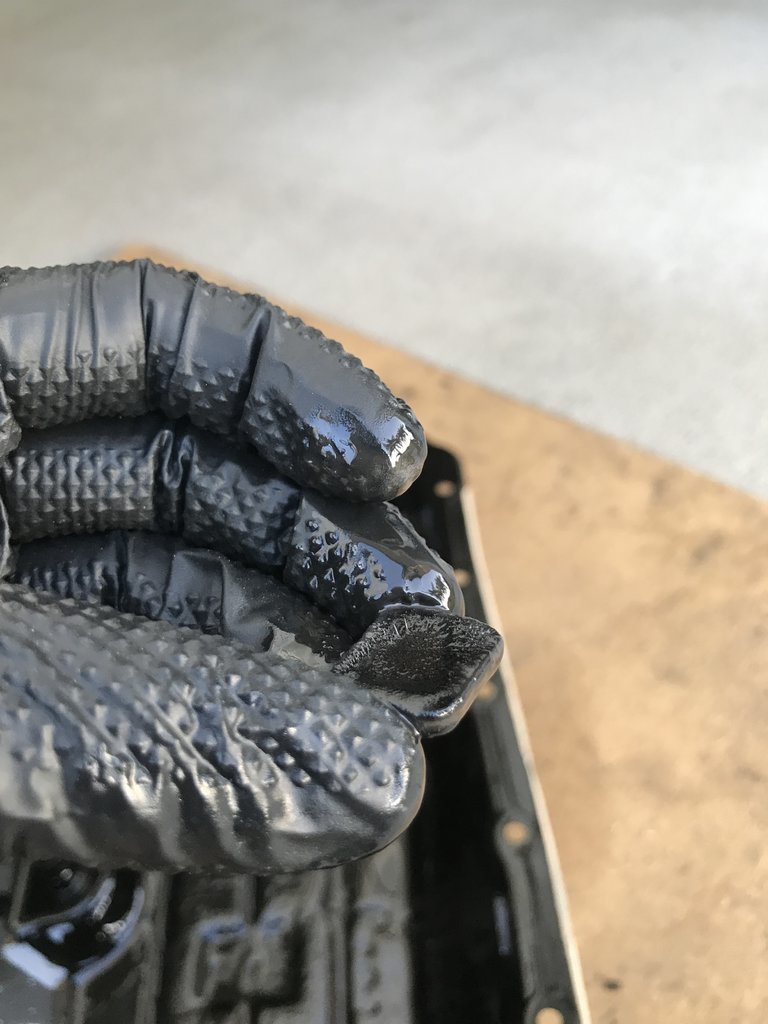

    Magnets all covered in small shavings (I knocked the center magnet off while removing pan).

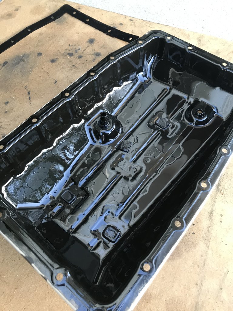

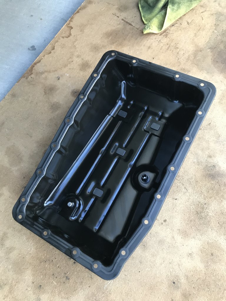

    Pan cleaned and scuffed the edge with scotch bright so the gasket sealed properly.
    New clean oem filter!

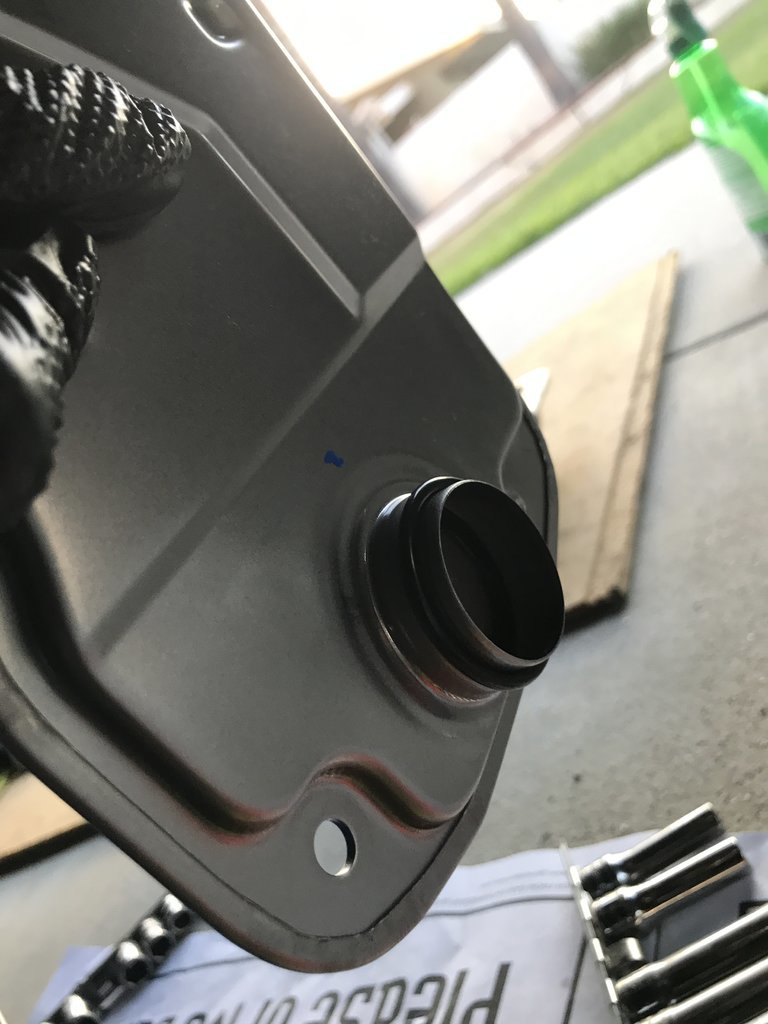

    O-ring installed and rubbed with clean trans fluid.
    Scuffed the trans with scotch bright and installed the the filter.

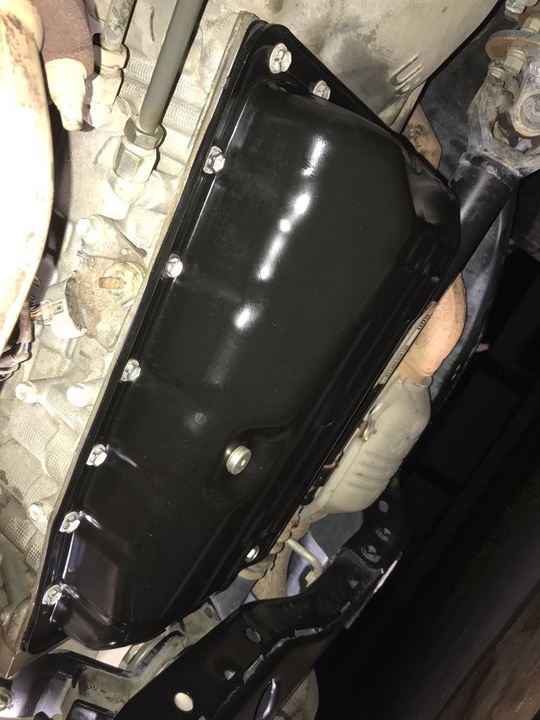

    Pumped new fluid back in (takes forever).
    Clean pan and fresh fluid!
    I drained 4.5qts and only bought 4qts so I didn't open the overflow port and wait for fluid to come out. Just started it and ran through all the gears. Once it got to operating temp I shut it off. Going to pick up another qt tomorrow and finish topping off the trans.
