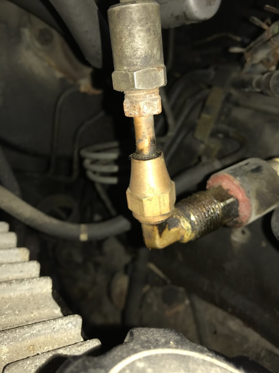

    Can you get a better pic of the of the fuel rail side? I can confirm for you. But the last pic; the smallest Npt fitting is stock.

    Here's a better pic of the fuel rail side

    Geez what a mess.
    It looks to me can pull that crap out of there. Assuming the stock line threads are good. Use flare wrenches so you don't have heart ache later.

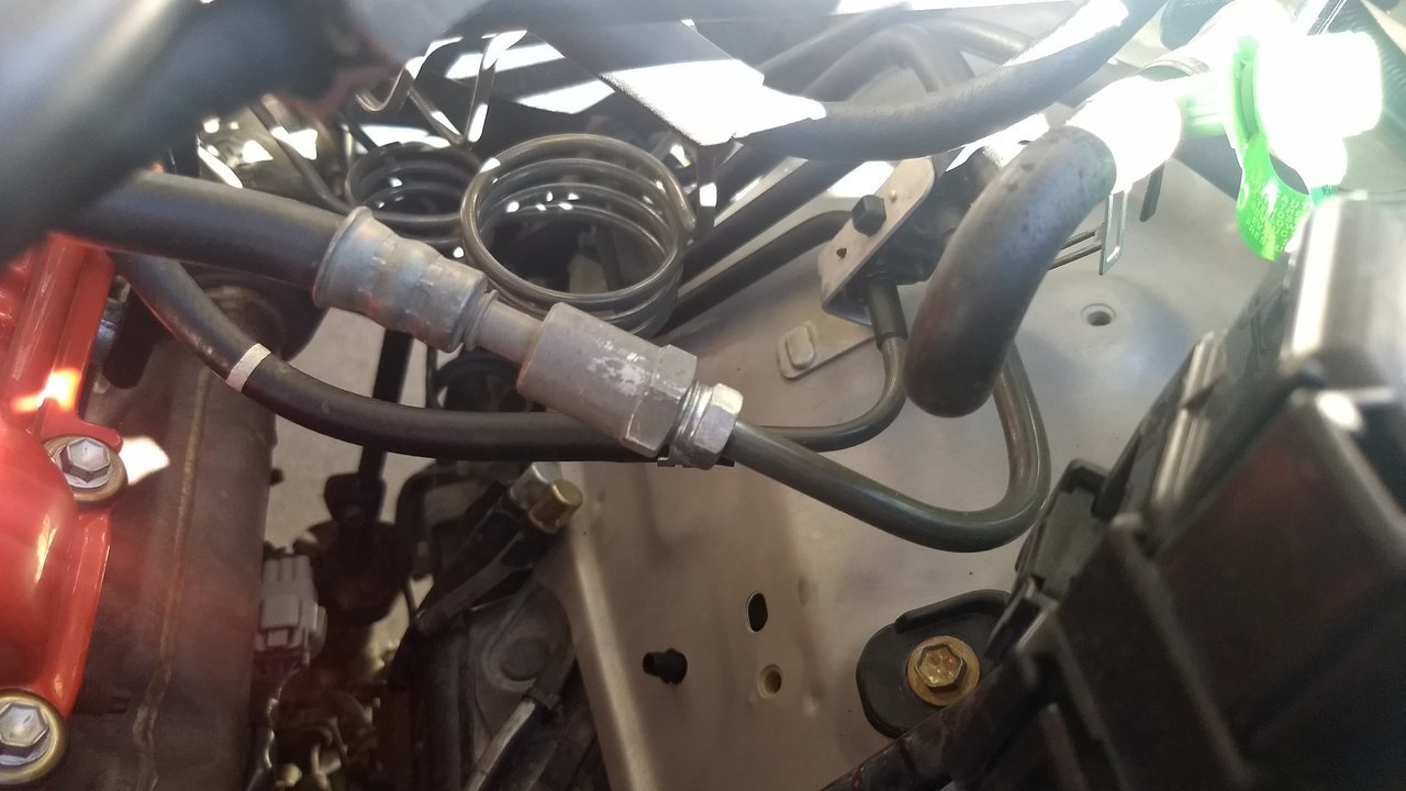

    Here's mine:

    Update. The gizmo was actually a check valve put in due to the original in the fuel pump failing.
