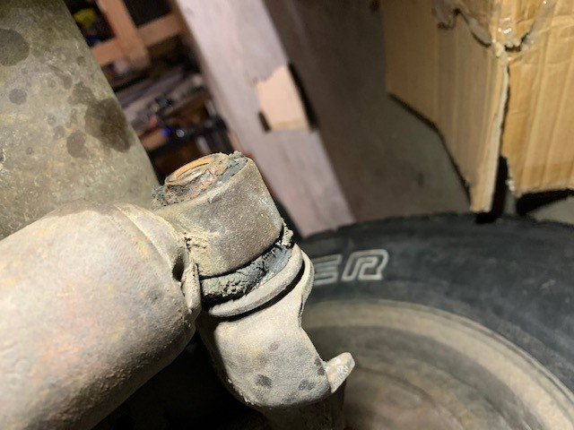

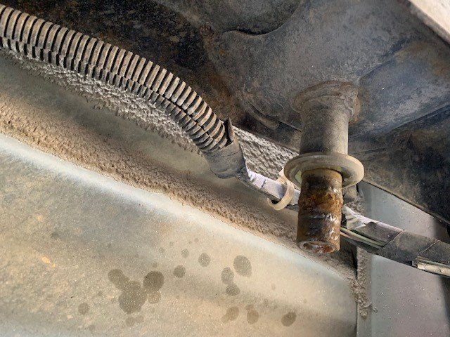

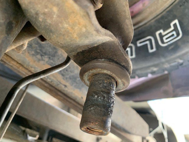

    got the left side off but the mounting rod is pretty gunked up, any suggestions on how to clean this up so the new ones slide on? degreaser and wire brush?

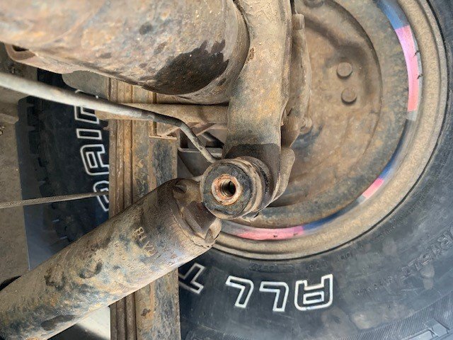

    the right side is a pain, any ideas on how to get these suckers off?

    Welcome. To get the stuck one off you could try a pry bar between the shock and the bracket or just remove the tire and hit the shock with a hammer. For cleaning them up the method I would use is a half worn out or 180ish grit flap disc on an angle grinder but a putty knife or a wire brush should work if the post is not deformed. If it is then you probably want to go the grinder route. Be careful to just dress it and not to remove to much material.
    As for lube I use super lube for suspension parts and brake pins.

    You could try heating it up with a torch and wiggling it off while grabbing it with a pair of adjustable pliers.
    Edit: Ohp, nevermind. Haha I thought that was the bushing that was still stuck on there. Never seen one get all deformed like that. I would probably use a file or a flap-wheel disc to take off the extra material. Be careful if you use a grinder not to take off too much material. That would be no bueno.

    thank you all for the input. i might have to take the rear right tire off and go to town on it with a hammer. as for the mounting rod i am thinking degreaser and a wire brush attachment with the cordless drill.
