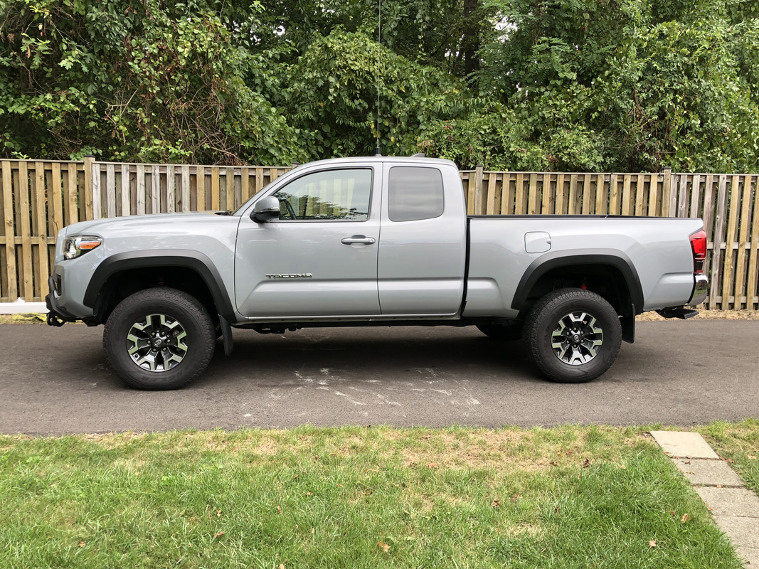

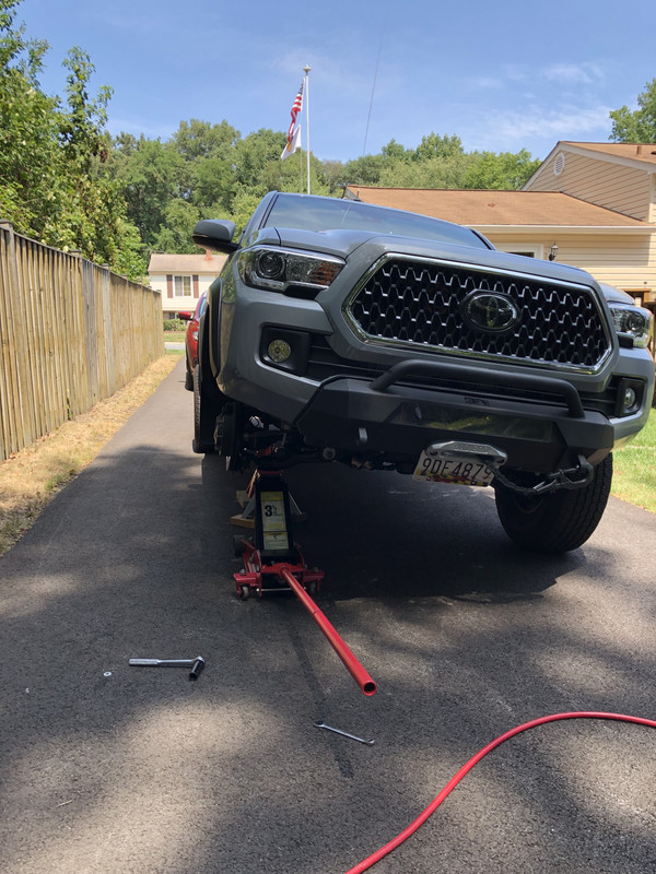

    It is not too much weight. I've installed the TRD 2" OEM lift (with 2" Torch AAL in the back). My Slimline bumper and Harbor Freight winch weigh 142 pounds. I lost maybe half an inch in the front.
    Gratuitous pic of a portion of the install.
