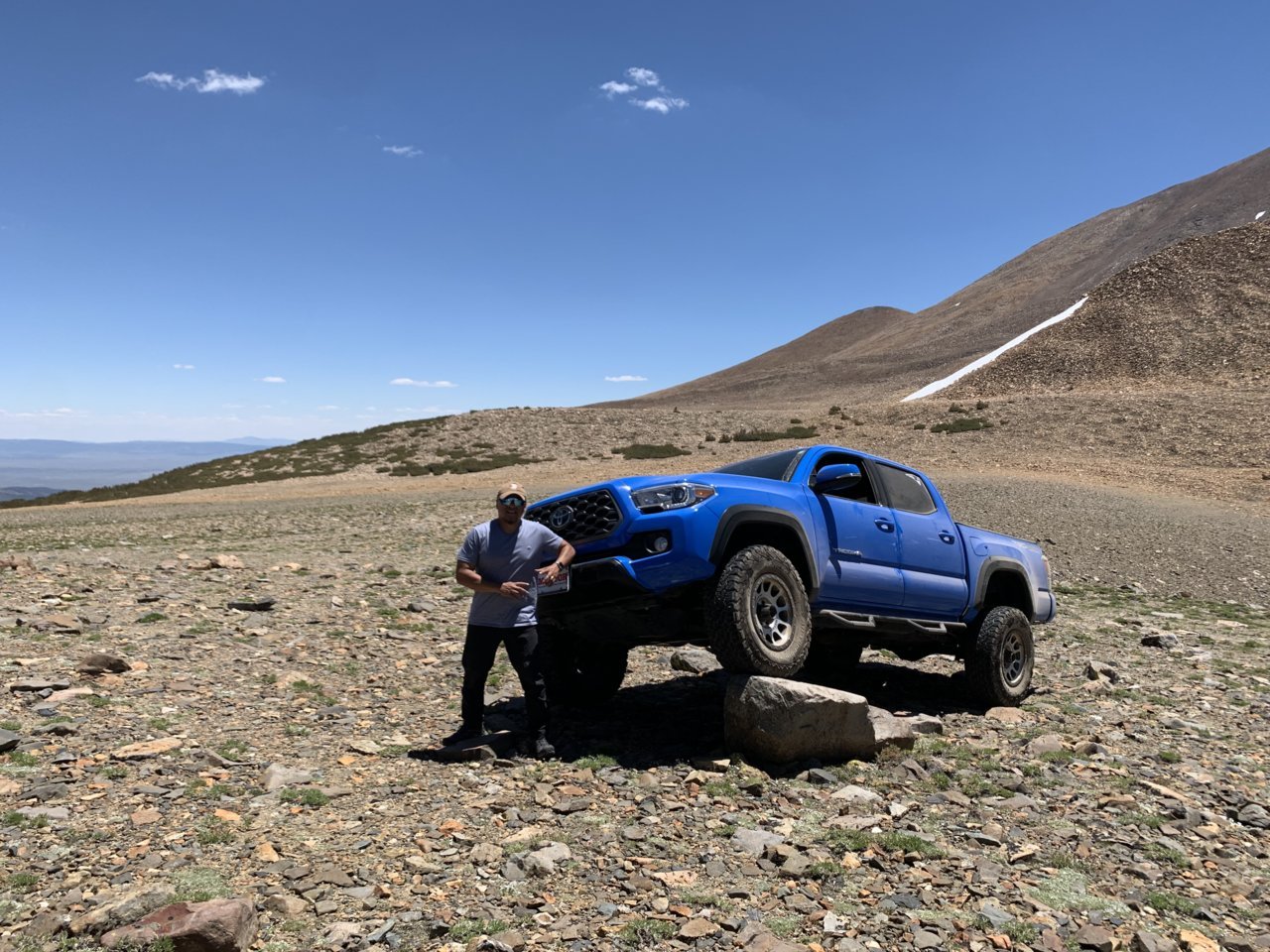

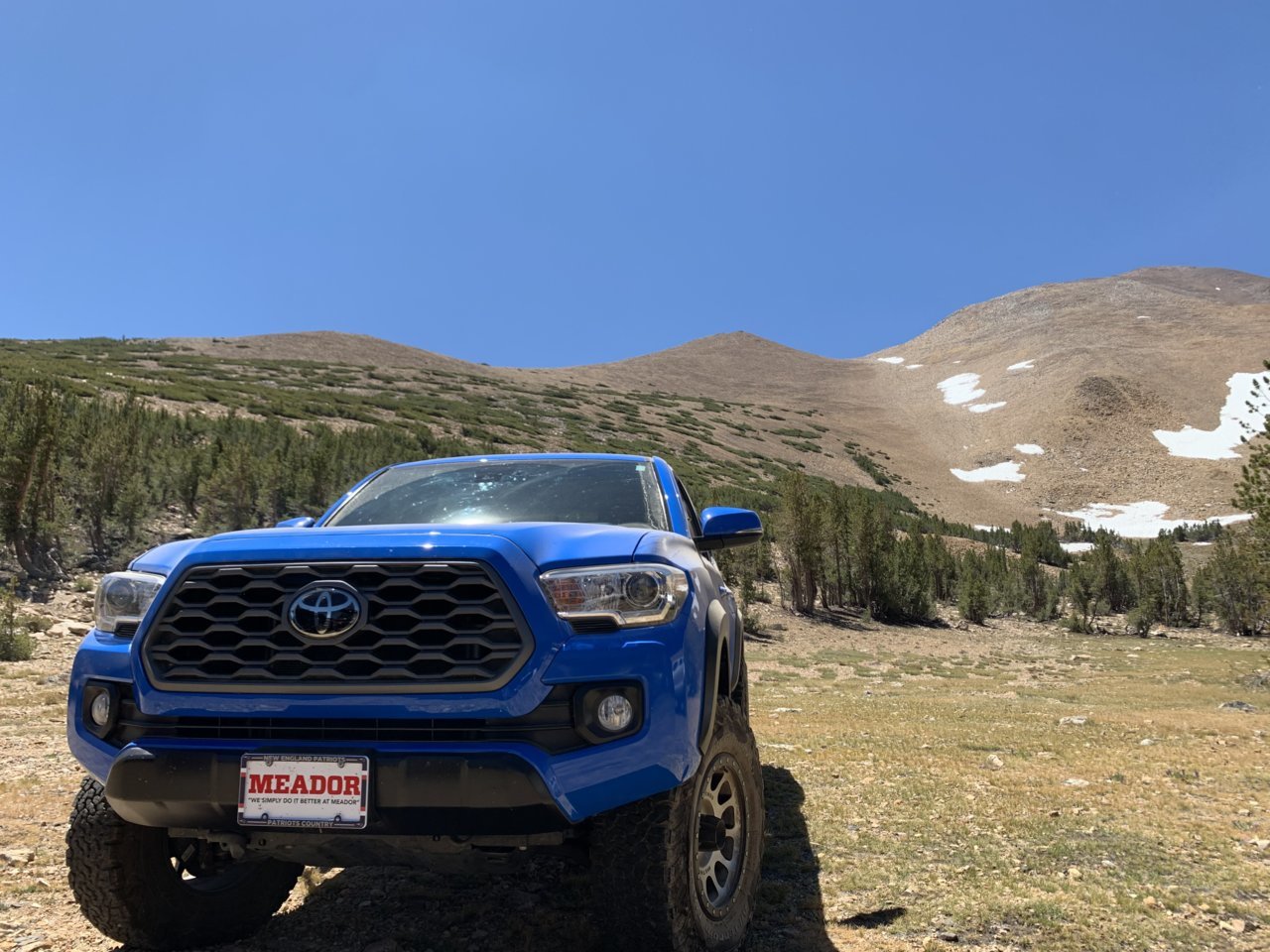

    When I got my truck from the dealer, first thing I did is go off roading! I didn’t even have my license plates delivered. I wanted to see and feel the capability of the truck as is before upgrading so I know how it compares with future suspension upgrades.
    And in the meantime I can do research either online or from fellow guys i wheel with and determine what my goals and purpose of purchasing this truck. Currently it’s my daily driver so i have to take that into consideration as well.
