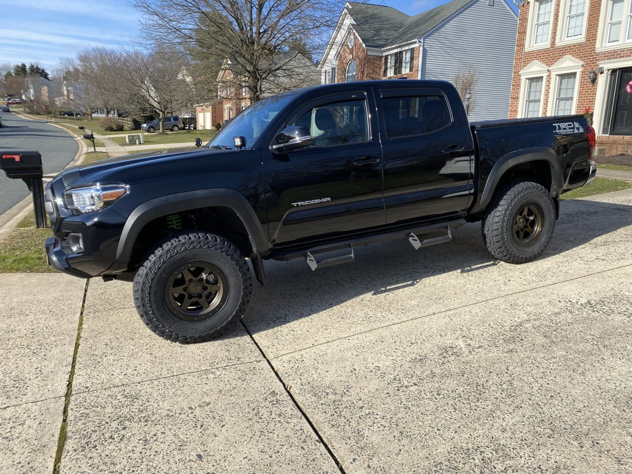

    Happy to help add to confusion! The Foam cells are adjustable the nitrogen’s are not.
    Here’s a pic of it installed with about 3” of lift on mine. The pic is with the OEM UCA and oem wheels/tires. I have BR6 wheels and 255/85/16s on now.

    That looks really good, and it one of the tire sizes that I'm looking at down the road. How do you like them? Did you have do the CMC?

    So far I like them and didn’t need to do cmc and have not gotten it to rub on anything yet. I don’t have many miles on them yet, just threw those on over the weekend.

    Thanks for the pic. They look great on there.
