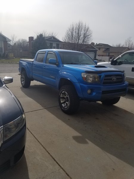

    Bilstein 5100's , Moto Metal 955's -12mm offset , Bilstein 5100's , JBA uca's , 265/70/17 BFGOODRICH A/T KO2
    I'm running 265/75r17 's With 17x9 wheels. The wheels are a-12 offset , 5100 bilsteins set at 2.5. Some people say the stock uca's hit the spring with this set up , so I did the JBA upper control arms. Great ride , and I'm very happy with the look too20170205_134728.jpg

    Thats a nice look, thats kind of what im looking for.. So if I may ask, are you saying the stock usa's hit the springs due to the 17" wheels? Would I need UCA's if I stay with a 16" wheel?
    Also, did you only use the 5100 for the front? Or is the rear lifted as well?
    Thanks for the info and thats a nice looking truck..

    It's not because of the wheel size, it's because of the angle of the uca with the lift. I've heard some people say they don't....so you may not have a problem. The rear of mine is stock with the 5100 shocks

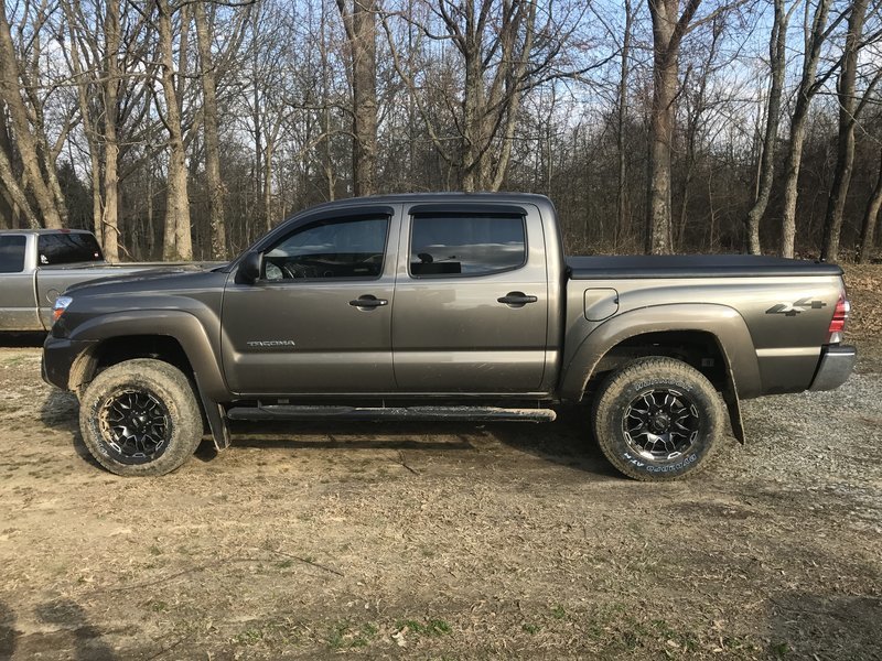

    So here is the final Tacoma look.. I stayed with factory size tires and wheels (Changed from a 7 in wheel to an 8 in wheel) 16 in wheel with 245/75 Hankook Dyno AT tires..
    Used the 5100's for the front. Thanks to all for the ideas and info..

    Looks good man, congrats !!
