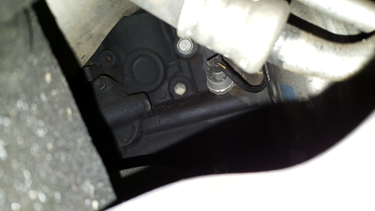

    I am probably blind (or just inexperienced). Can't find the damn drain on the block.

    If you crouch down by your front passenger wheel, get a flash light and look straight (between the top of the tire and fender) towards the block. It's a bolt with a little hose fitting under it.

    Ah, sorry. The 3.4s have the adapters.
