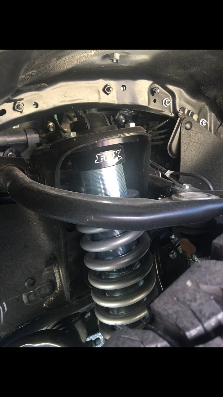

    Welcome. How much adjusting did you do to your Foxes to fit the tires?

    Looks like you still have factory upper control arms. Extended travel and factory don't go together well.

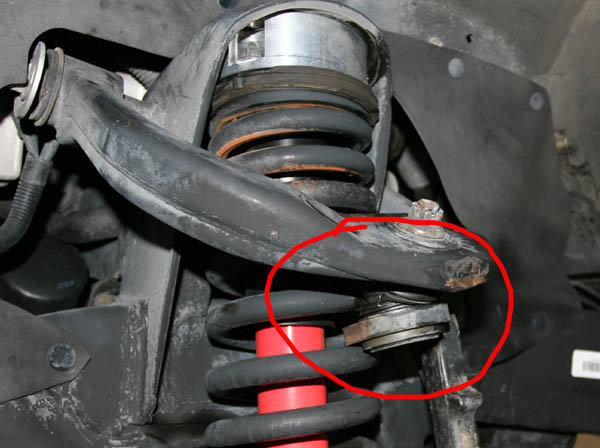

    Could you explain what an aftermarket UCA does to allow for extended travel? Does it just sit higher?

    Wider. So at when the shock is at full droop and the UCA is point down, it does not contact the shocks/coils. attachment_f5b27627e5ac261951271cf2bde12302a6d1205e.jpg
