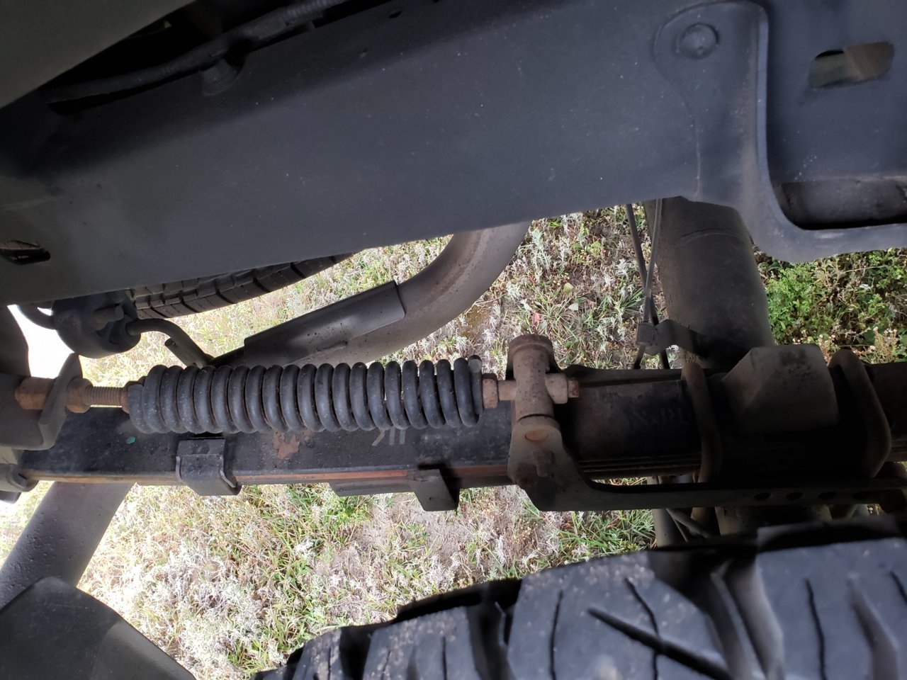

    Hola amigos,
    A quick introduction, I've been into cars my entire life, and only know cars. I've never had any interest in trucks or learning about them, but a shift in my life is leading me to want more adventures and something practical for Canadian winters. I've been looking to get a Tacoma. It's the only truck I've ever looked twice at.
    The truck in question is a used 2017 TRD Sport. It looks really well taken care of, I've noticed oil in some of the door jams from undercoating, has the optional Rigid fog lights, has the off road front end (no air dam) with a TRD skid plate, and has BF K02s.
    My question is what the hell is this rear spring thing on the back suspension? I also noticed a leaf was added and I tried looking for a kit based on markings but no luck. If you recognize it let me know.

    It’s to eliminate axle wrap when accelerating hard. Don’t know if it’s stock but I doubt it.

    Axle wrap. Not stock. If your having issues custom order springs and you will be alot happier

    Welcome to TW. @Irish Lion gave the answer. As the brand name implies, it's a pavement-friendly system. The main drawback is it limits rear suspension travel and articulation off road. If you ever get upgraded leaf packs from Icon, OME, Wheelers, etc. for lift and/or extra weight capacity, this anti-wrap system may become redundant.

    There is a thread about these on here. They all pretty much seem happy with the addition. I wonder if it helps to eliminate one of the multitude of variables that leads to brake vibrations.

    I've got them on my Taco and they work great. They are adjustable too. Plus If you don't like them they are stupid easy to remove.

    It may look hack but they actually work and serve of few different functions all in one....towing, axle wrap, traction bar, etc.

    You are correct. I purchased the RMAS system on a suggestion from another TW member. I am quite happy with the system because it has really helped with pulling my pop-up camper without effecting everyday driving when the truck is empty. I think they will work fine out 4x4ing except in extreme suspension travel situations.

    If you don't tow and do offroad think about removing it. Can't imaging that being great for articulation.
