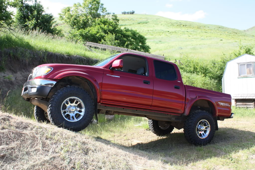

    2012 Sport MGM
    3'' Tuff Counrty Lift, Moromoto Mini H1 Projectors 5000K 35W, BHLM, 30'' LED Light Bar, Black TOYOTA Emblem, Excelon Touch Screen Deck, Hertz Speakers,Excelon AMP, 2 10'' JL Audio Subs, Wet Okle seat covers, Weather Tech Floor Mats.
    285/75/16 3'' lift blocks in the back and bilstein 5100s and Eibach coils no rubbing...
