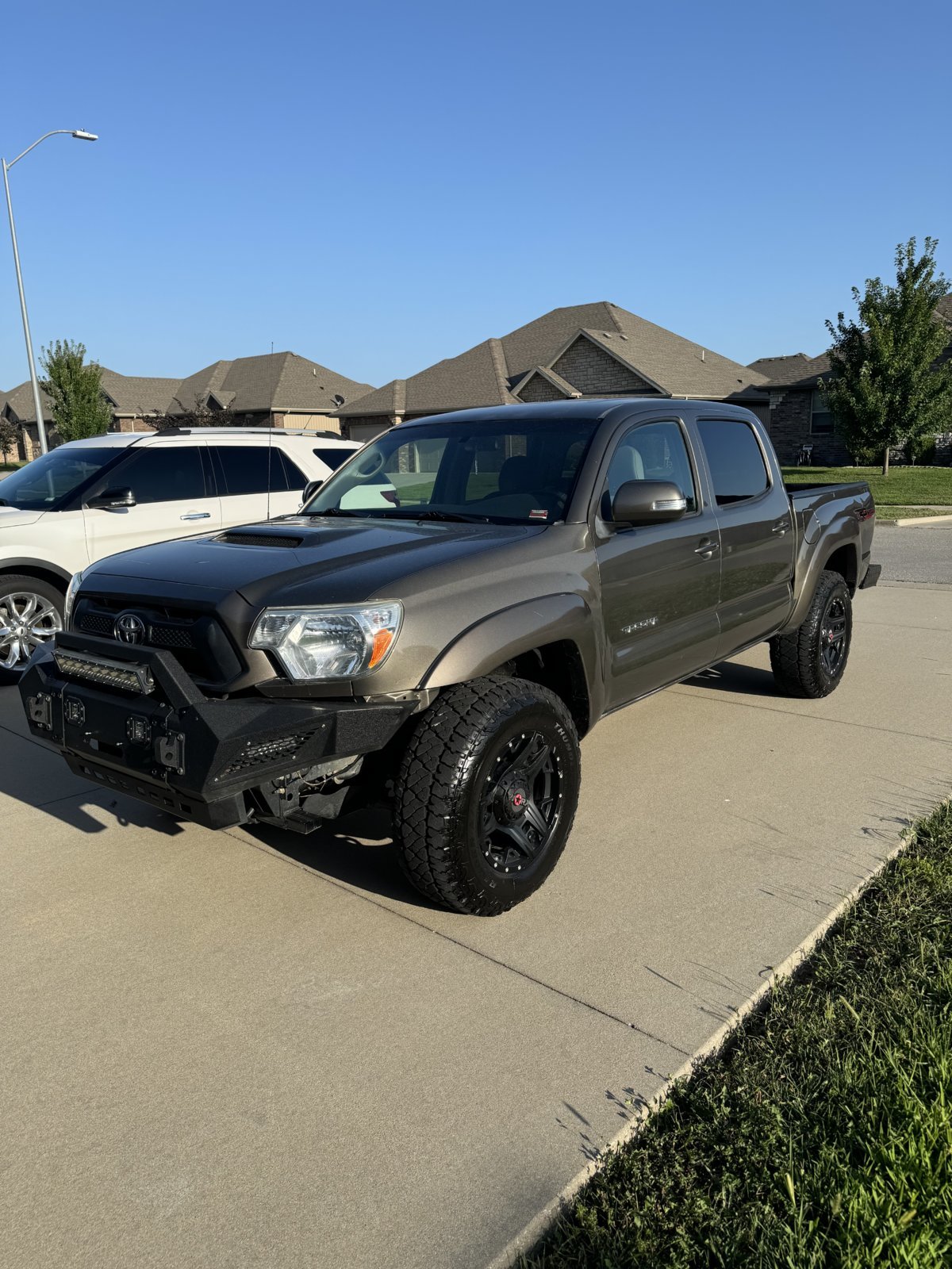

    So from what I was looking at yesterday this still needs the uni mod filter?

    My 07 engine and trans has been solid. Other little things not. Here are some tips not covered above. Nice looking Taco, BTW.

    Hard to tell from the photo but it doesn't look to have been done. I haven't got around to mine yet either.
    Idk why someone put that K&N on there, was getting cooler air from the wheel well. K&N filters aren't the best for filtration either from what I've seen.
