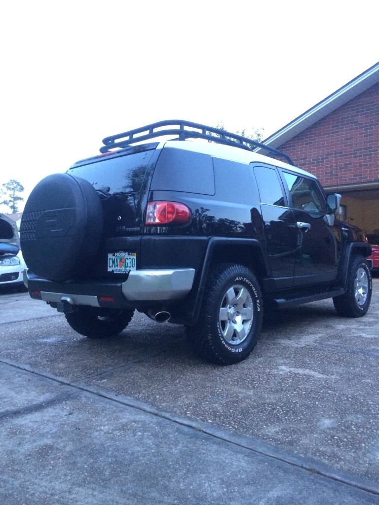

    Also, does anyone know what wheels these are? because I love them haha - who can I tell to shut up and take my money??

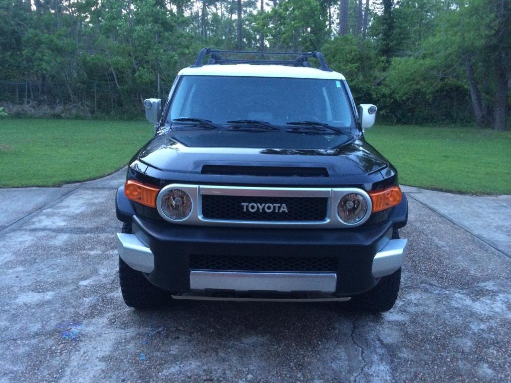

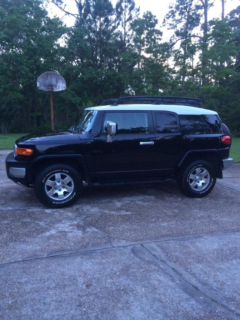

    Here is my girl though, right after I washed and waxed her. She is definitely not that clean anymore ;)

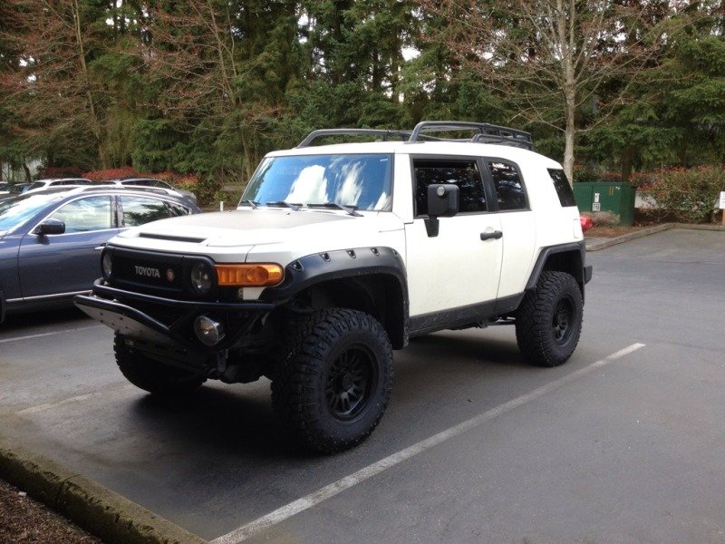

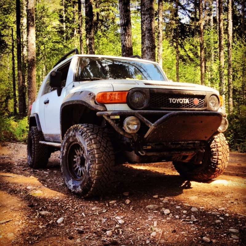

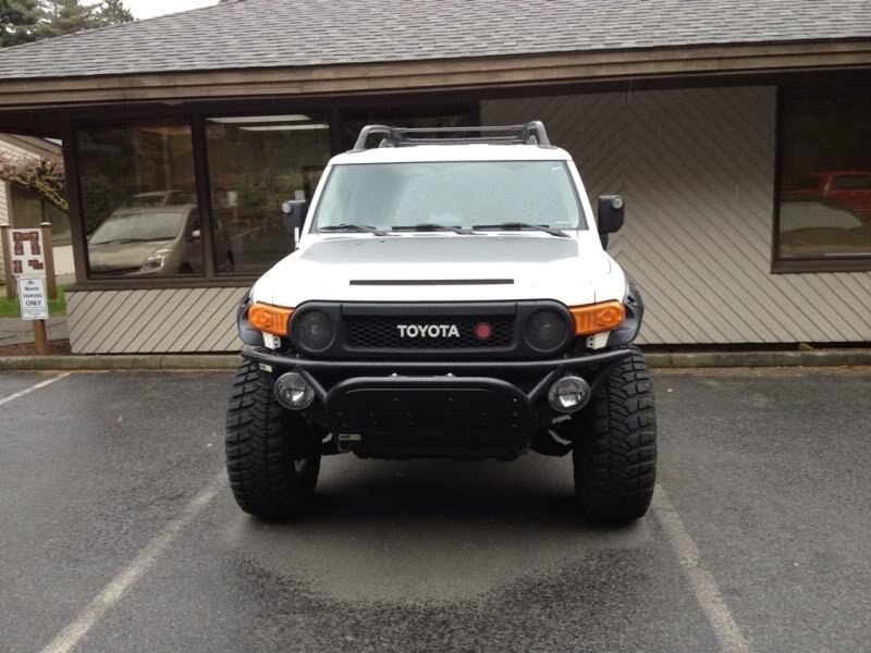

    even with 33's you will need to chop the body mount cause youll rub on reverse...

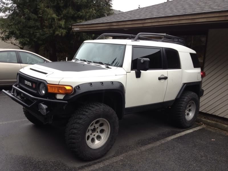

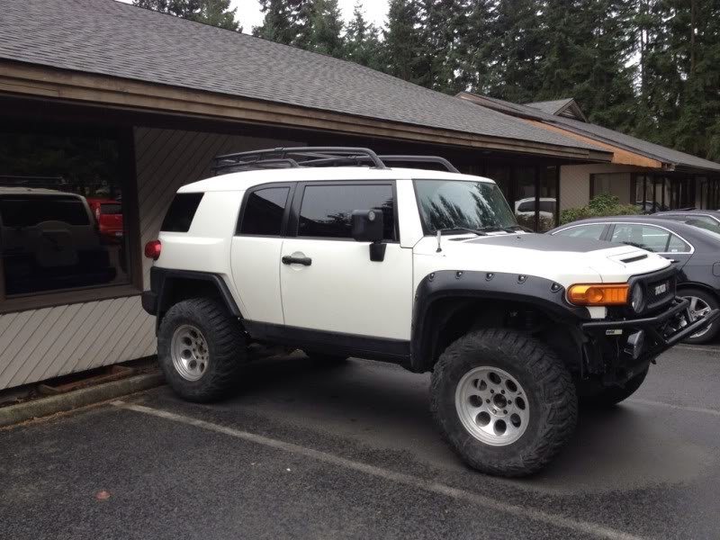

    here are some of the setups on my FJ before i sold her.
    285/75/16 duratracs
    35' Goodyear MTR kevlar
    BFG TA KO 285/70/17
