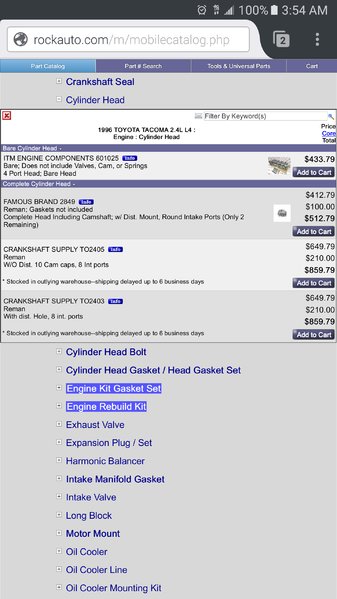

    Do you know where online I can get use or new head I think I crack mine

    Rockauto.com might have them.

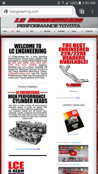

    Some of the performance shops may have them. LC engineering.com

    Rockauto has bare heads for $450.
    Or go stage 1 heads from lcengineering for $1500 or so.

    A year or two after 96, they moved to coil packs instead of distributors and there was a hole for the camshaft position sensor that used to be in the distributor. Also, there are intake manifolds with 4 ports and 8 ports, so you need to match the head to your intake manifold.
    At places you order a new head from you have to provide this information to get the right type of head.
