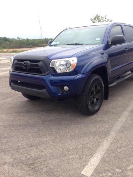

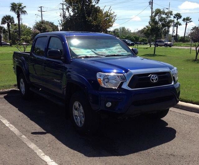

    Hi
    I have a new 2015 Tacoma PreRunner SR5 V6. I recently modded it up plasti dip matte black/gloss rims and matte black the grille.
    My question whats better a lift or a leveling kit? If so, I would like to keep stock 16in" rims right now, I think it looks nice.
    I am looking into making the truck a bit tougher looking. I'm not planning to go off-roading, just for style. I want it to be decent gas milage or at the same on the city and highway. Also, I do plan to take it the beach too, so I would like to handle sand the beach and I don't want to get stuck in the sand dunes.
    What do you recommend?:confused:
    Should I also get wheel spacers...?
    Thank you. I'm new to the truck world and still learning about Tacomas:p
    Selina
