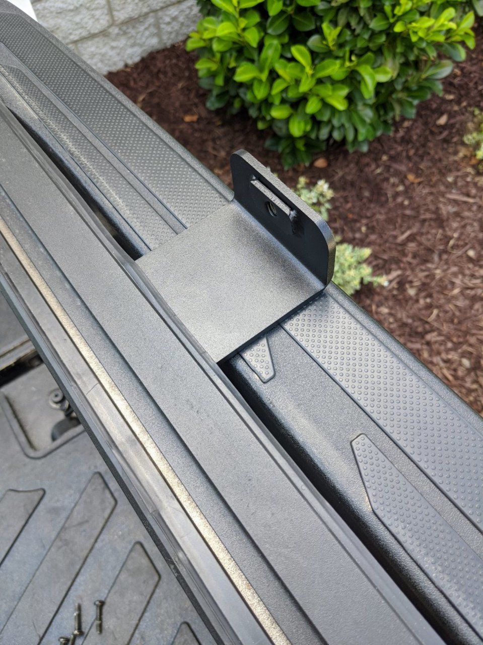

    Here's what it looked like before tightening bolts
    Those were the things hardest for me. As I mentioned before their text support was top notch, just reach out to them if you have struggles.
