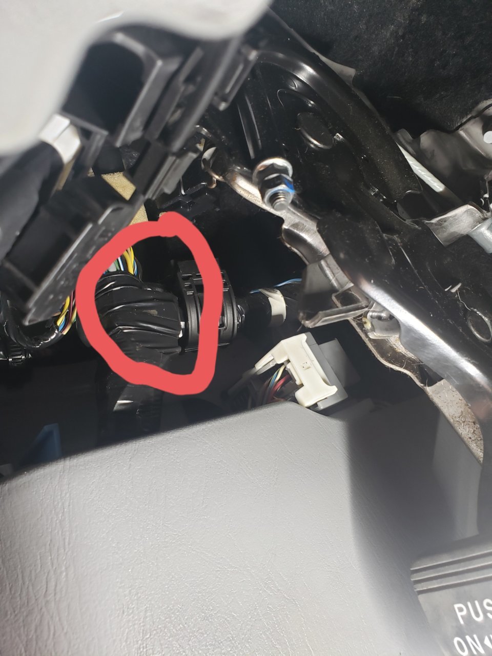

    As far as brake controllers go. On factory tow package trucks theyre pre-wired for a brake controller. The connector is tapped up with the harness above the emergency brake. The trucks shipped with a pigtail that plugs into it and you'll wire in your preferred flavor of controller. Sometimes parts stores also could keep that connector if you need it immediately/want to score it local. If you don't mind waiting etrailer.com will often sell plug and plug brake controllers for our trucks. The red circle is where it is on my 14 im fairly sure.20210409_195720.jpg
