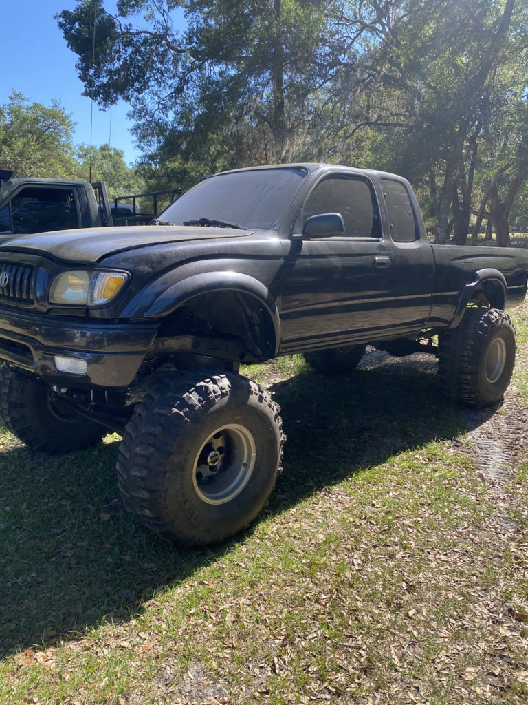

    See i this picture i have 5" BLOCKS. I'm trying to do away with the blocks

    Solid axle, makes sense now. IMO, you got 2 option to achieve your goal as stated, custom springs or extremely extend your spring mount and extended shackles. 63 alone will not get you where you want.
    why not lower the front to match the current rear ride height? I think it look better being lower vs higher

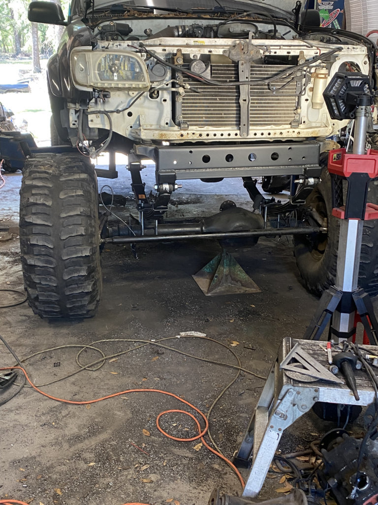

    So basically I took two trucks and made 1. I had and 04 with a 2.7 and blew it up. Then I bought a 03 and swap the straight axle over and went from there.
